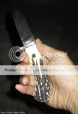

First there is a very good reason why the classic Loveless drop-point hunter is so popular and highly regarded - it is a comfortable knife that fits the hand well - there are probably many people who would back that up with $$$Ks (thousands of dollars).
I can't, but here's something that's not a million miles away -

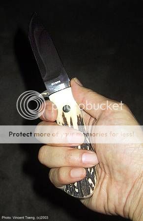

Bill "Gordon" DeFreest stag handle "Loveless" drop point, by way of George Herron -
Note: these photos - I gripped the knife as if I was about to cut - took that photo, then opened my handle to show where the handle is positioned.
A very important point for me is where and how the butt of the handle presses against my palm heel - this is a very important safety consideration for me - especially when pushing hard with the point. If the butt of the handle is pressing against the my palm - there is virtually NO danger of my hand slipping onto the blade - guard or no guard.
As one can see the butt of the handle here rests/fits nicely against the heel of my palm. The handle is comfortable there and the knife balances well the way I hold it.

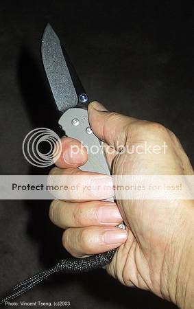

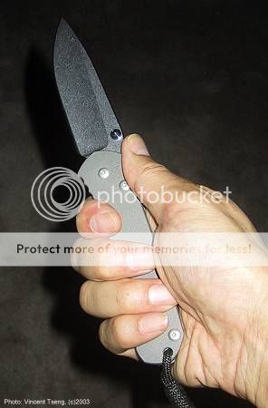

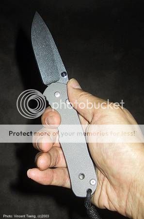

The large Chris Reeve Sebenza -
The Sebenza is one of my all time favorite folders - it fits my hand quite well -
BUT one can see the butt is not quite as conmfortable against my palm heel because of the the more angular shape - it is shaped - but is still a bit too angular for me. The straight back of the handle also is not ideal. Nevertheless this is still one of my favorite knives - just because I like it.

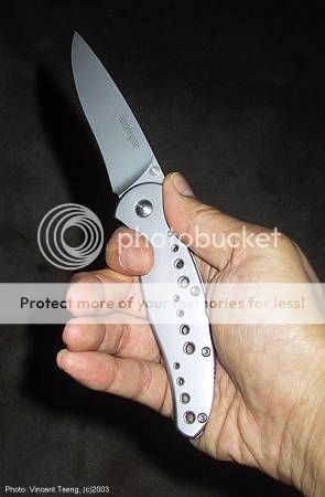

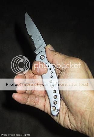

Kershaw Vapor II (~$25)
The Vapor II has got to be some kind of all time bargain - a quality frame-lock - and as one can see from the photos fits my hand real well. Look at the way the butt is curved to fit the heel of my palm, and the curved back just fits better. The handle is a bit thin a few millimeters more would make it ideal - but at ~$25 I'm not complaining, too much.

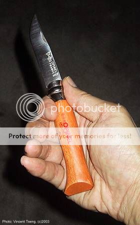

Bargain? How's $6.70?
Opinel #8
The Opinel #8 is the all time bargain - quality at an almost "disposable" price. Its convex ground blade cuts like crazy, and it's easy to maintain by simple stropping (even cardboard will do).
Having lavished praise on the Opinel #8 - its handle is just so-so - not UNcomfortable - but neither can it be called comfortable either - it's just OK. Feels to me like holding a broom handle - OK it is slightly better....
The butt digs into the palm heel - to be fair there is some bevelling so at least there isn't a sharp corner - but it's not exactly comfortable either. The round shape is utilitarian - but not particularly ergonomic - it's not uncomfortable - but I've already said that......
But at $6.70 - I am more than willing to overlook this as I said it isn't uncomfortable and I can more than live with it.

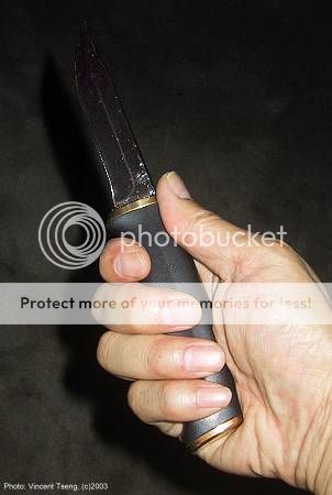

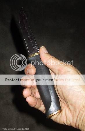

Fiskars Puukko -
Puukkos have fairly simple but well contoured handles - this Fiskars Puukko fits quite nicely, the butt isn't ideal pressed agaist the palm heel - but it is more than acceptable.
The handle butt against the palm heel is essential for my use and safety - I wouldn't even like to think what's it's like to have my hand slip onto the very sharp puukko blade. The contours of the handle are really nice fitting my hold well.
Note the index finger "cutout" which the frame-lock folders have in the form of the lock release cut out - that's another reason why I like frame-locks so much as any hard use tends to tighten the lock more, rather than the possible release on liner-locks.......

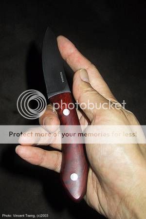

Hendrix #11 Semi-Skinner -
This Hendrix #11 semi-skinner is really comfortable for me - because of the way I can palm the butt of the handle - that gives me bags of confidence in using the knife.

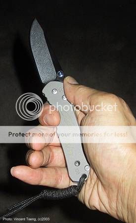

Chris Reeve small Sebenza
Same problem as the large, the butt is a bit too angular to be comfortable pressed against my palm - the handle back is also straight and doesn't fit as nicely - when one compares it against.....

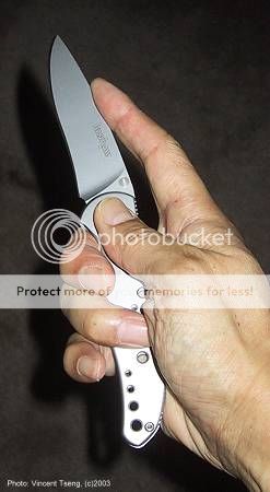

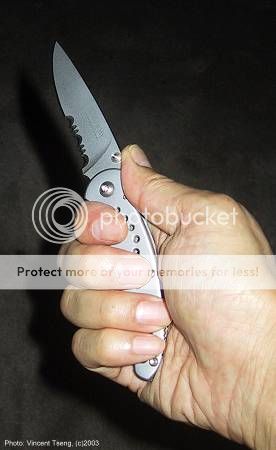

Kershaw Vapor -
Look at how well the knife seems to fit my hand - that's why I was so enthusiastic about the Vapor for such a long time, and wished for a Speed-Safe assisted opening version of it...

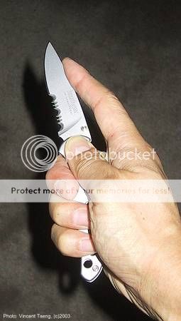

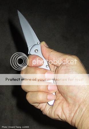

Kershaw Leek -
well... perhaps not quite as form fitting as the Vapor - but still PDG (Pretty D@mned Good) - another reason why I am enthusiastic about the Leek, and why it's my at home EDC.......

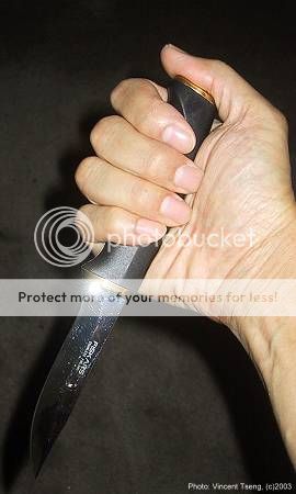

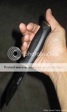

But may I suggest a different, but to me much, much safer hold for the ice-pick/stabbing type hold?
Place thumb over butt of handle - this way there is virtually no danger of the hand ever slipping on to the blade:
As one can see the Puukko (and other Scandinavian style) knives seem to be designed to accomodate this hold. The handle fits well with the thumb over the butt/pommel.
However with the blade edge facing the other way the hold is not quite as ergonomic
(sorry about the use of this word - but can anyone suggest another word that's as meaningful?)

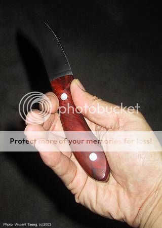

Larger vs. smaller handles:
I think in this case of the choked up hold the smaller handle does fit better.
As for palming the handles - some years ago when I got interested in Japanese tantos - I noticed the very short handles in relation with the blade, and the ones without guards looked way too dangerous to use in a typical trusting action. So I wondered if the Japanese had very small hands (unlikely) and why these tantos were so highly regarded when they looked so dangerous to the user for their typical application......
That is until I figured out that the butt of the tanto was pressed against the palm - therefore one could literally lean into the trust with one's full body weight without any danger of the hand slipping on to the blade.
Ice-pick/stabbing action was easier to figure out that one simply placed one's thumb over the butt/pommel to ensure safety.
Now that you mention it these are the other holds I always try out when handling any knife:
Choked-up hold:
Reverse/upside down hold:
Ice-pick/stab hold
on the stab hold when the blade edge faces the other way - this handle doesn't feel quite as comfortable.

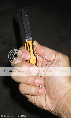

The SAK gave me a surprise - I was prepared to find in comparison that my EDC SAK was going to be "functional" as opposed to "ergonomic" - but was surpised by how comfortable it felt.
The keyring - I thought was going to dig into my palm in my hold - and could I have ignored it for all these years?
- it did not - because it was "protected" by the corkscrew/jeweller's screwdriver protrusion.
This is my EDC customized Victorinox Scientist -
notice how the corkscrew/jeweller's screwdriver buffers against the keyring from digging into my palm.
I thought the customized handles might have something to do with the comfort - it did a little - as it is more rounded profile as opposed to flat with rounded corners -

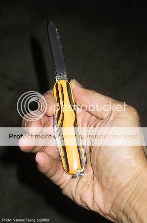

this is the standard Victorinox Scientist -
On keyringed but corkscrew-less models (like many of the Alox handled keyring models) the keyring knub will press against the palm - it is not particularly comfortable - but then it is not very UNcomfortable - just not particulay "ergonomic".
# of layers/backspings - about 2 layers/backsprings seems to feel most comfortable - a qualification - my EDC Vic Scientist has one over-sized backspring/layer. 3 standard backsprings/layers feels OK but just a bit thick in the hand. Having fussed over that, I've successfully used the Champion and SwissChamp models for sawing through thick rusted bolts without too much complaint about uncomfortbale handle holds - and these are thick - I think I can "tolerate" a handle that I can just wrap my hand completely around - so the SwissChamp is probably about max.
