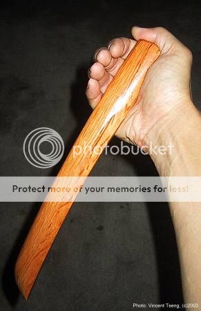

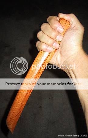

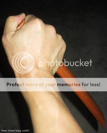

OK... having said that I wanted to see if I was deluding myself -
and tried a "safe" experiment - I used a wooden Tanto - so there was no danger of cutting myself if my hand should slip - and tried stabbing as hard as I could:
Wooden Tanto -
View from opposite side:
I "stabbed" a folded towel placed on carpetted solid floor in my basement. Started fairly "conservatively", then gained more confidence and stabbed with "all my might" - about as hard as I (sensibly) could - it jarred my arm and my thumb first joint hurt somewhat - but my thumb certainly did not give way.
Obviously there may have been some "self-preservation" subconsciously that may have limited the "all my might" - but it was pretty hard -
and certainly I would say way above 23lb force -
remember it isn't merely the thumb tip/pad that is used but more centered around the thumb joint (see photos).
To stab even harder I used two hands - but with only one thumb over the pommel - it felt as if I was stabbing harder - again no problem in my thumb giving way.
