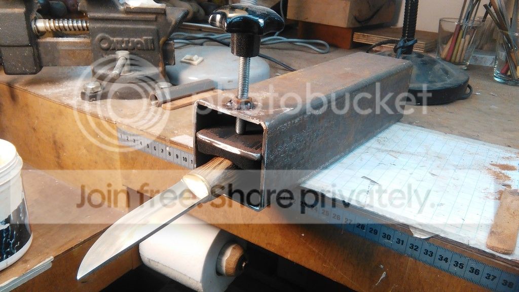

Besides my Wilton, post vise, and rotating blade vise, I am finding that I need a way to hold a nearly finished knife by its handle. Picture a big bowie handle, or a stag handle here.
What have you pros found to be the best way to do so, giving secure access to the blade and not damaging the handle?

When I have had to do what you are describing, I wrapped the handle in a piece of 1/4" thick dense foam pad and then clamped in a vise between two pieces of PCV pipe sawn in half.
Other times, I have used my handle clamping jig to hold the knife by the point and butt.
This is what I made
The rubber is used to make shoes (50 schore) and ground concave. But other rubber will do.
I clamp knives like this to sharpen them and move diafolds to sharpen

My inexperience often leads me to a recovery process. Hence the need to hold the blade by the handle!
This is what I made

If I were more of an engeneer I'd build my jig with the moving plate attached to the screw going up and down (with a ball hinge or so)
