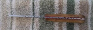

I'm in the process of shaping the curly maple scales for my first knife, and looking through a lot of the pictures in posts here, I see what people refer to as "liners" between the scales and the steel. What purpose do they serve, if any? Are they merely asthetic, and if they do serve a purpose, what materials are they made from? Thanks for all the help, Mark.
Some people believe that vulcanized liners provide some shock protection to the scales. I don't know if that is true or not but they do look good :)
I've used them as bling but they also sturdy up a frame once the cavity is cut. I posted some pics on the custom and handmade page of a dagger with nickle silver liners that had been gold plated. A lot of guys use filework and really make their knives POP.
