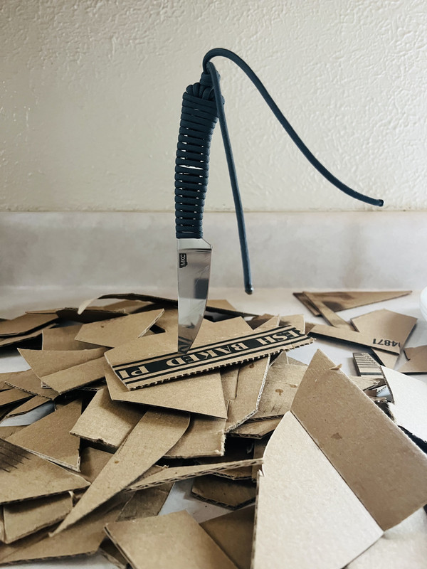

Bought a MKC speedgoat and while the handle shape is comfy I’m really hoping for some scales at some point. Rumor has it they are testing some scales for it. If they don’t release them, is there anybody online that could make some micarta scales?
