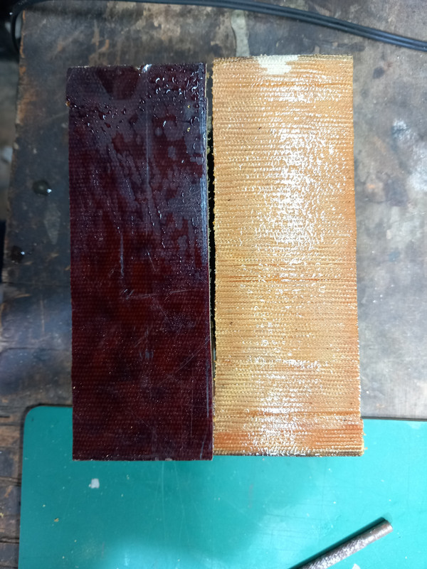

Even phenol based micarta's darken over time. That's what gives the dark-light colour effect when you contour and shape old vintage micarta.
It gets a rich colour over time that I personaly like.
I believe it is mostly UV light that causes it
Here is a quick pick of a pair of handle scales cut off a large block of old industrial phenolic "micarta"
The dark side is from the outside, the light side is freshly cut.
Shaping a handle out of scales like that gives an interesting colour change from the thicker middle to the thinner edges of the handle.
