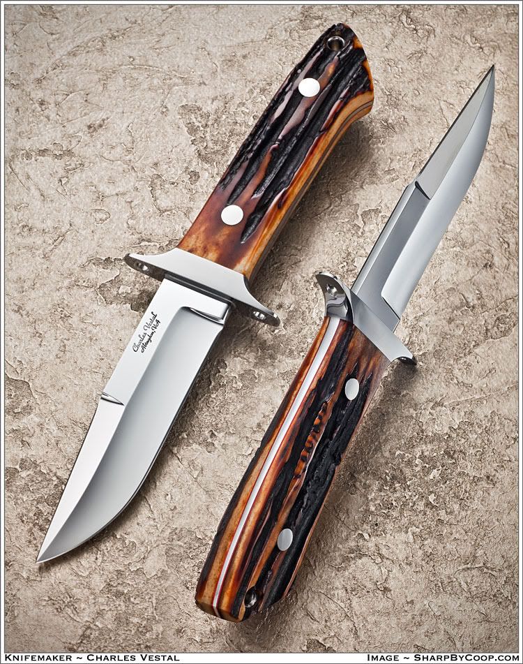

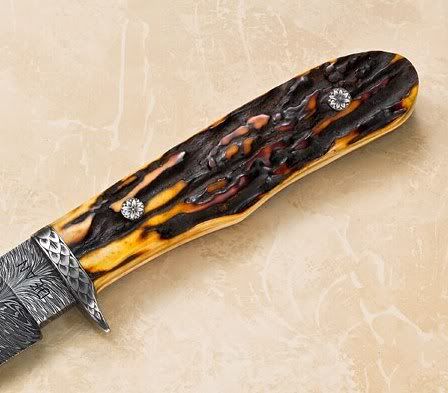

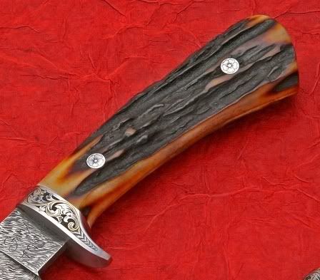

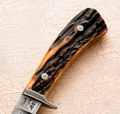

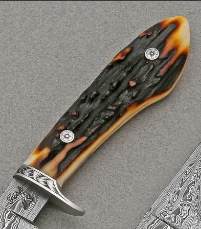

Thought I would share some examples of well executed stag handles and add a little color to this thread. Hope you don't mind Josh.
Coop, Chuck Ward and Point Seven photos:
