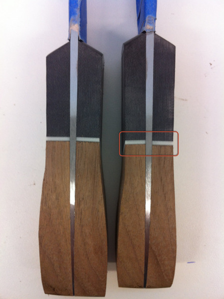

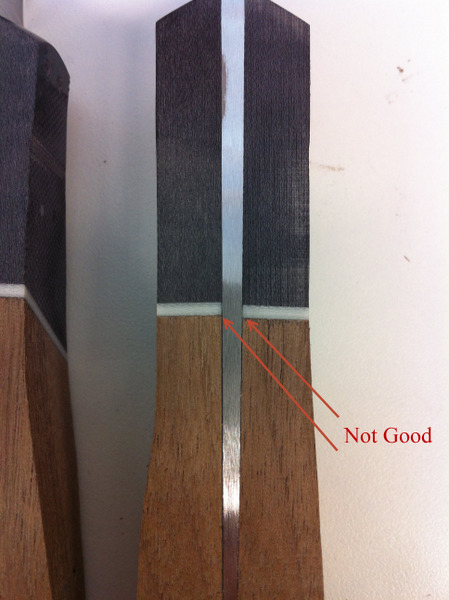

Putting together a pair of kitchen knives and got the handle scales glued up over the weekend. I started to trim down the excess material and realized my alignment is noticeably off where the different handle materials join, from one scale to the other. I'm guessing there was a little play with the 2 dummy pins installed that let the scale slide a little bit. So the big question is, what can I do about this?
I'm using West System 105 for the epoxy.
Possible options I've come up with:
1. Try to loosen the epoxy with acetone and nudge the scales a bit.
2. Try a heat gun to loosen the epoxy, nudge the scales a bit.
3. Either of those first 2 options to remove the scale entirely. Then start over w/ new scales.
4. Finish this out and give it away as a "blem"
Not my favorite options, but kinda what I figured. What's the best way to remove the scales, just option 3 with some pliers/hammer/chisel until they come off?
Then there is option 5: Give it to your Mom. She will never see mistakes in a knife made by her son. ;)
Finish them as is. It may not show as much in the round as it does in a straight line.
If that isn't suitable, the only option is to try and heat the handle up gently and remove the scales...and go back to the start.
I would finish them, as if that doesn't work, you can still start over again.

It looks like the front of the handles are not aligned. Must the the angles. The right looks higher one then the left looks higher in the other photo. Since this is the same scale maybe it would be better to remove. Or just finish and see how it goes and use it as a learning opportunity. If you get called out on it then you'll know for next time. Maybe your buyers don't have as keen an eye as you do. :)
I agree with Stacy, it should be a lot less obvious once profiled. As far as blems go, it isn't gigantic. I would think that making sure it was shown accurately in photos would suffice, it's probably on the edge of needing verbal disclosure, as long as you make sure it is not hidden from the customer in any way.

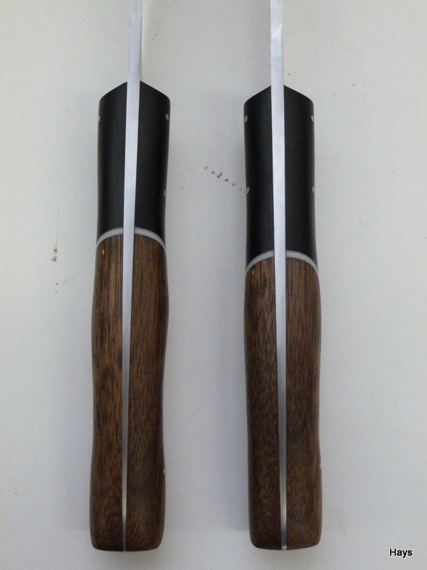

Finishing them out was the right move, thanks for the push in the right direction. The white spacers lined up pretty well once I started sanding. The pic makes the handles look a little a bit wonky (non-symmetrical), maybe that's just the camera angle, I'll have to check them tonight to make sure but at least the white spacers are good.

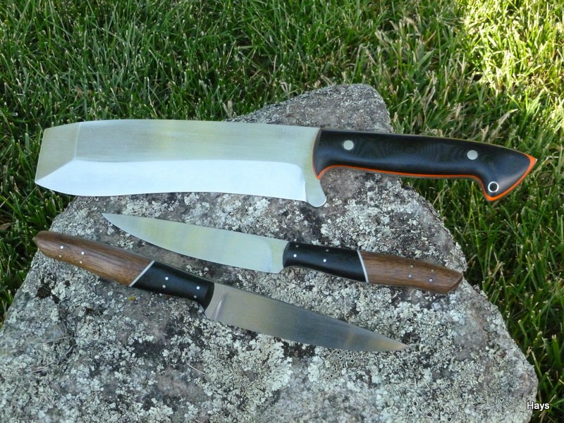

And the finished product (along w/ a prototype chisel chopper thingy).
Good job pushing through. They look great!
