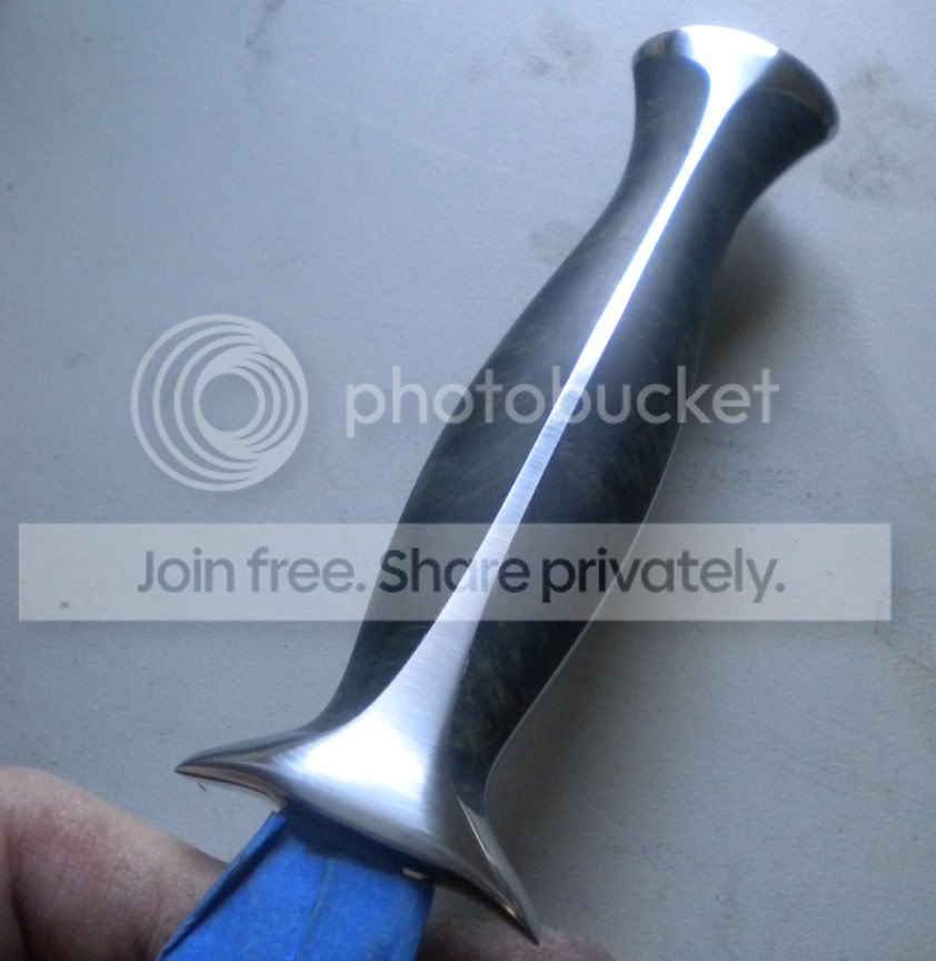

^ that's pretty much what I do here:
a.jpg~original
It sounds complicated, but it's actually easier than grinding a bunch of pins flush.
