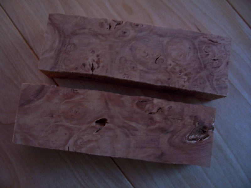

I just cut up a block of cherry burl I have had in my shop for a couple of years. (Should be dry now :)) It is beautiful stuff but you can see that it has a lot of bark pockets and holes. I intend to have this stabilized but wonder how to deal with the gaps and voids. Any suggestions?
Stabilizing will fill some of the gaps but not all of em. You need to get some thick super glue, most knife suppliers sell it. It works good for gap filling.
Cherry is extremely brittle after most of the moisture has been driven from it.
The blocks of wood, shown, will not have a great deal of strength by themselves and will tend to come apart when you machine them. The stabilizing process will add some strength, but of course that is not its purpose and the added strength, will be minimal.
By the looks of the voids, on the surface, I would think the inside will have a continuation of these. If money is not the issue, it may be worth a try. But if the knife you are building is your focus, you may want to look elsewhere for a more suitable handle material.
Good luck, Fred
You might be right Fred. I hate to sink a lot of money into them (40 blocks) and have them look "repaired" when the knife is done. Cocobolo rules!

I stabilize a lot of wood like you show. I have done Buckeye burl, redwood burl, and Carpathian elm. All have voids bark inclusions. Have them stabilized by WSSI. It will be much stronger.Just grind the scales to rough dimension and fill with Thick super glue.Do a couple of fills, then do one more with the slow set super glue and fine wood dust from the earlier sanding. The paste will fill the holes nicely. Sand, and then add thin super glue. A couple of more treatments with the thin will make all these voids into nice knots. Sand to final shape, adding glue as needed. The end result is often stunning. Sometimes you can't even tell.

Here is a photo of a handle in redwood burl that looked almost exactly like your cherry burl. After stabilizing it had voids and crack lines all over it. I sliced it into scales and filled the cracks with CA, sanded the handle after assembly, and redid the CA before final sanding and buffing. The finish is 400 grit and a quick buff on the polishing wheel,using no scratch white. I just came in from the shop after doing this one today.

Thanks for the picture Stacy. I might just give this cherry a try.
