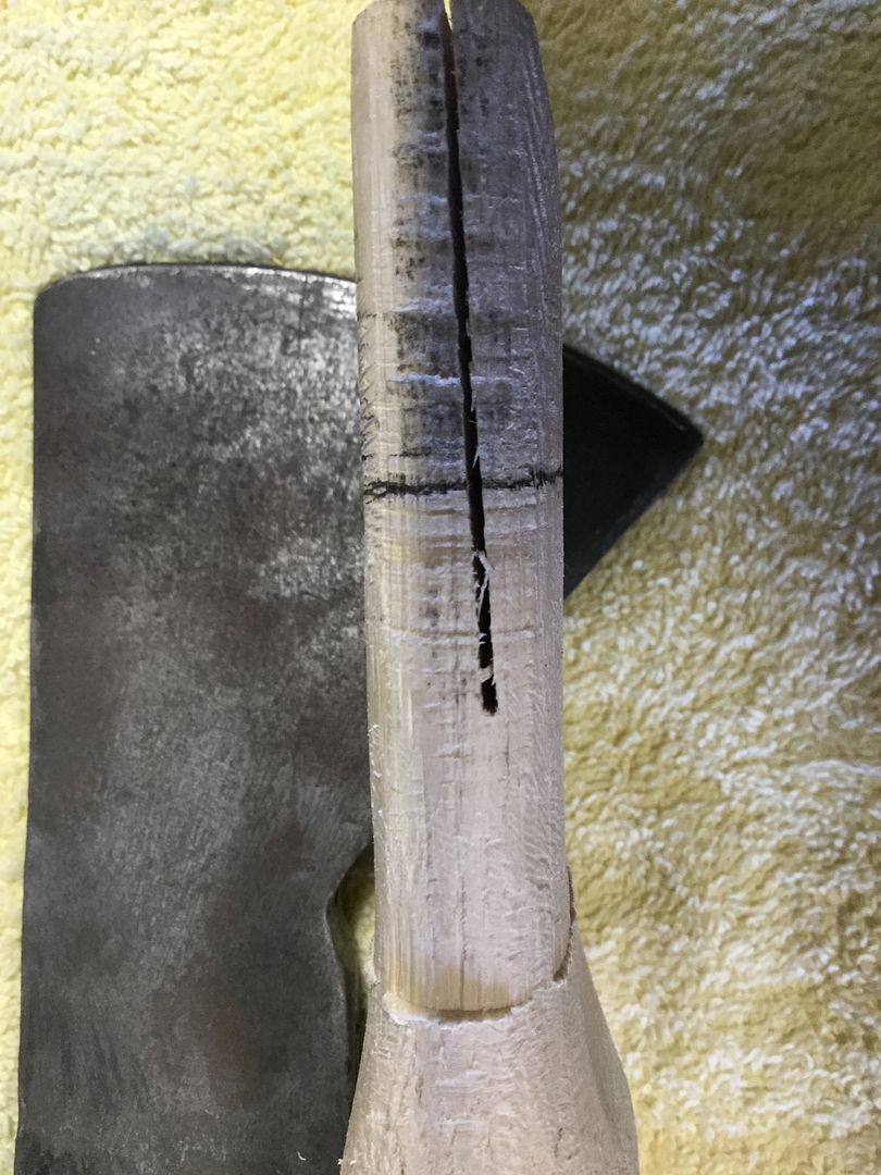

Hi Guys,
Here again trying to hang a HB Axe, so far this is where I am at, first question, should I go down little bit more?
http://s1229.photobucket.com/user/cachoron/media/image.jpeg.html]
[/URL]
Thahks, if that is the case, should I make the cut deeper? The top of axe will be at the black line
Once I have the head in final position, I use a pencil and mark the top and bottom of the head, remove it and then use the lines as reference points for cutting the kerf. Somewhere between 2/3-3/4 is good. If you double your distance from the top line you will be all set.
I'd judge how far down to go based on whether or not you like the overall length and/or whether the head is good and tight. Looks like you've got the good and tight part. I agree on the depth of the kerf, and I would thin the shoulder all around to about the width of the head itself give or take.
You're far enough down onto the haft but the hang would look better if you rasped down the shoulder of the haft till it's just larger than the bottom of the eye, +1/8"-1/4" on each side.
Looks like the handle itself really should be resealed a bit before you lower it but that's a personal preference.
Agree with the above advice but while the head is not wedged I would slim down that shoulder, a lot. It will be more comfortable in use, and keep it from getting hung up in splitting tasks. As a general rule I perfer handles to be a bit thinner than the outer width of the eye.
I suspect (seeing as we can't see much more than a huge wood shoulder) that you have an exaggeratedly-oversize handle to begin with. Whittling the whole thing down in proportion to the head (use pictures of vintage or pretty HB hangs as a guide) will greatly benefit the end result. Many current commercial handles are made horribly 'fat'. It's nice that buyers believe they're getting a 'bigger bang for their buck' (namely excess wood) but in reality a gracefully thin handle is an absolute joy to behold and use.

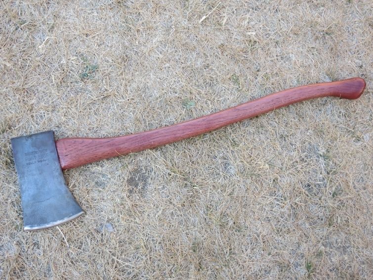

Same here. To the OP, I'd definitely take the advice of all the knowledgeable guys here and bring that shoulder down. Below is a photo of my first axe restoration I did last year with a handle I got from House. While I thinned down the haft a great deal to get it to feel really nice, I wish I would have taken away that shoulder bulge a bit more.

the wood extending above the eye in your photo can be removed by sawing it off before driving in the wood wedge making it eaiser to seat the wood wedge in the saw kerf or slot. leave this part a little proud of the axe eye , in other words don't saw the wood off even with the axe eye let it stick up about 1/4 inch.
yes, it would be good to thin the handle, at the shoulder. also probably would make a more comfortable handle and would be good practice to shape the rest of the handle to your ideal feel.
