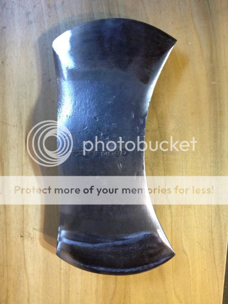

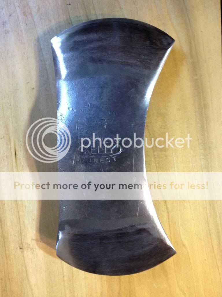

So this was my first DB hang. I chose a shorter handle, 32" I believe. The head is marked 3.5 lbs. but it had been ground pretty often and poorly before I ever got it. Then I had to true things up. I'd guess it's now closer to 3.25 lbs.

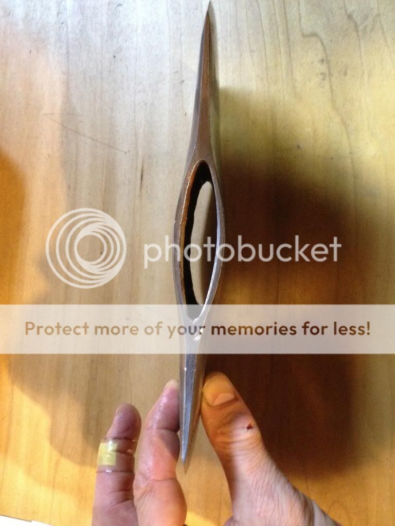

It was a bit fat in terms of edge geometry, but there was also still plenty of hardened steel available. the dark grey between the light grey body and the shiny new edges shows the depth of the hardness.
The profile was a lot better than the edges. It cleaned up pretty quickly. Bottom
And top
(Thanks halfaxe. Although the head is still 9.5 inches long, it was very fat. I would have liked to leave more of the original patina on, but it was just too fat. Had to work down a lot more than just the edge.)

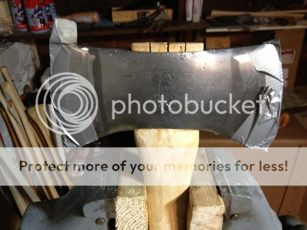

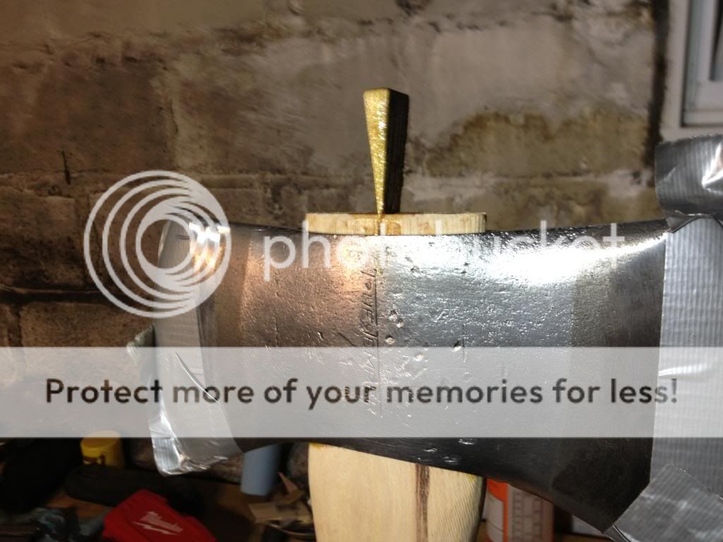

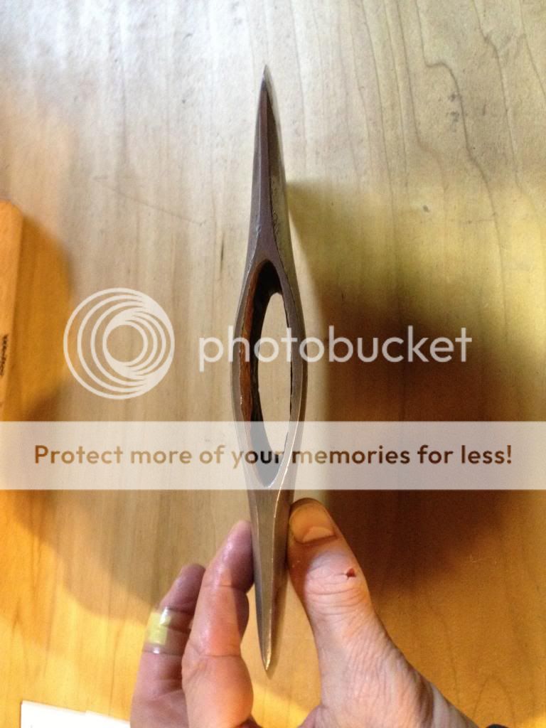

There was quite a bit of space on either side of the eye, so I decided to do another cross wedge.

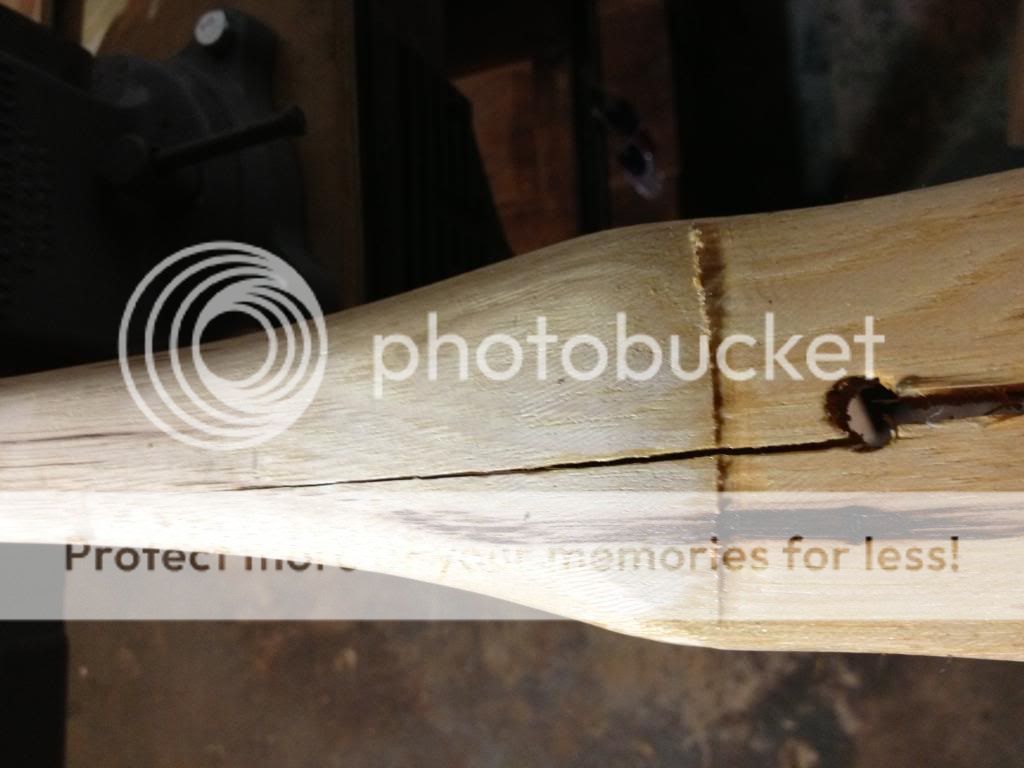

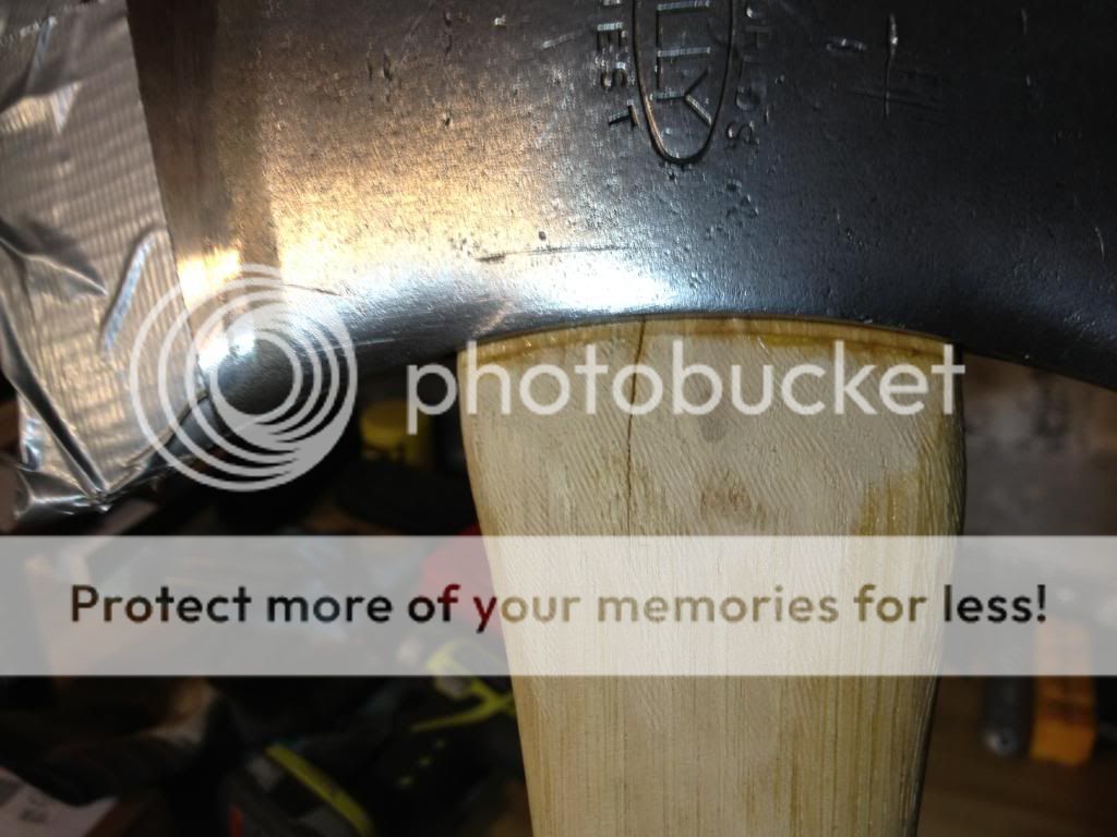

But I got a bit too greedy. Even with my oversized hole, the handle cracked pretty badly.
I was contemplating throwing it away, sawing it off and making a couple hammer handles, etc. But then I thought I would try to salvage it.

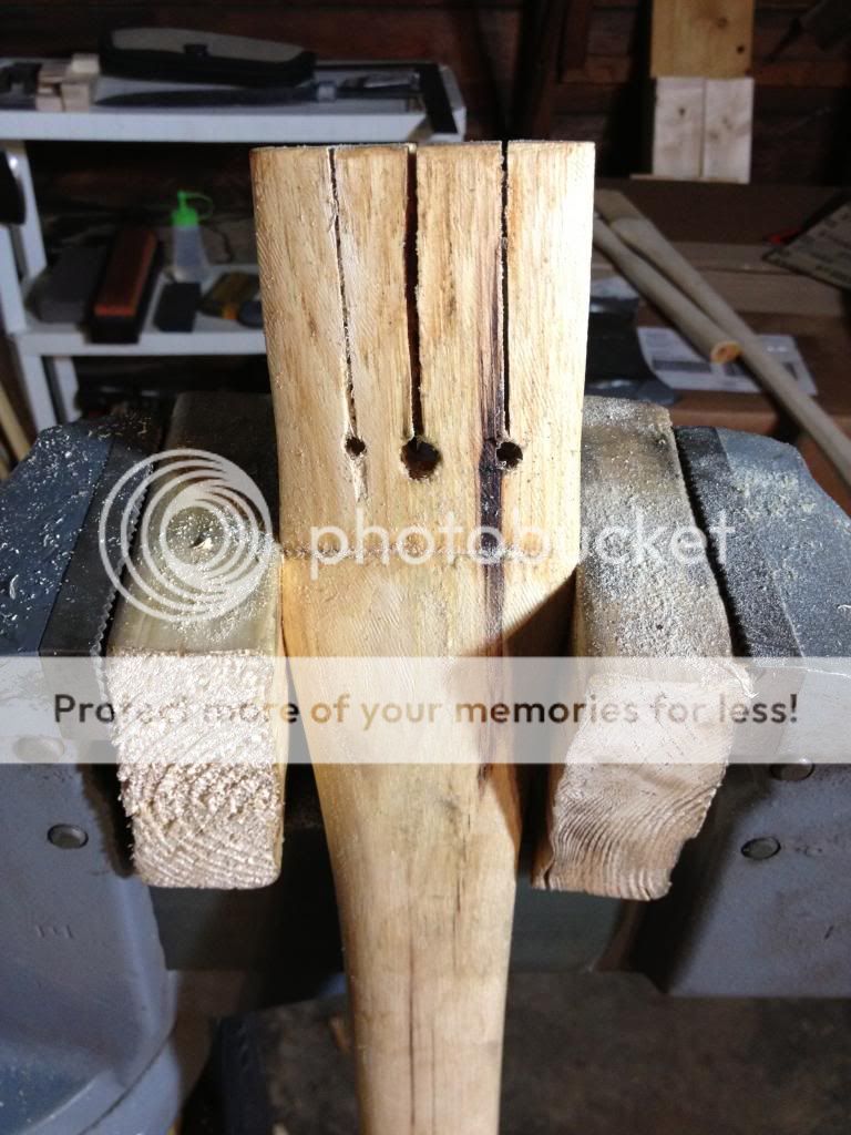

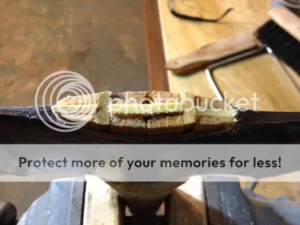

I opened up the crack as in the photo above, and filled it with Titebond wood glue then clamped it in the vise. I then cut and drilled two more kerfs for two smaller wedges. They would spread the material more evenly while also clamping the crack in the middle.
Here is the head re-seated, which I also hope puts pressure in the right direction on the repaired crack.

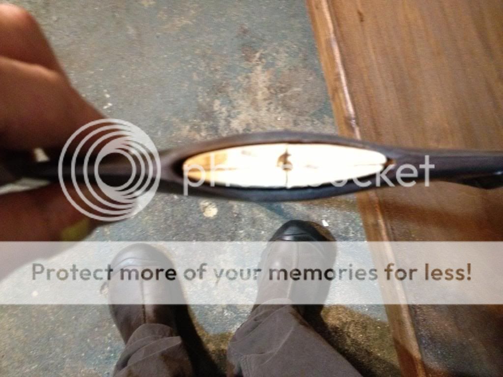

Here it is from the top, complete with ugly hole from drilling out the first wedge.

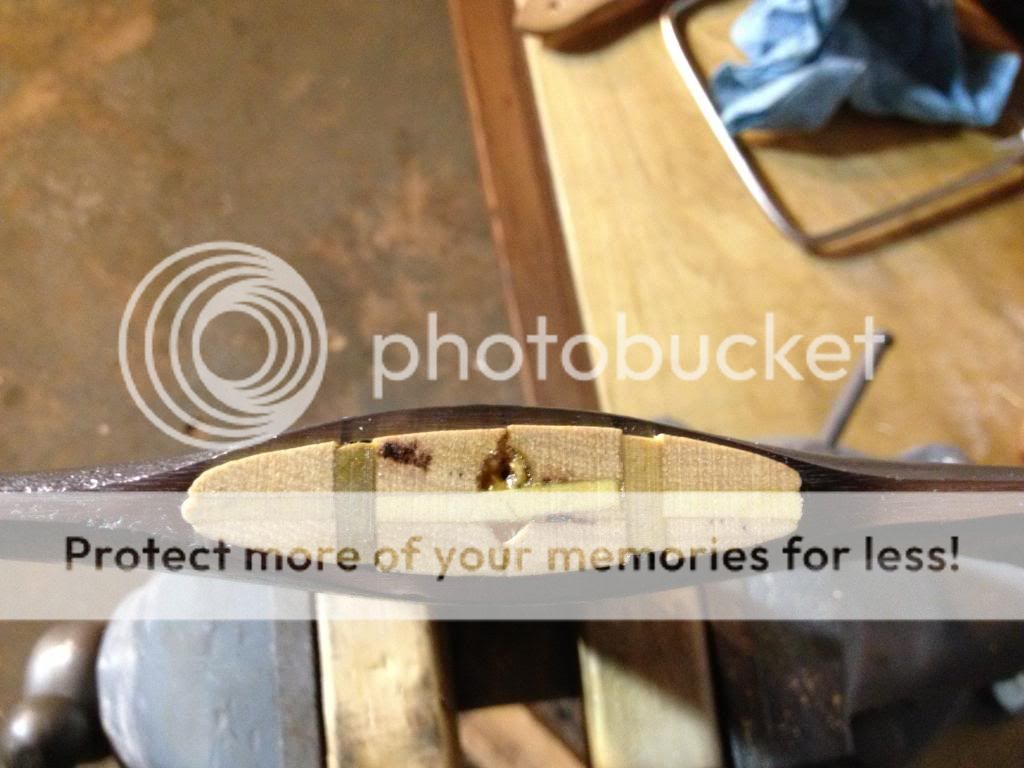

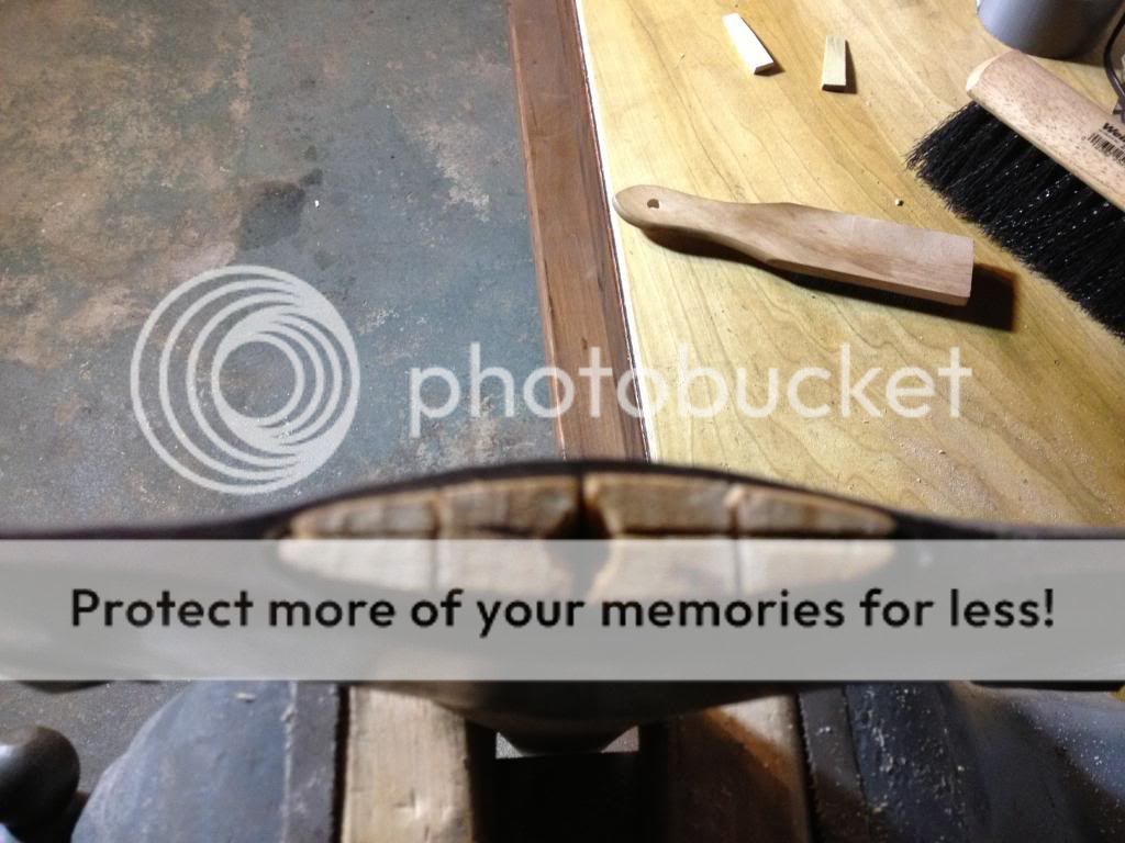

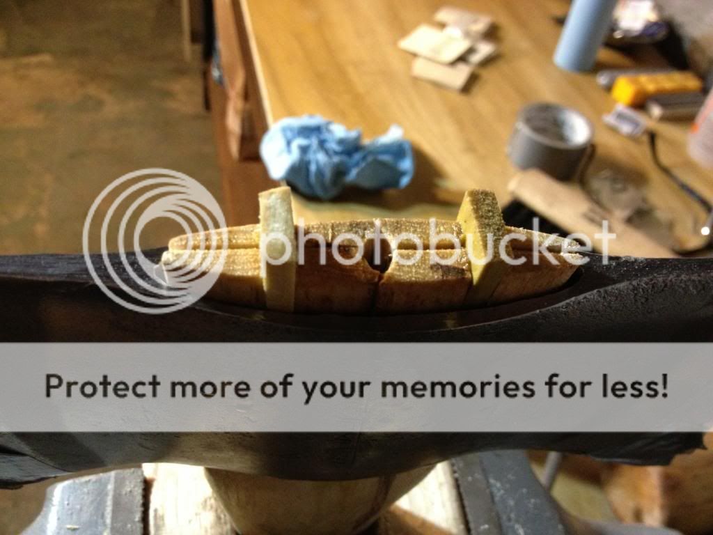

Here are the two smaller wedges, which closed things up a bit better, while also distributing stress more evenly than one huge wedge. I was ALOT more careful about not jamming these two in. I hammered lightly, and stopped when they stopped.
I then drove in the three small wedges at 90 degrees and cut them off.

Please be frank with your thoughts about the integrity of the handle at this point. I feel like I have worked around any pressure or force being exerted on the crack, but I just don't have enough experience to know if this will hold up.
Looks good. I don't know a whole lot about axes, but I do know a fair bit about wood being under stress and repairs.
First off, you started right by gluing and wedging either side. If properly fitted I would then take some heavy siezing twine and put two very tight constrictor knot under the head. Seal the knots with the BLO or handle treatment of your choice.
That's what I would do, others may say different.
-Xander

Frankl - I like what you are doing - the multi wedge scheme has my attention. I have a couple questions - these are not meant to piss off, overly critique, etc - but to open up discussion. Please do not take them the wrong way -
1. These axes with the multi wedges - are these working axes or hangers only?
2. If workers, do you think with multiple pieces in the eye they can hold up to chopping, and more importantly, felling? (felling is where I have historically made heads loose myself, cause the head is down in and I instinctively wrench out.
I wonder if the handles can hold up to repeated use with multiple wedges in the eye. I have no issue with what you have done, or how you have done it. Hell I have tried a multi wedge attack since seeing your work. I am just cautious with whether it will hold up.

No offense taken at all. I really don't know the answers.
That said, these wedges go in as deep and solid as a single wedge would. If they start working loose, I would think I could reset them.
My common sensical reasoning to all this is that a single wedge that leaves lots of room is going to work itself loose faster than 2-3 wedges that suck up all the empty space and keep the head from moving around on impact or when wrenched out after being stuck.
Upon impact or any other violent shock, empty space in which the head and handle could move as separate units seems more like the enemy than the number of wedges (within reason, of course).

Thanks for posting this thread. I believe you have done a great job with the handle save and also think you have done a marvelous job restoring and sharpening the axe head. Would you mind revealing what method you used on rehabbing the bit? I.E. was it a belt sander or files and stones, sandpaper etc. It sure looks great and I would love to imitate whatever method you used(although I am sure my results would be inferior to yours).
Thanks,
Kevin
