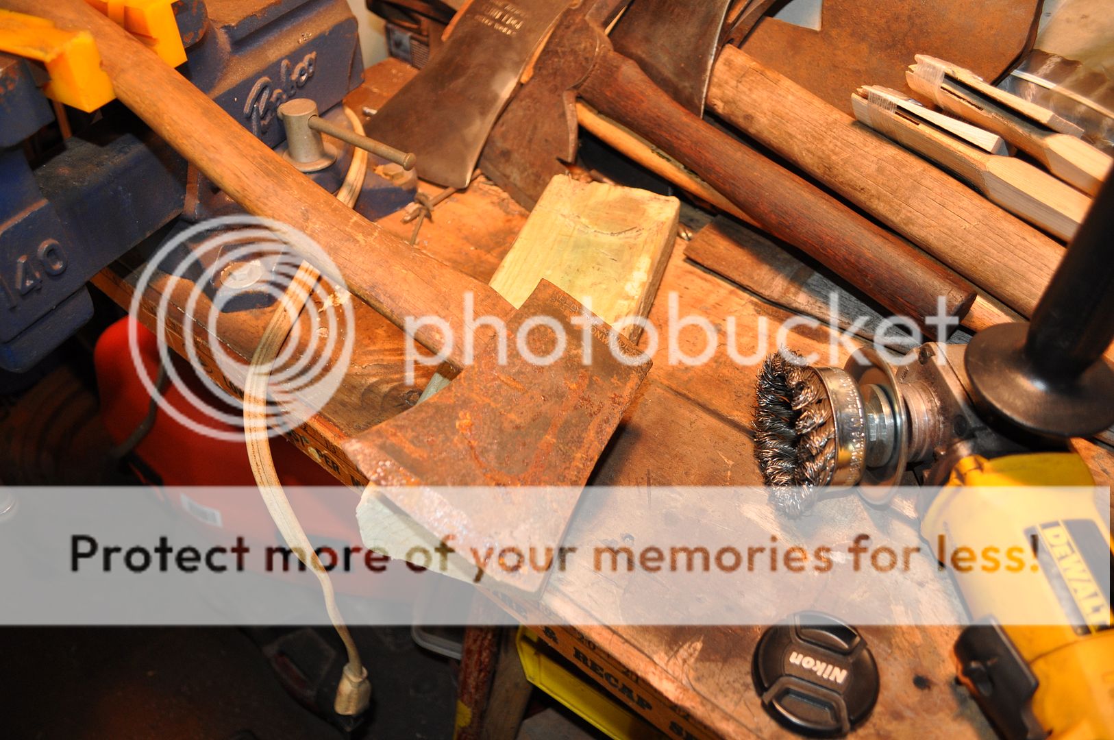

Thanks again. I had a blast, and learned a ton. I am hooked:) I'll post photos and such of my 3 Jersey patterns and a Kelly double bit I just scored yesterday as I work through them.
For now, what do you all think of the idea of drilling a hole at the bottom of the kerf to prevent splitting and possibly create more even expansion when the wedge is driven in? I just did it on the fly because of fear when making that perpendicular kerf.
Thanks!
Thanks!
John, I had to think about your idea of a small hole drilled in the bottom of a kerf. While I've never seen it done before, it sure seems to make sense to me. It is a proven way to stop a split or a crack in metal (Liberty Bell). I'm sure it can help. One just has to be careful that it isn't exposed below the head. Would you also do it the long way through a haft? I've never seen that done either. People just seem to depend on the eye surrounding the haft to prevent splitting.
Tom
I really like the hole drilling idea. I think its genius. I will do it next time I put in a cross wedge, but I don't think I will do it long ways for the main kerf. Awesome idea.
