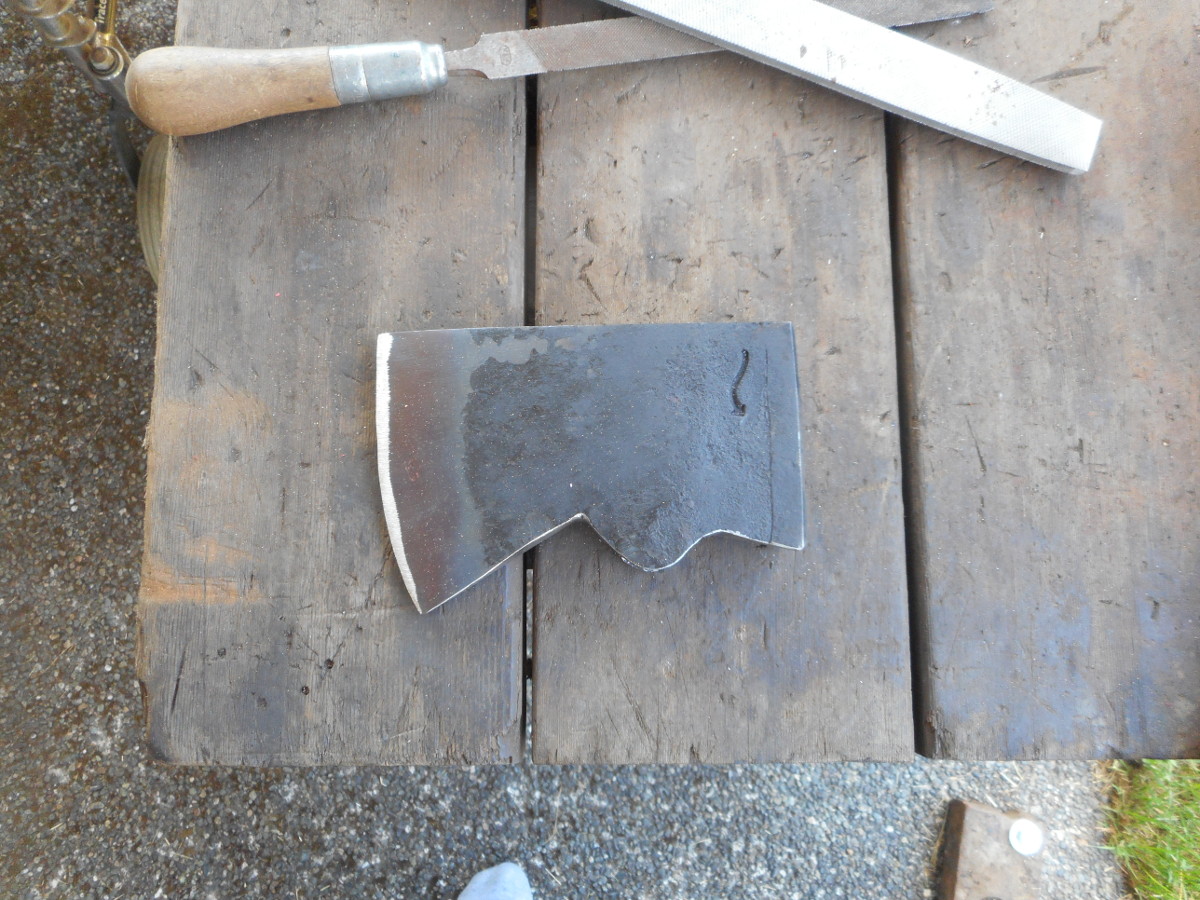

The axe came to me fully forged and with much of the forge roughness removed. It looked like this.

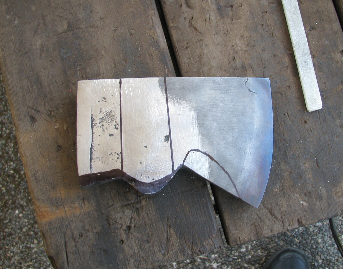

I began by just cleaning up the perimeter and balancing the lugs.
I toyed with the idea of giving it pointed lugs but in the end rejected this idea.

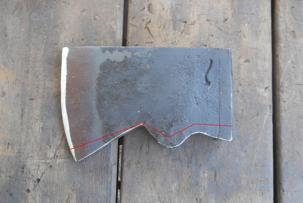

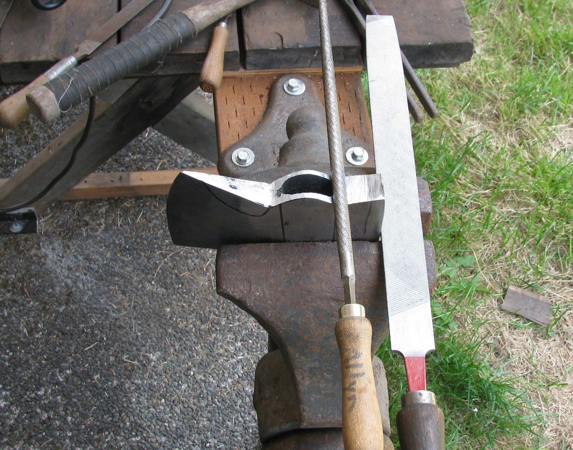

Instead I elected to go with round lugs and center them on the eye. I drew lines indicating where the eye was and then shaded the area to be removed to get the shape I wanted.
I cut some of the poll and lugs off with a cutoff wheel and then finished the shaping with files.

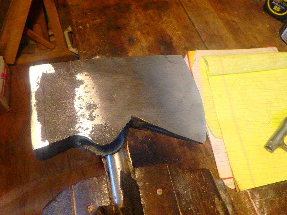

Next I laid out the bevels. But I didn't cut them yet. In the past I've spoken about not just shaping the haft to the axe but also filing the axe to the haft. You can tweak the edge alignment a little by how you file an axe. The time to do this is when you still have metal to work with at the edge.
I began rough fitting my handle blank to the axe. This handle blank is cut from a stave of local black locust which I had air dried for 3 years. There were issues with it but more about that later. Fitting the haft revealed an issue with the axe that I hadn't noticed up until now.

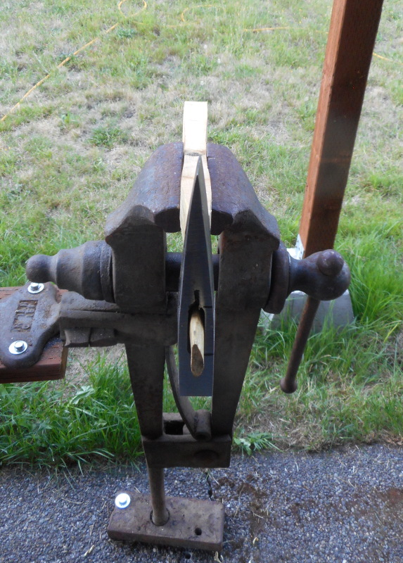

The bit was twisted off line from the eye and poll a bit more than I was comfortable with.
At this point there was a lengthy email discussion with Jake, getting his advice about how I might correct this at my home forge. He recognized that even my big 145 leg vise would have difficulty resisting the torque I would have to put on this axe to straighten it.

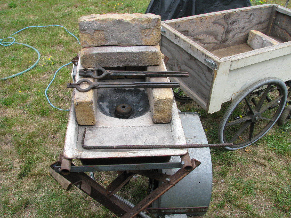

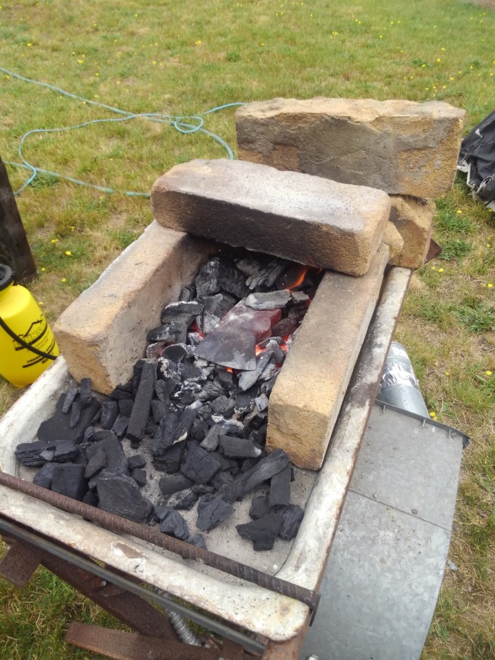

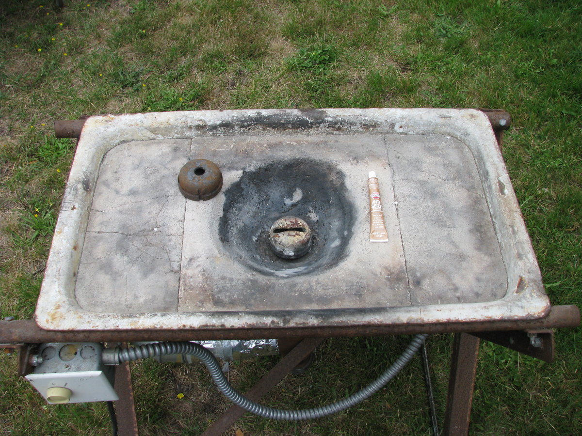

My forge, cobbled together 9 years ago with junkyard parts. It's made from an old cast iron sink filled with clay earth and capped with refractory cement. I'm swapping out the directional tuyere I use to create a longer fire with the standard tuyere. High temperature anti-seize compound keeps the threads from locking up.
Often I use firebricks to enclose the fire and concentrate the heat.

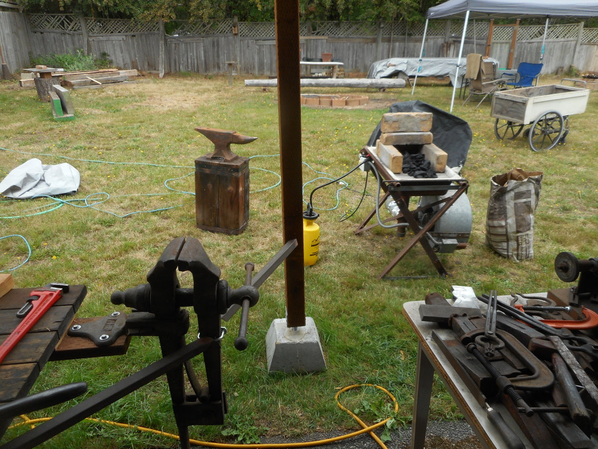

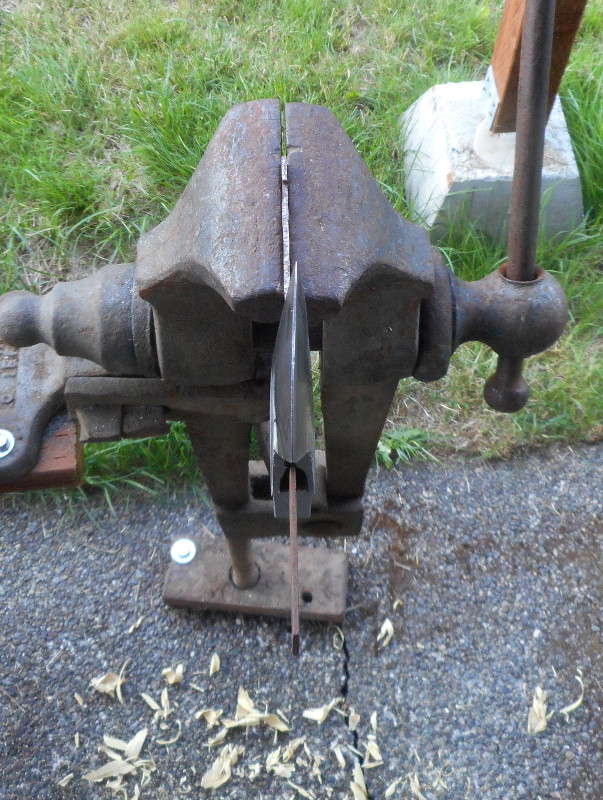

I brought the body up to heat slowly letting the heat soak through the axe. I used that yellow pump sprayer on the left to keep the bit cool while the body came up to heat. It would be easy to burn the carbon out of the thin bit by overheating it. Once the body was up to temperature I let the bit come up, just before I performed 'the twist'.
I would need to move fast once the iron was hot. I got everything ready before I brought the axe to heat. I pre-set my vise jaws to the width where I wanted the axe to drop into. I braced off the operable jaw of the vise so it could resist the the torque I was going to put on it. I still have a little bit of movement available with it braced off. I adjusted my twisting wrenches to fit on the axe as I would need them during 'the twist'.
Then when I was all set I made...
The Twist
It came out of the twist pretty straight. But it took several more heats to clean up the wrinkles I left in it during the twist and then to straighten and slightly enlarge the eye with some makeshift drifts.

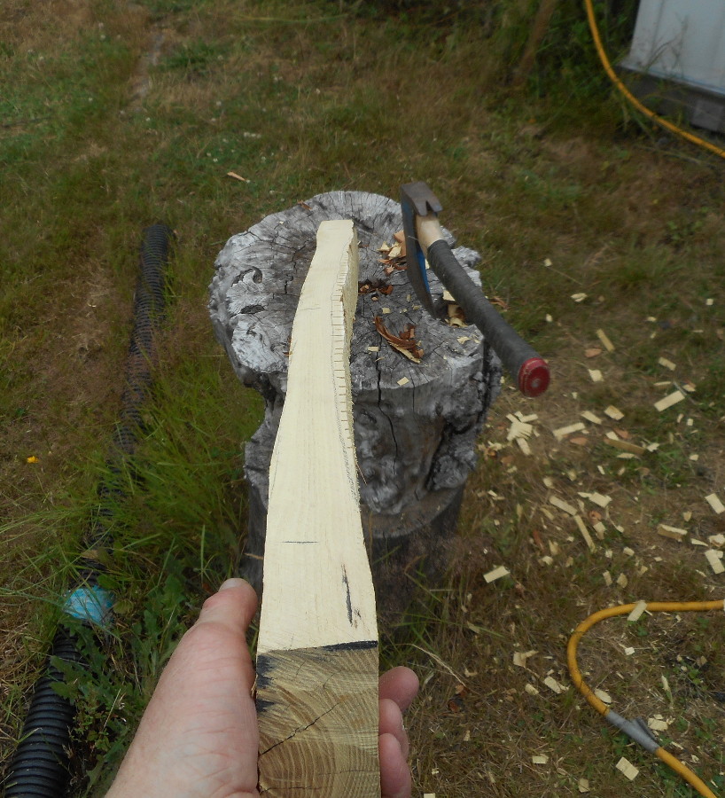

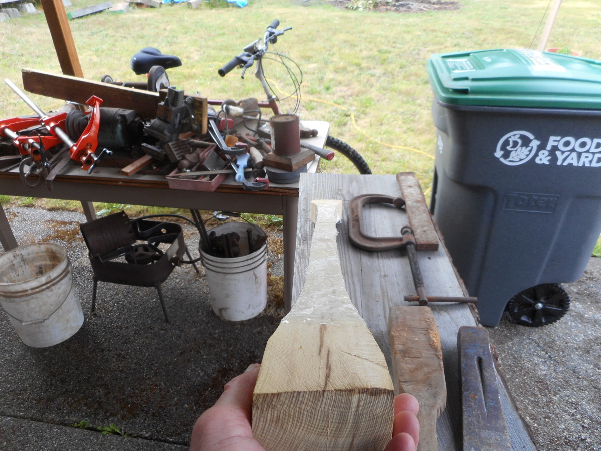

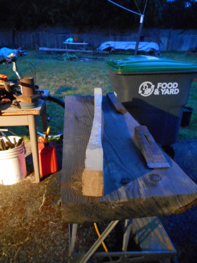

I started with one of 3 black locust staves that I set to dry 3 years ago. Black locust is about the best haft wood I'm going to find around here. These were beautifully straight staves when I first split them but they all warped while drying.
I picked one and cleaned it up with my Lancelot tool.

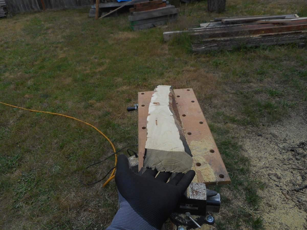

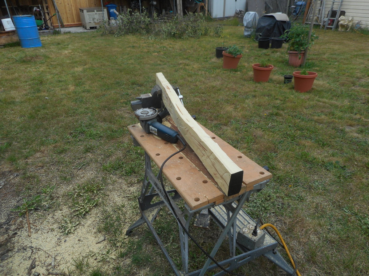

As you can see it was warped in both directions and was too heavy to easily steam bend.

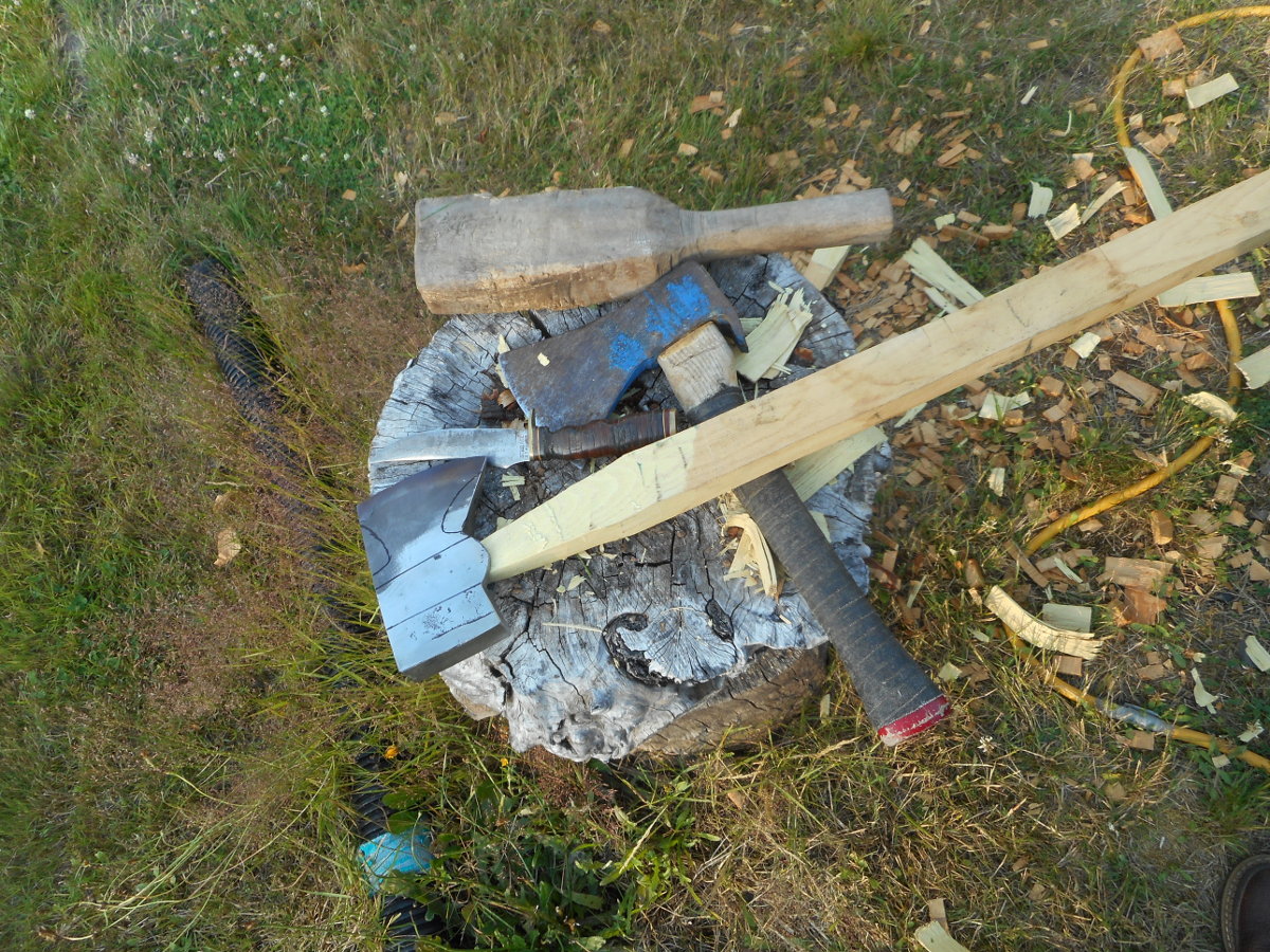

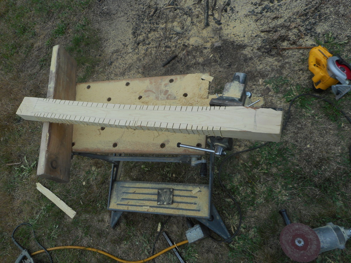

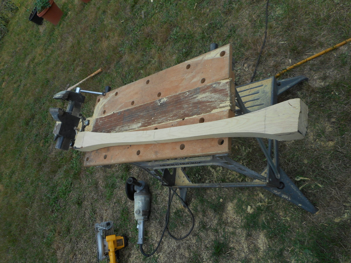

So I traced out a handle blank following the grain of the wood. My goal was to end up with a continuous grain haft.
I kerfed to the line and chunked it out with my Stubai carpenters axe.
Then I did the same in the other dimension.

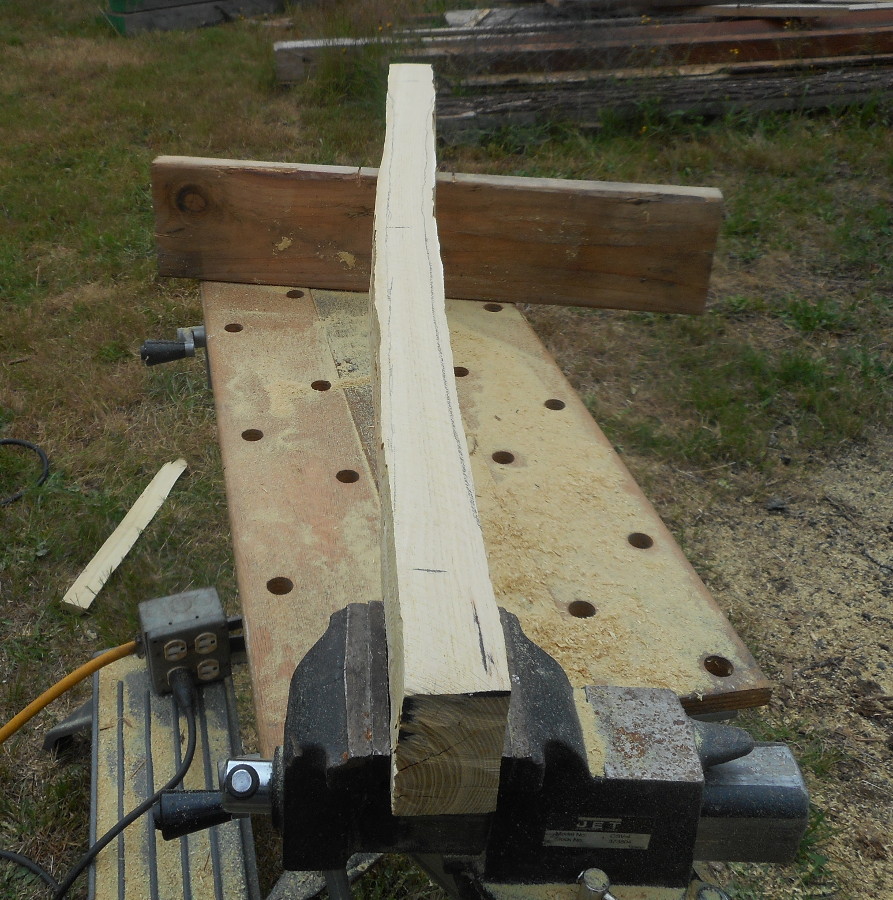

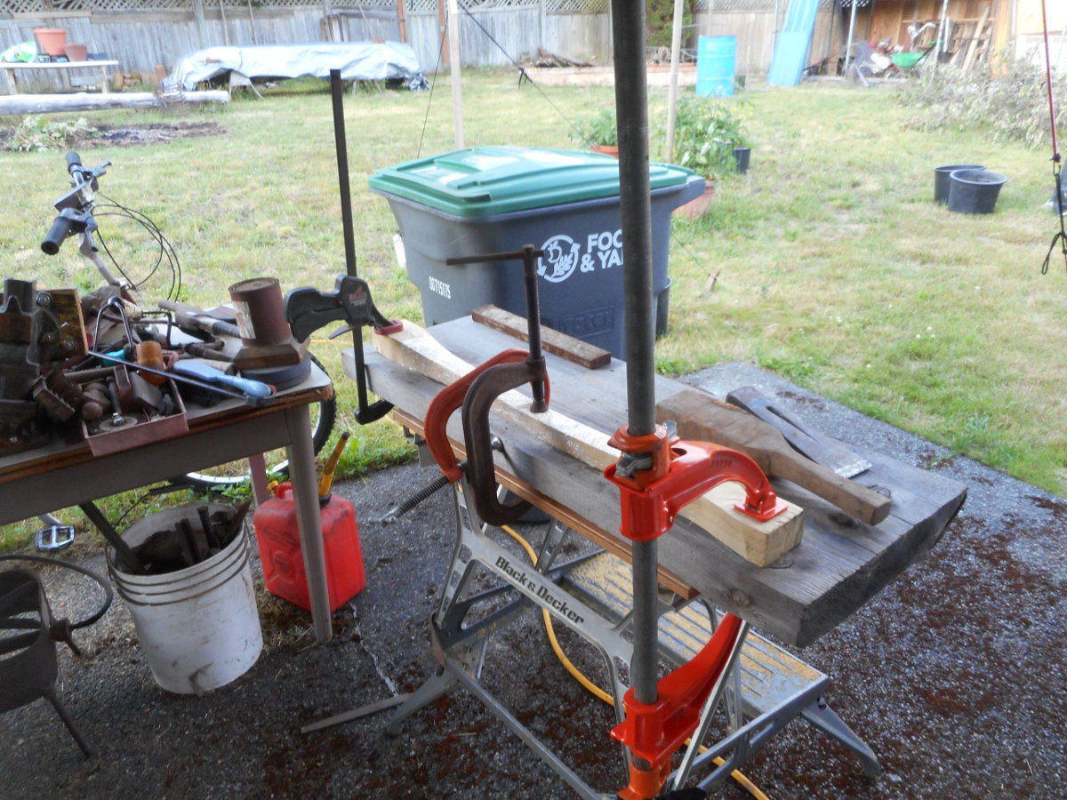

After sanding I had a handle blank thin enough to steam and straighten.

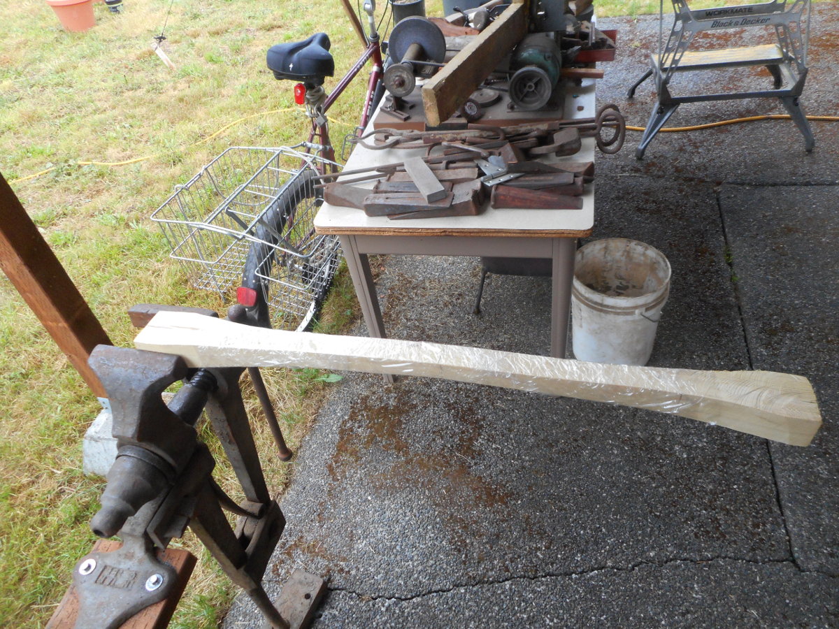

I wrapped it with Saran wrap before steaming. I don't need to get the wood wet, just hot.
I used my standard steaming procedure on the kitchen stove. I gave it about 45 minutes of heat.

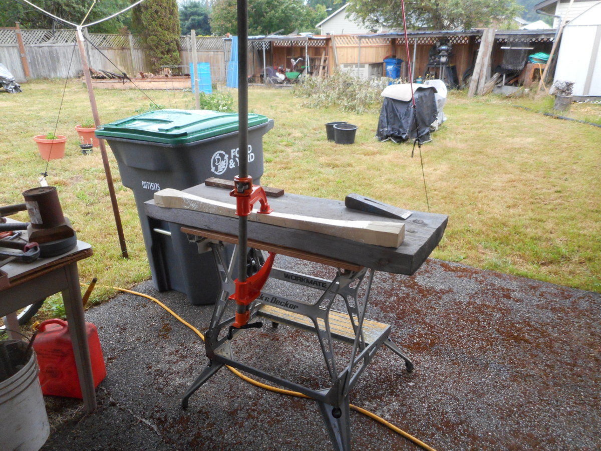

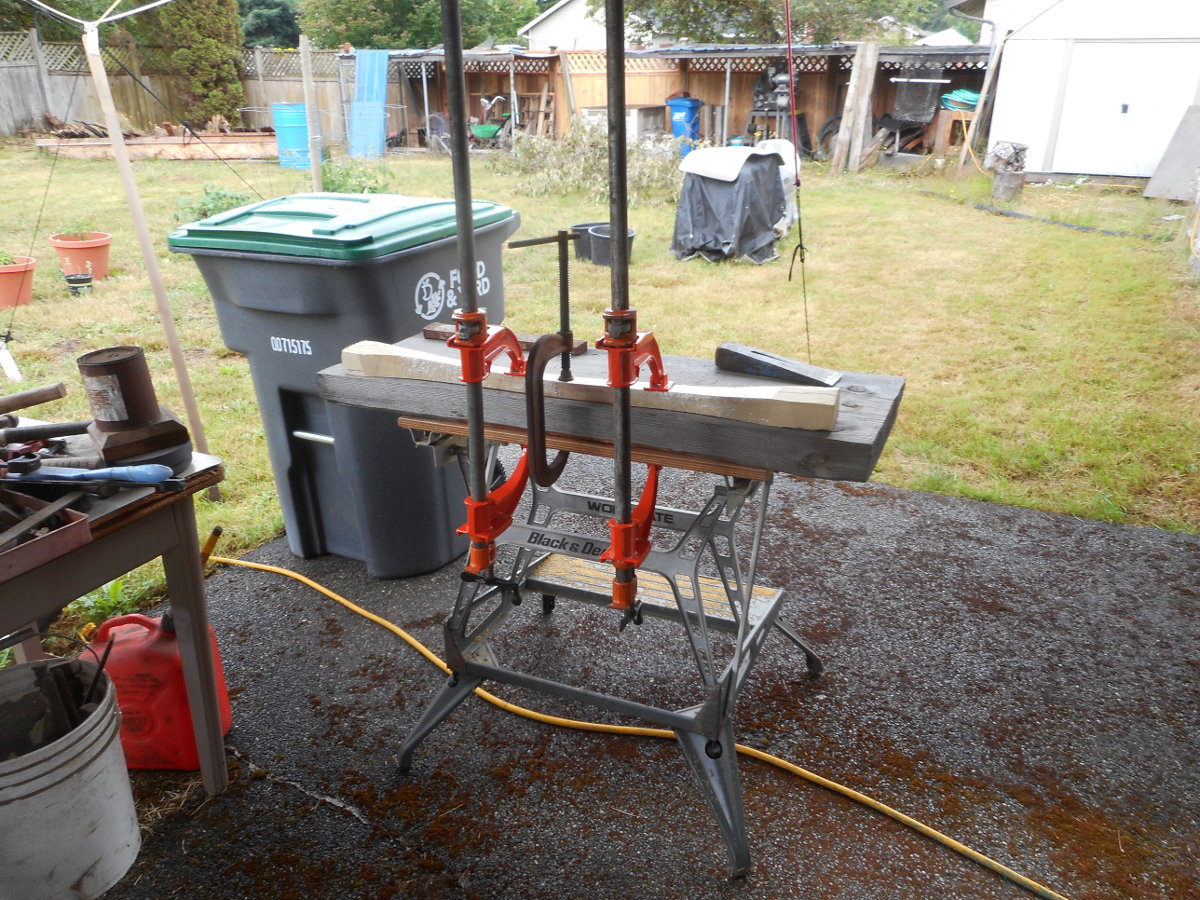

Then I clamped it to the bench and let it cool.
Turns out I hadn't clamped it down tight enough. It came out still warped.
So I heated again and clamped it tighter.
That got it reasonably straight in one dimension but I still had the warp in the other dimension.
I realized that when I tried to straighten the second dimension that the first was likely to return to its warped condition. So I heated it a 3rd time and clamped it straight in 2 dimensions.
That did the trick and I wound up with a blank that was close enough to make into a nice handle. I know this seems like a lot of work for a haft but I looked at it as a challenge to see if I could make a nice haft out of local stock. Good learning experience.

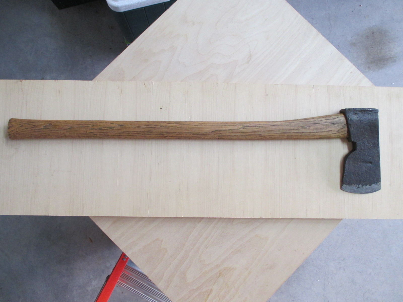

I ended up with a nifty little 2.7 pound axe on a 29" straight haft.
I love it already. It's a handy user. And I love all the history in it, Jake's, Old Axeman's and mine.
