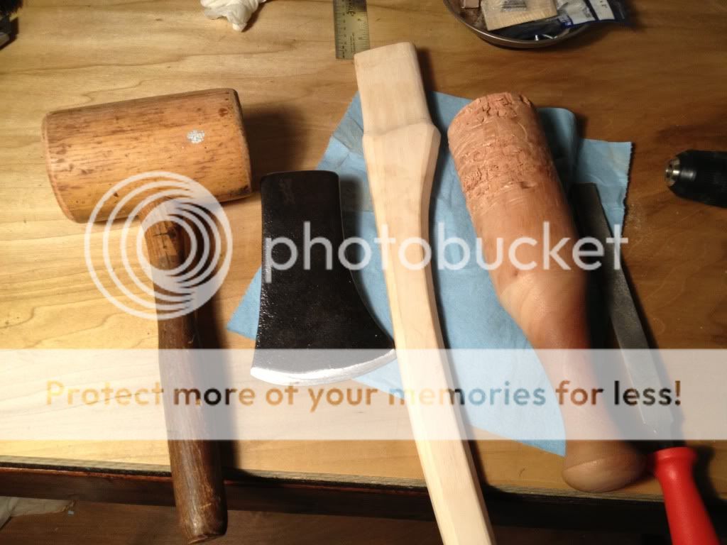

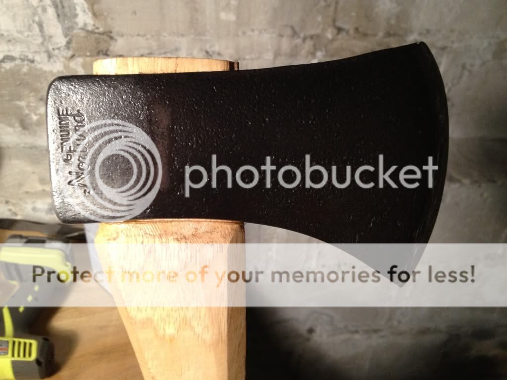

Here is the head pretty much as I got it, with only the stamp cleaned up a bit.

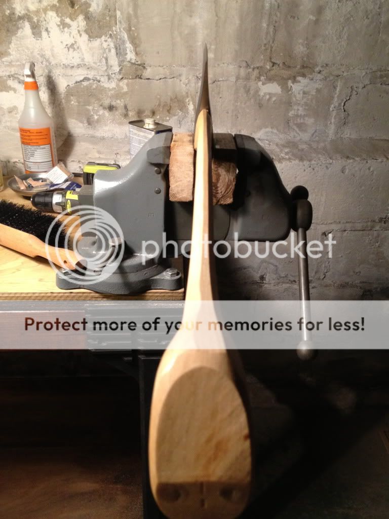

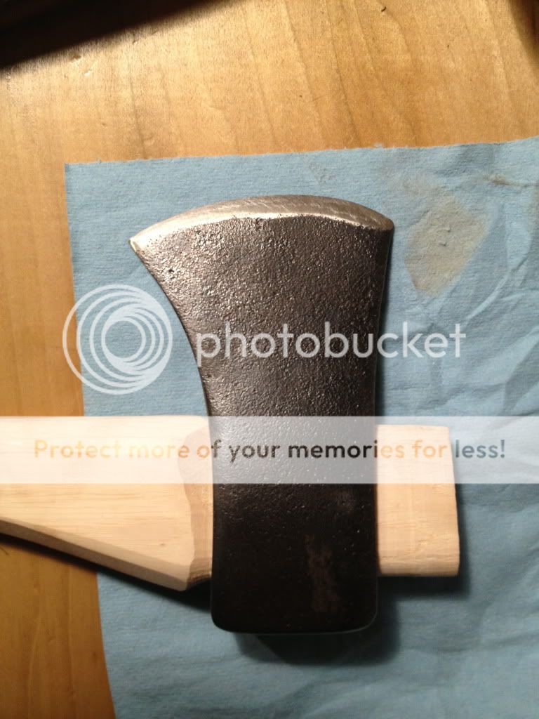

Now here is my first fit up, without any filing, grinding, etc. The House Handle boy's axe handle fit darn near perfectly.
Here it is back off the haft for some fine tuning. By the way, at this point it's been on a grinder and worked by hand with a stone. It's shaving very nicely.

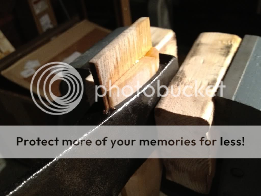

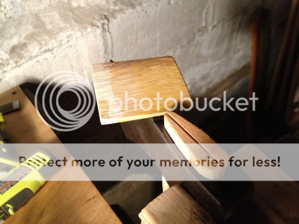

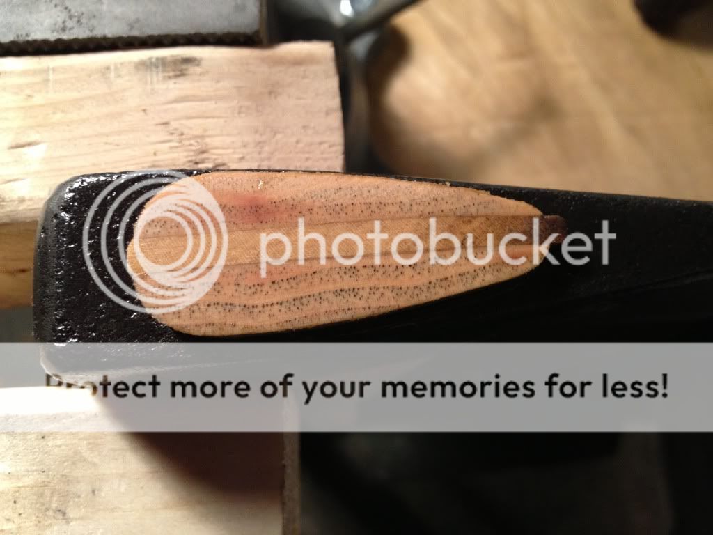

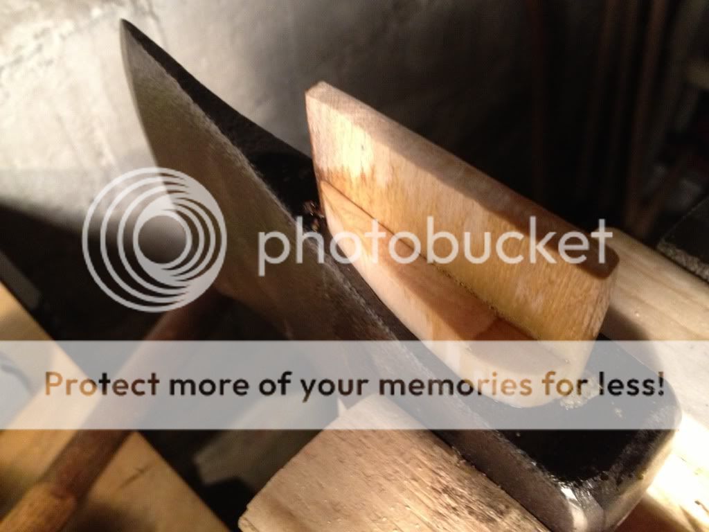

Here is the second and final fit up with both kerf and wedge lubed with BLO, and the wedge shaped to fit the eye. I also gently used a cold chisel to open up the kerf on top a bit.

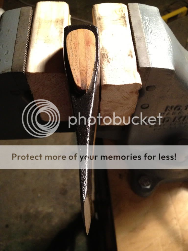

Here is the wedge driven home. The BLO does seem to help a bunch. Thanks!
Here it is ground flush, although I did decide to leave everything a bit proud on this one for a change.

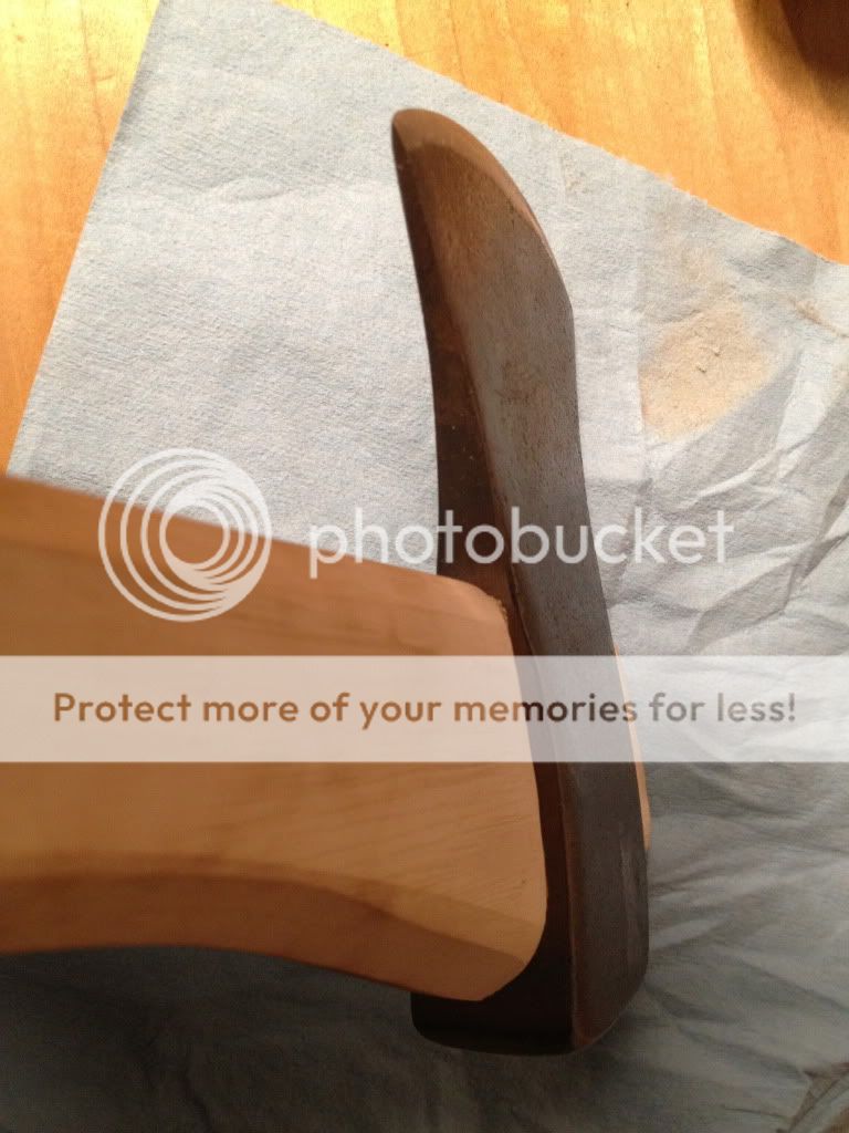

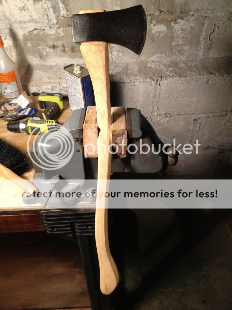

Here are some overall photos of the axe. The handle is great. Nice and slim with a big 3D fawn's foot on the end.
Thanks again to everyone. The handle was a bit small, and without all the good advice on wedges I'd certainly have gaps to plug, etc.

Are you going to slim the shoulders of that edge at all?

"Are you going to slim the shoulders of that edge at all?"--Yeah, it is ground sort of like a cold chisel right now. But the overall geometry is thin already, so I'll likely chop a bit before going thinner.

Nice job! What kind of vise is that? I've been looking for a good older vise in the 6" range.
Gruntmedik, Yes it's a Reed. I disassembled it, sandblasted everything, repainted, etc. to make it pretty, but it was very serviceable as I found it. The jaws are only 3.5" but it does everything I need.
The same guy who sold it to me now has a 4.5" beast of a Chas. Parker vise, swivel base and near perfect jaws and movement for $65, I believe. I almost bought it, but I really have no use for it. It was just so pretty:) Even with shipping it'd be a darn good deal and you'd wind up giving it to your kids:)
