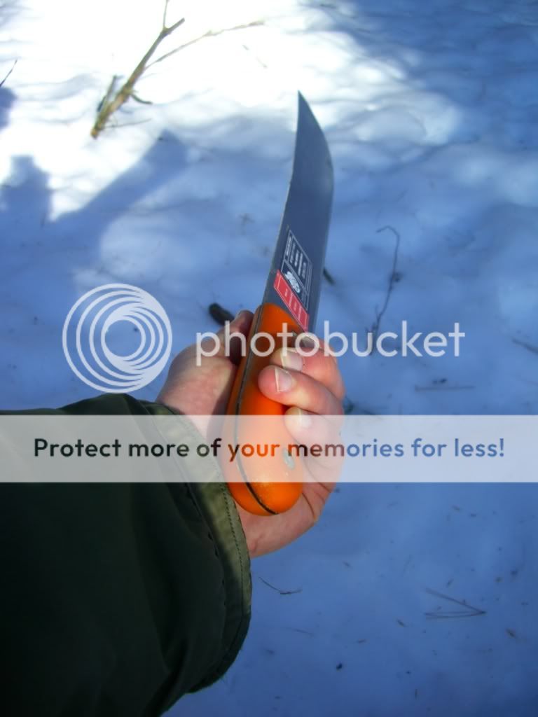

I got out yesterday with my new orange-handled Hansa and decided to give it a beating. This thing has a 24" blade (tapered only along the last third) and a riveted polypropylene handle. As you may imagine, a machete with a weighted nose and a blade this long is one heavy hitter! I went to my usual stomping grounds to give it a spin.
The overall balance and feel of the piece is very dynamic. It suffered from the same "problems" as most machetes--that is to say it came with some very slight handle/fit issues and only a quickly ground region to take some of the work out of putting an edge on it yourself. Both of these "problems" were quickly and easily corrected.

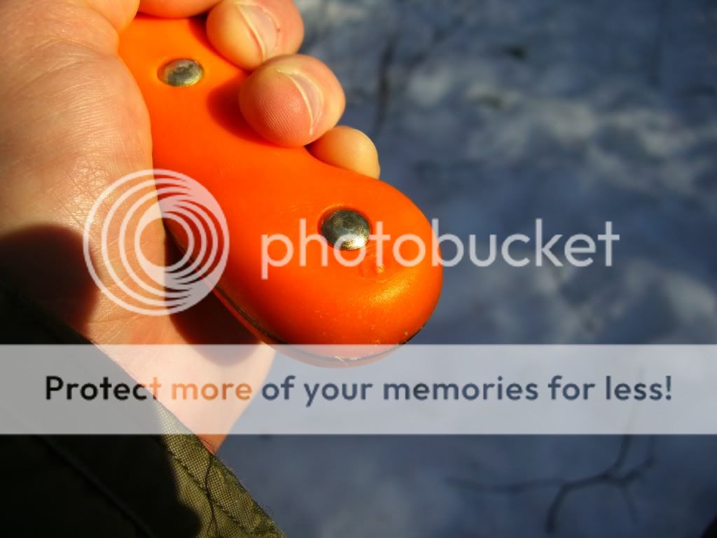

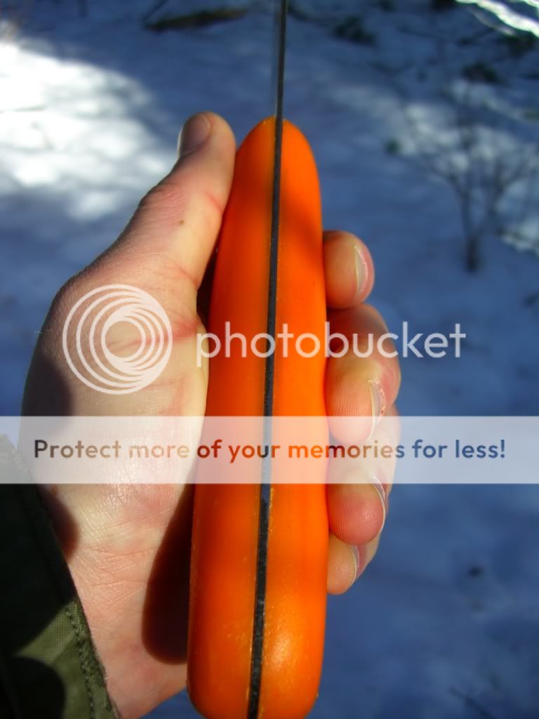

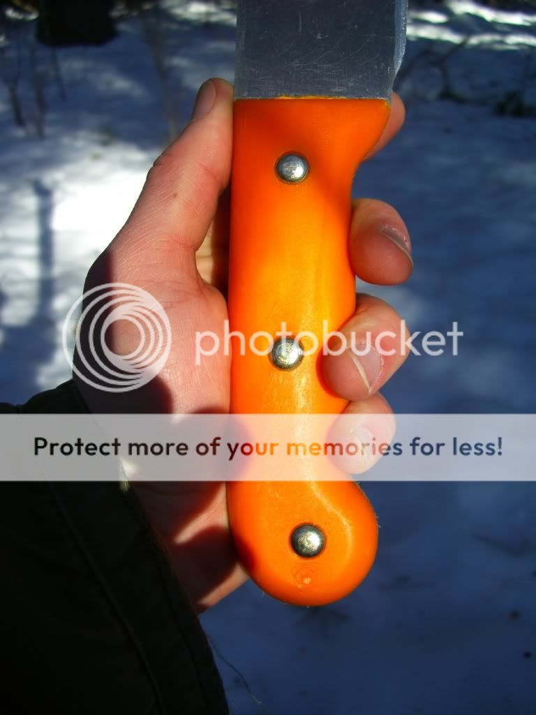

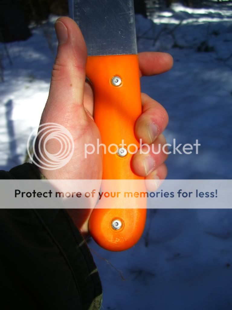

Right handle scale:
Left handle scale--you can see the difference in the shape of the rivets here:

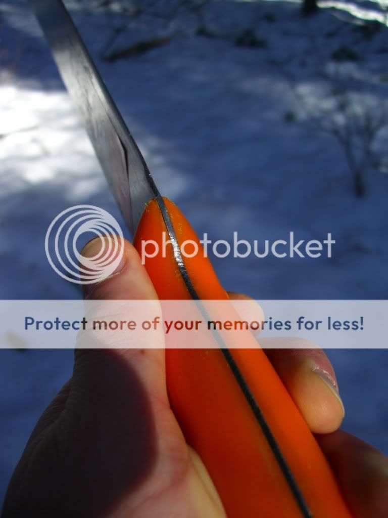

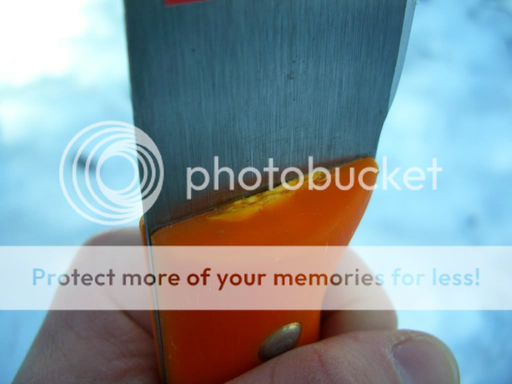

Front of grip--I fixed a slight fit issue here, as the tang projected above the scales slightly:

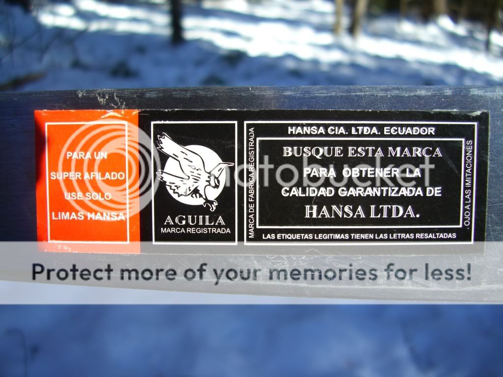

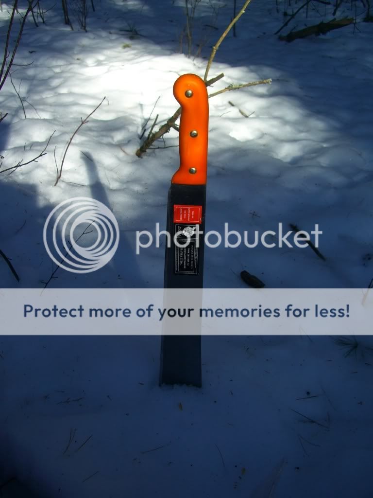

The sticker--an insignificant detail, but it's quite high quality, with raised lettering and borders:

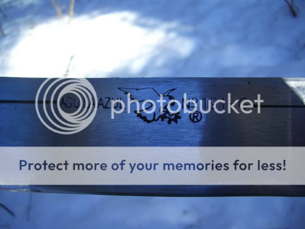

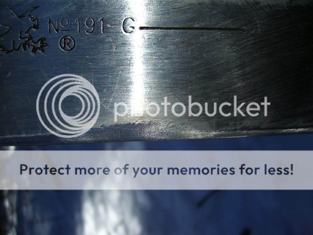

The side opposite the sticker (edge facing left) There is a single long groove along this side only, broken in the middle by this logo:
Funny it says "Blue Eagle" when orange is the opposite of blue on the color wheel. :D

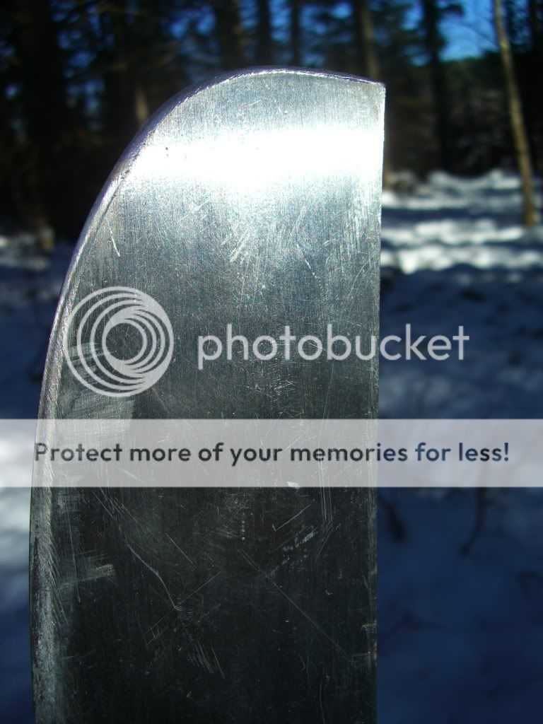

The Lampon style of machete has an almost spatulate tip, lending a certain extra mass to the point. There is little point to speak of; the edge terminates perpendicular to the vertical axis of the machete. Golok fans will find this sort of tip very familiar.

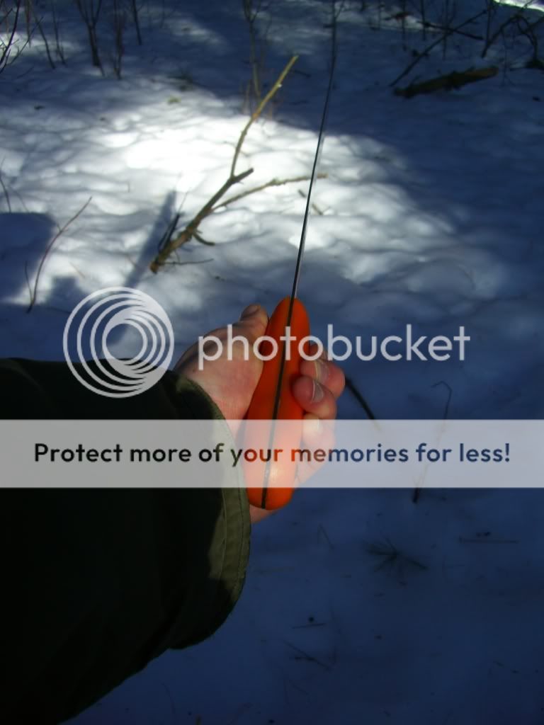

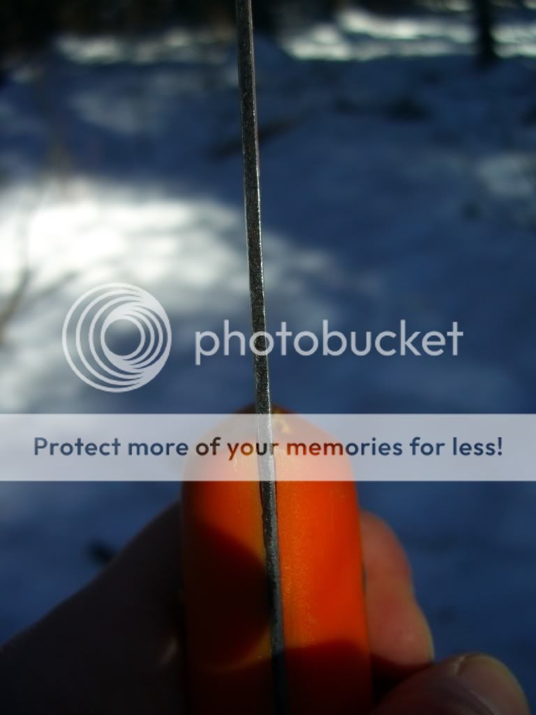

The blade (much like Imacasas) features a distal taper, the stock thinning towards the tip. In this instance, as previously mentioned, the blade only tapers significantly along the third closest to the tip. The first picture shows you the spine nearest the handle, the second shows you the spine at the tip:

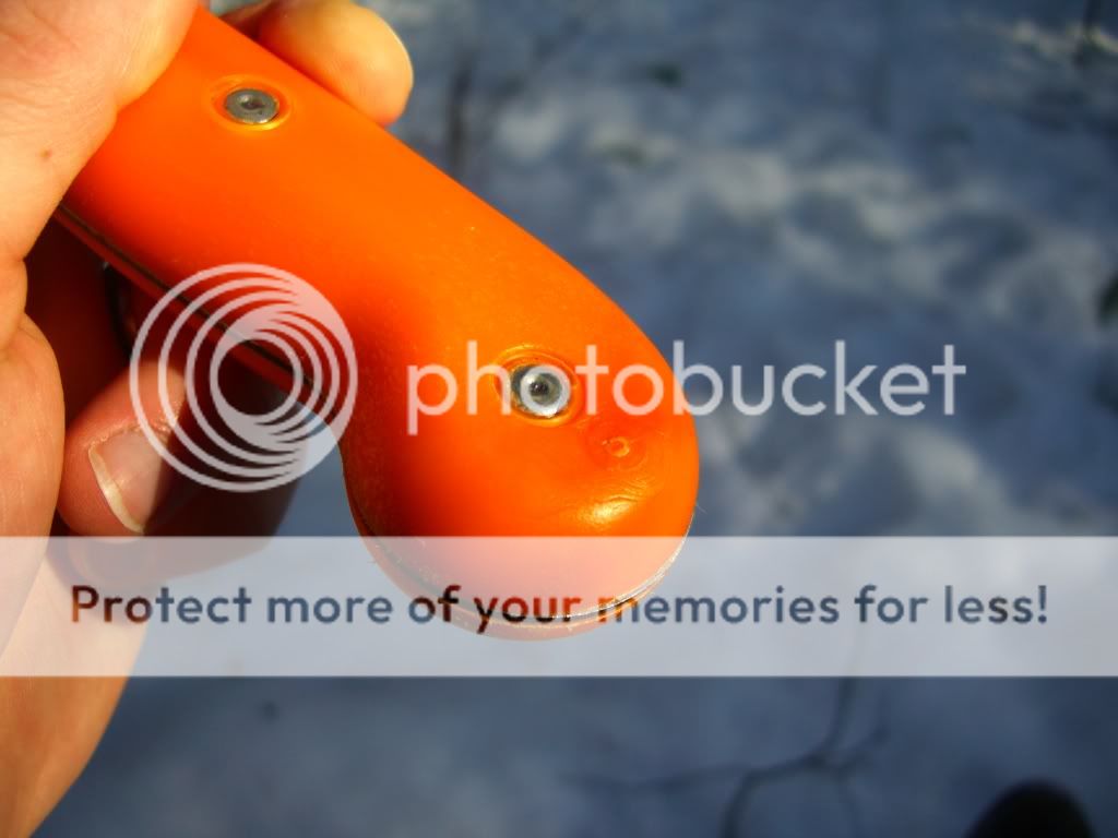

The right scale features what I take to be a molding mark at the top of it. Again, this is purely cosmetic, and does not detract from the feel or function of the handle.
Additionally, there is a small molding mark at the base of each scale. I trimmed these down flush, though you can still see where they were:

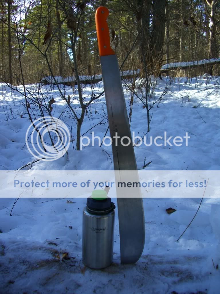

To put it in perspective just how large this beast is, here it is next to my Guyot:

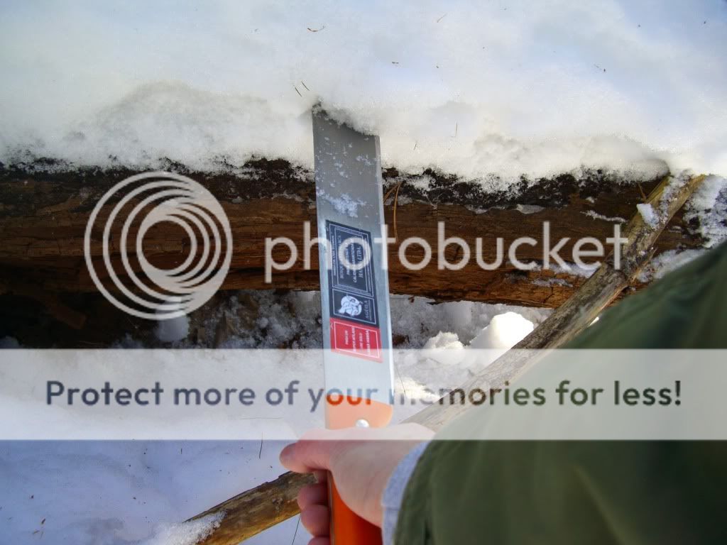

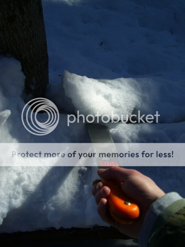

The broad blade was well suited to clearing snow. Here I'm using the spine to break up some crusty snow to clear a log:
After breaking the crust free it was simple to lift the entire section off in one piece:

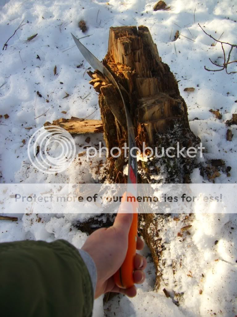

The broad tip later proved useful for excavating pine stumps.
Given that I was in a gargantuan White Pine forest, I figured I'd bust up some stumps to look for fatwood:

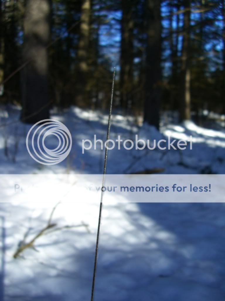

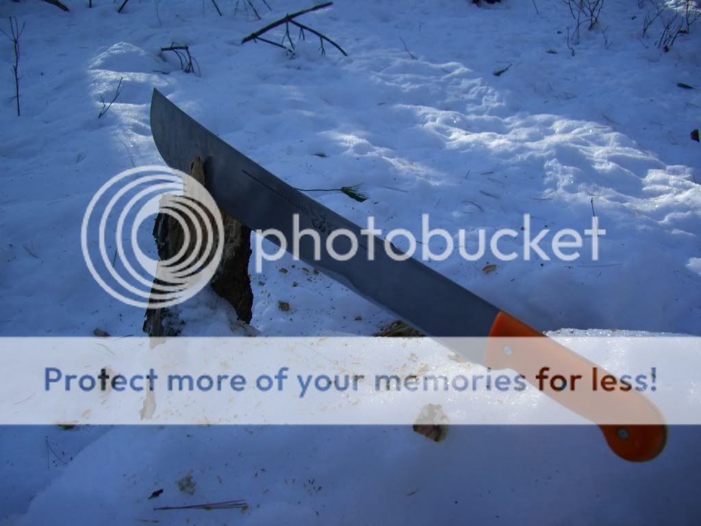

This provided me a good opportunity to photograph the admirable flexibility of the Hansa:
During the extraction process (during which I cleared rotten sections and broke up the remainder by digging and lightly prying with my Condor Rodan) I managed to bang my knuckles. No biggie, but it needed to be covered to keep it clean:D:
I met with only marginal success (it's hard to see the typical forms under the ice and snow!) but I still met with enough success to justify the total destruction of the stump. Victory!:
In short, I found the Hansa Aguila Lampon to be nothing short of a machete-shaped axe! I'll need to fashion some improved way of carrying it (cardboard doesn't cut it) but it was nice and light, while giving me ample chopping power. I suffered some bad glancing blows at some points, but I found that was due to me not bringing the edge angle back far enough in some spots, so I'll be fixing that soon. The handle was consistently very comfortable gloved or bare-handed, and the tapered blade made handling the large and weighty thing a breeze. The edge remained perfect through the entire encounter, and did not require touch-ups in spite of repeatedly striking frozen knots.

The interesting thing is that even though the blade is very flexible, it doesn't "sag" under its own weight or wobble when you wave it in the air or swing it. This is important, because a sagging blade can cause accelerated fatigue and make your swings go off track. The blade flexes easily, but only when outside forces are applied. :thumbup:
