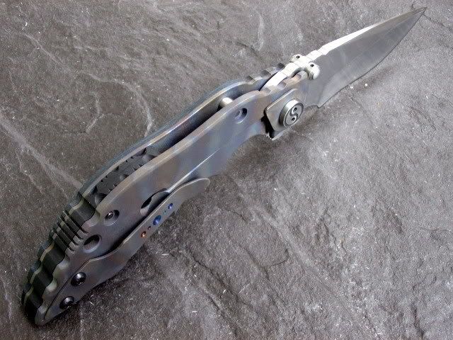

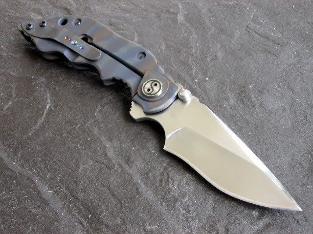

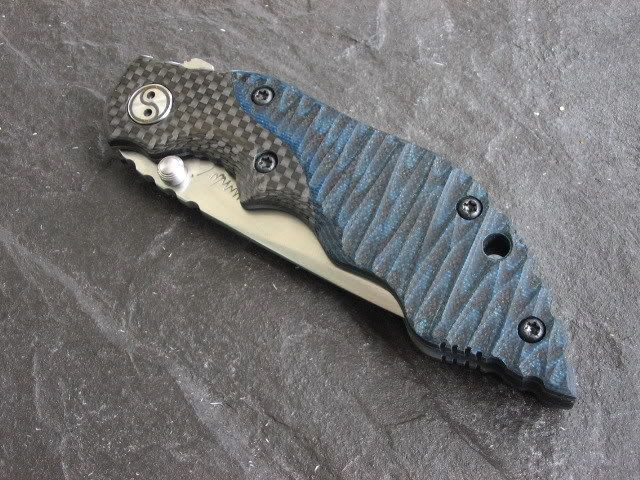

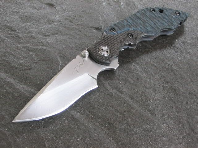

Hi all,
Just finished and sent it to USA.
This is the first Hard-3 that
I make hands rubbed satin finish.
The specs. is:
Blade steel : ZDP-189 which's laminated with ATS-34
Thickness : 4mm.
Blade length : 4" from tip to flipper
Closed length : 5 1/2"
Opened length : 8 3/4"
Width : 1 1/2"
Handle : Carbon fiber& textured black/blue G-10
Locking system : Frame lock
Frame : 6AL 4V titanium 1/8" thickness.
Frame stop : 6AL 4V titanium
Spacer/ Clip : 6AL 4V titanium
Pivot : Hardened 440C in Yin-Yang style.
Thanks for looking.
