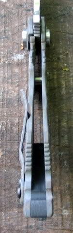

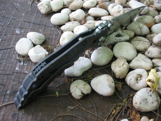

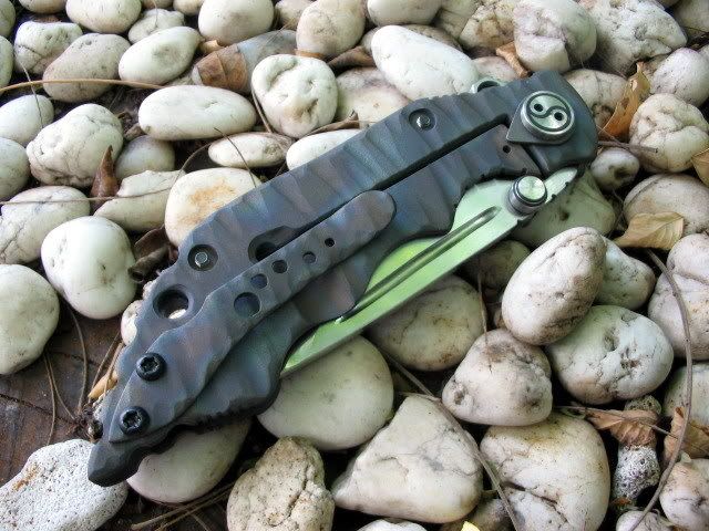

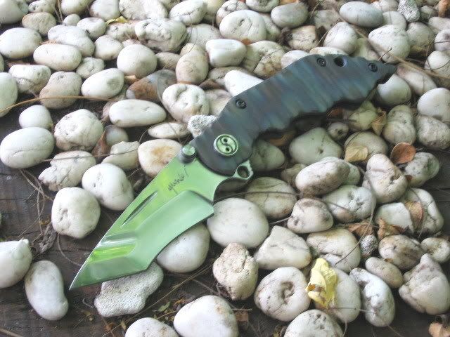

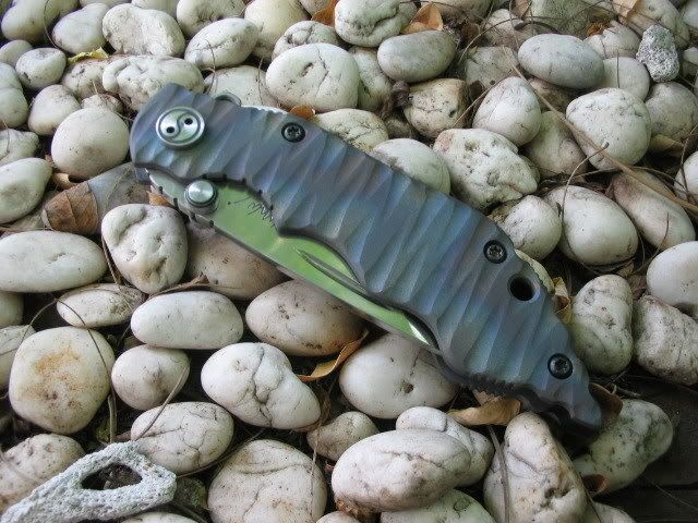

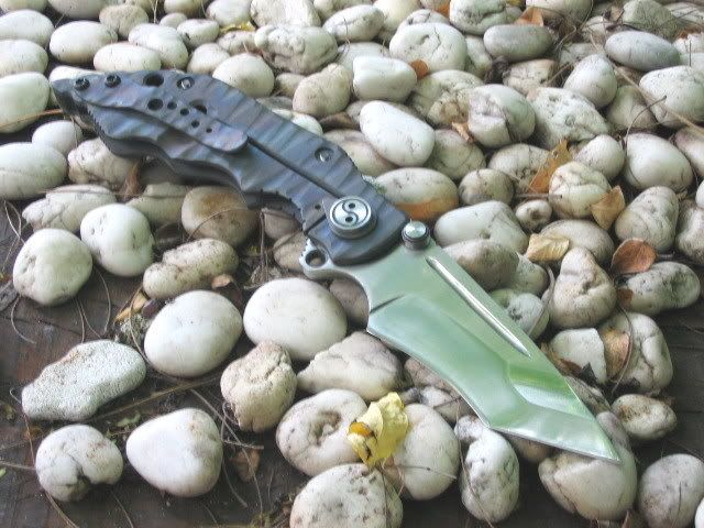

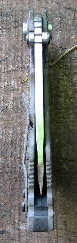

Hi all,
Finished 2 days ago for Thai bro.
The spec is
Blade steel - ZDP-189 which 's laminated with ATS-34
Blade length - 4" ( tip to flipper ),hand rubbed satin finished , 1 3/16" widest
Closed length - 5" length and widest 1 1/2"
Handle matt. - 6AL 4V titanium,1/8" thickness
Lock system - 6AL 4V titanium flame lock 1/8" thickness and thumber stop
Flame, spacer and clip - Sand blast&hardened 6AL 4V titanium
Pivot screw - Hardened 440C
Thumb stud - Hardened SUH 3, this steel is valve steel in diesel engine.
Thanks for looking
