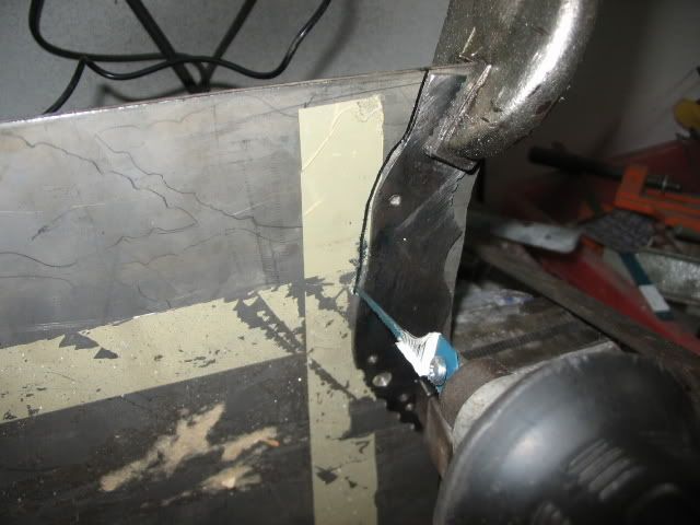

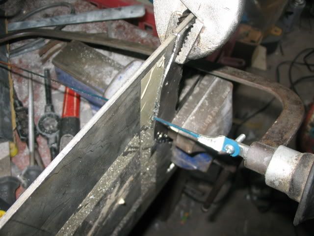

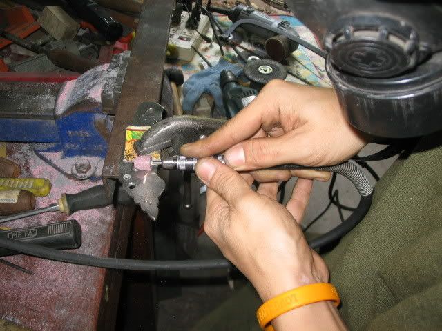

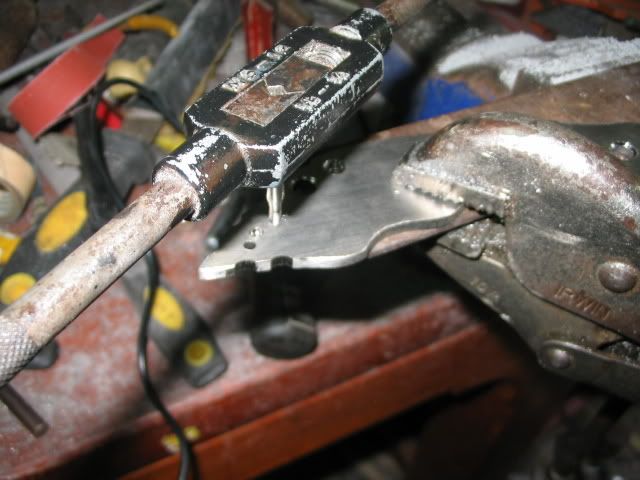

Some of process when I make it.:D
1. Cut 1/8" titanium by hack saw. (Frame&spacer)
2. Make it to shape by hand file.
3. Make hole and screw.
4. Make frame.
5. Grinding by Dremel.
