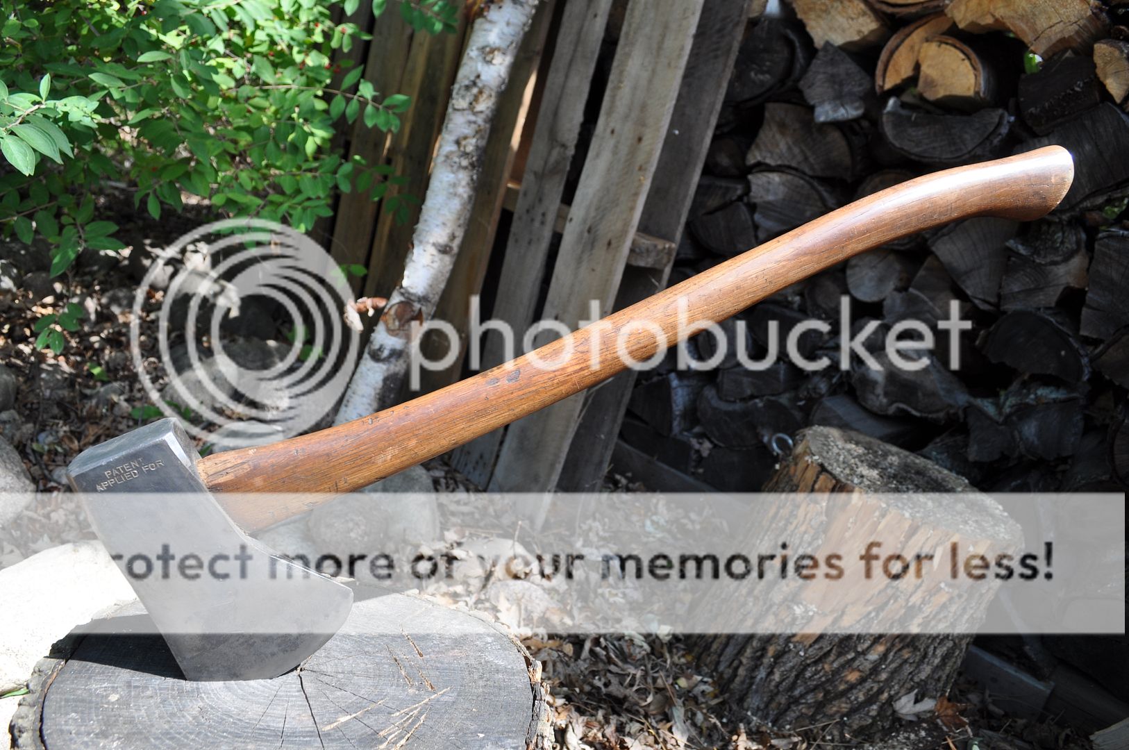

Here's one of my Plumbs.
Good luck, Tom
Thanks Tom, That's exactly one of the heads I'm talking about! Says: "patent applied for" right? My other one is a big Collins 5 pounder. I'll try the file thing with it.

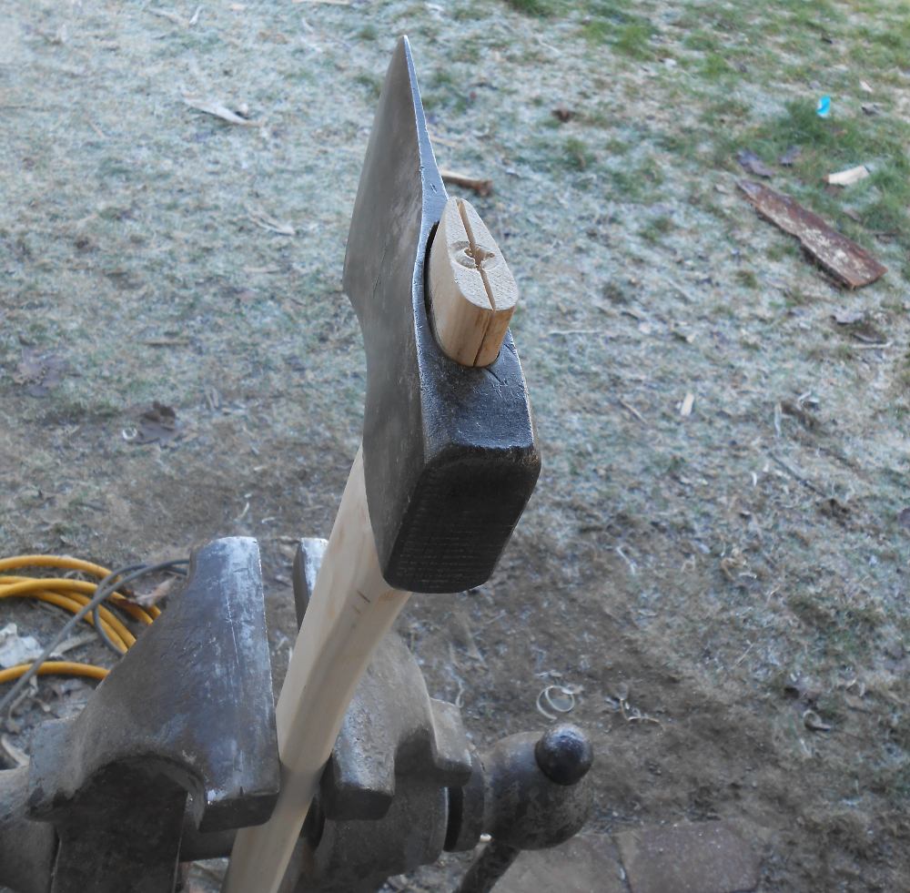

Here are a few of my hardened poll axes.
Collins rafting axe with loggers brand welded on.
Plumb rafting axe with waffle poll.
Walters rafting axe.
True Temper Dayton pattern with an 'A6' stamp. One of my favorite axes.
First clue that the A6 had a hardened poll was the chip. A soft poll would have mushroomed instead of chipping. The file confirmed that it's hard as the dickens.
