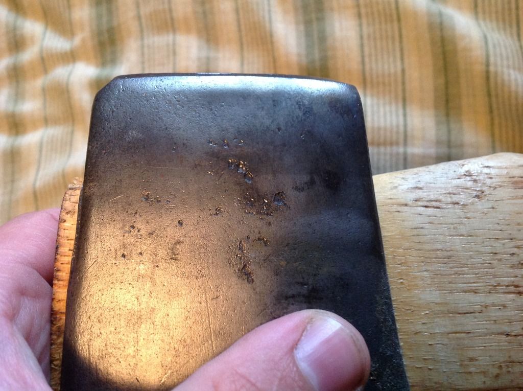

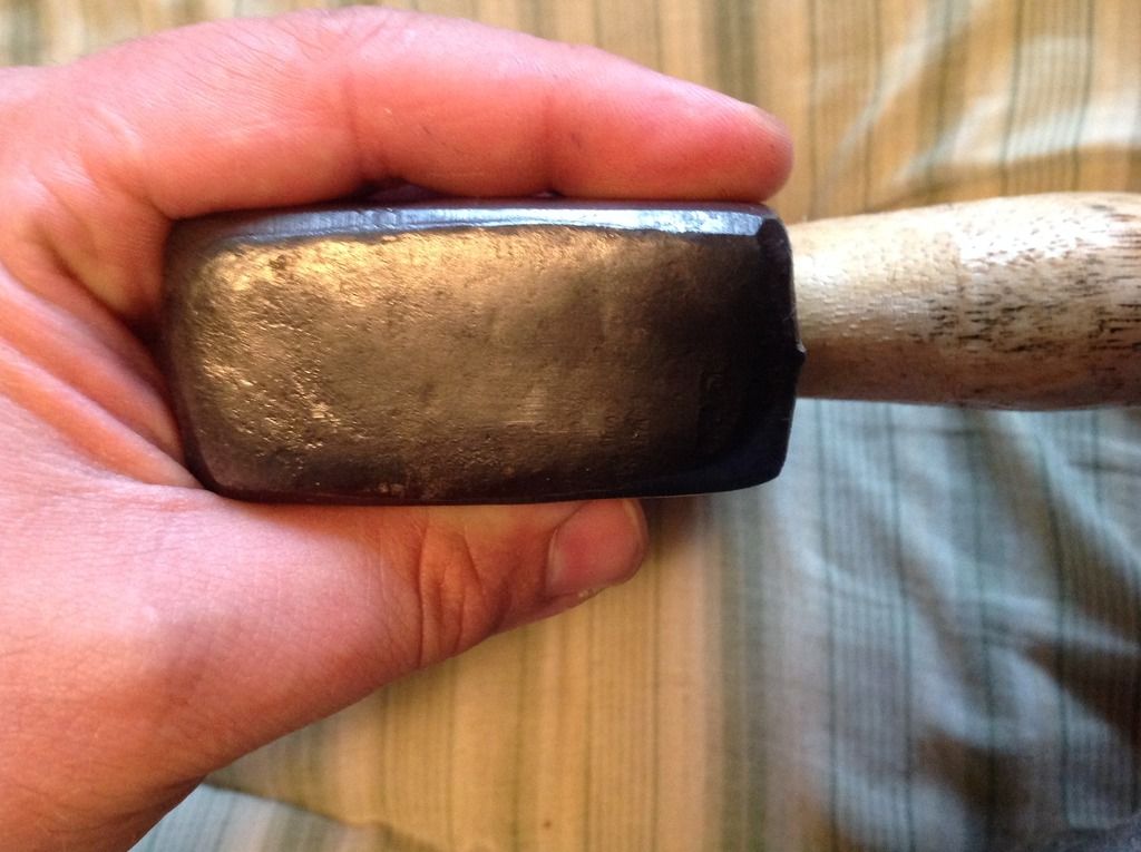

We need pictures! Many of these otherwise 'dark horses' have some sort of recognizable profile. And we need some knowledge of the poll being hard (file skates over it) or is chipped rather than mushroomed from use.
Temper line work instead of chips/ deformed pole
Here's the pol the shiny spots are where the file skipped across
The whole thing, before I cleaned it up there was some light blue paint showing under the rust, about the same color Forrest king used to use
Wow, are you sure that's a 3.5-lber? it looks huge? That's a really cool axe. After seeing them on the forum more often, I now want one for my truck! :)

It's just over 4 lbs hafted
That's what you've got! That temper line along the poll clinches it. Typically Rafting axes were 5 or 6 lbs and Constructor versions (the construction and mining industry saw fit to adopt these) were available in lesser weights of 4 lb but a 3 1/2 lb head is a new one on me. Your's ought to be a handy little devil for cutting and splitting, and driving wedges.
