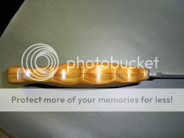

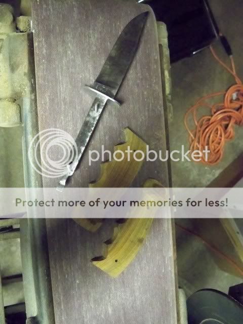

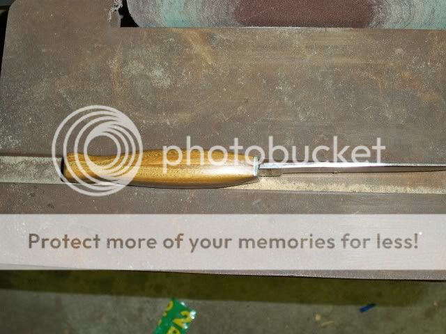

I made some scales from Lignum vitae for an old Robeson fixed blade Navy knife. I really enjoyed the green colored sawdust. It had an odd smell, but kind of aromatic. The grain is wonderful to look at. A buddy of mine, who I showed my rehandle job looked at me and said, "you know that knife is a cheapy, mass produced one right?" I said, yeah I know, it was my first rehandle.
If you look at the wheel of my sander, you will see the sawdust. I picked up that vintage Craftsman sander for 20 dollars at a garage sale. I spent more than double that on belts, LOL. The wood is very easy to work with and very dense grained. I burned a pin by heating it up too much and left it a bit proud, and also the blade sits a little too high in the scales, but hey, I was happy of the results, and a big fan of Lignum Vitae.
cj65 damn good job, we do'nt see much of this material used. may i ask if you needed a sealer or were the natural oils enough. excellent pics along with a very attractive wood.thanks for posting.

Thank you sir! I heard it was important to seal and have a sealer that would penetrate. I bought at the Pasadena CA Knife show 2 yrs back some product called:Starbond. It is a cyanoacrylate adhesive, which I heard is a steroid induced super glue. It is supposed to penetrate and stabilize wood with many coats. I seemed to have failed in getting it to penetrate. I had a spot that ran, so I sanded it down, and now have more of a satin finish, but it still looks good. Thank you for again for your compliments. The jury may be out as to exactly this type of wood that I used, hopefully one more knowledgeable can enlighten us.
I have only worked with bulnesia and never the real lignum vitae (though I have seen a block of it). Your experience sounds a lot like mine. The wood is very waxy, not oily like a rosewood. It produces a green, aromatic dust that sticks to stuff but not too badly (easily clean your belts off with rubber). It polishes to a high gloss without a finishing agent but does not glue well.
I found the most interesting characteristic was its striking color change after cutting. Leaving the handle in the sun for only an hour turns the wood from a golden color to a dark green. It even exudes a waxy green substance that can be buffed out. I finished it with a coat of oil, but I'm not sure it needed it.
That sounds just about right-I bet what I have is Bulnesia. Waxy is a good way to describe it. It does finish very easily, as you said. Thank you!

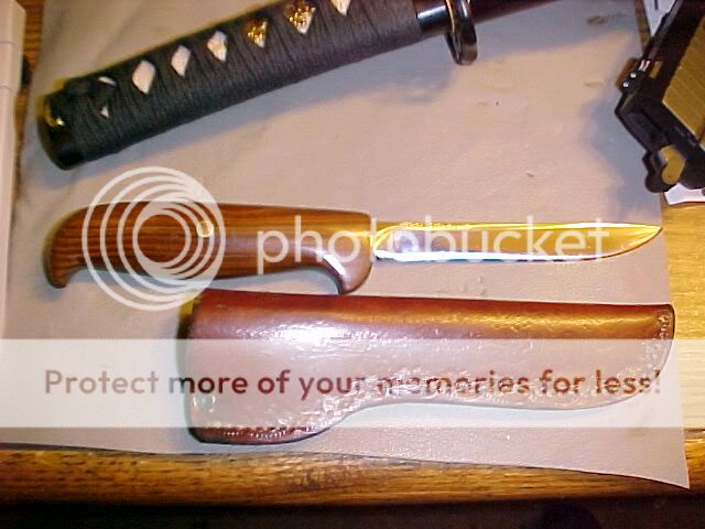

Here's a (crappy) pic of a knife (with Lignum Vitae handle) I made from a planer blade many moons ago:
