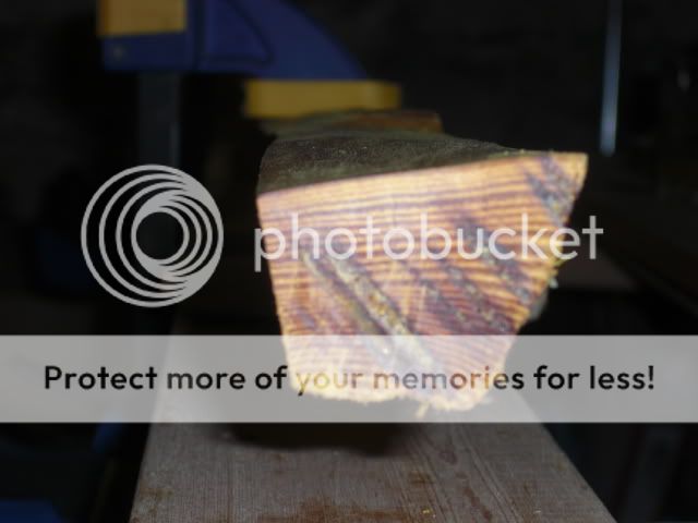

Osage is really dense and waxy. Here is a picture of the end of a bow stave I was working on. For reference, it's about 1 3/8" wide.
It is not, however, impervious to insects. I have another stave that isn't finished yet that is completely shot through with worm holes. :mad:
