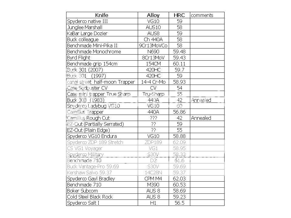

Here are some. I think I made this jpg for a thread. I know I've posted it before.
NOTE: In the comments section for the two stockman knives, you will see the word "annealed". In order to bend the blades into position on a knife with more blades than springs, such as a two spring stockman, the tang of each blade has to be annealed. Otherwise the blade would break in bending it. The bending process being called, "crinking". On a stockman, the only place to measure a blade is on the tang because that is the only place the top and bottom of the steel are parallel to one another. So the only measurement you can get on a two spring stockman is that of the annealed tang, which of course, is quite a bit softer than the rest of the blade. You really don't know how hard the edge is on a stockman.
2nd NOTE: IIRC I have since heard that the Gerber EZ-Outs have 420HC blades.
