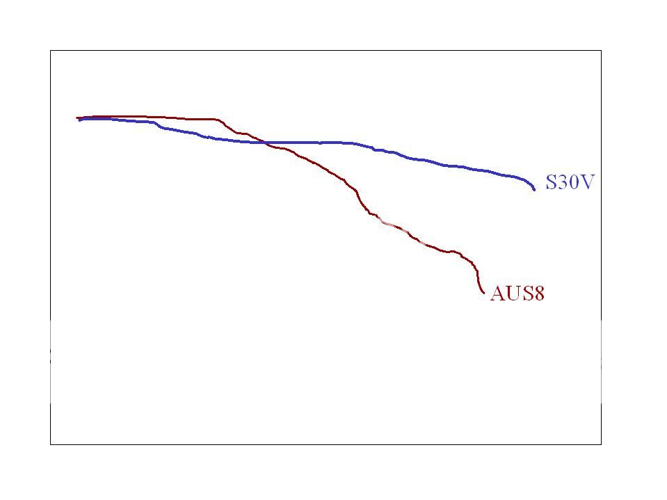

I agree with Knifenut. At least for me, High Carbide alloys don't really take a highly polished edge very well and when (if) they do, they won't hold it all that long. But they will take a lesser edge very well and will hold that edge a very long time.
Sort of like this freehand drawing:
That's very interesting. Why then are they considered by some to be a super steel?
To me hardness and wear resistance are not to be thought of as a combined force but as two factors. Hardness I see as more resistant to impact while I view wear resistance as how difficult it is to grind away. A increase in hardness will bring more wear resistance but its not the same as adding large amounts of hard carbides to increase what I guess you could call its "standing" wear resistance.
They are considered to be super steels because even though the edge will not shave no more it still retains a V shape better and when it wears it becomes toothy. Its what most would call a working edge.

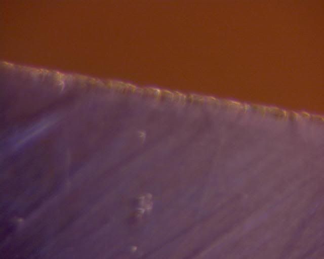

Here is a pic of S90V after some intense cutting, this edge would not even grab hair but would still slice paper and tomatos, cut rope.....
Note this edge has a microbevel so small it can not be seen by the naked eye, this knife cut drywall, cardboary, and many other items.
In some of the less damages sections you can see a balling of the metal. This is what typical wear looks like and the toothy/rough feel you get on your fingers.
This pic is AUS-8 at a high hardness after cutting manila rope. This shows better the balling effect. (little fuzzy :()

Here is S90V after cutting a lot of rope, you can see the working edge forming here. This edge is still extremely sharp, will still slice newsprint easy.
Blown up here.
