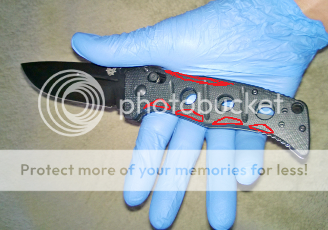

I know it is a bit of work, but Adamas has very thick G10 that can be grinded.
Until recently, I was shying away from Adamas, because it is rather heavy side. I personally like minimum weight in my 3.5"+ folding blade.
I start smoothing out my 810, and it had occurred to me that if Adamas 275 sheds a little bit og G-10 and round the grip a bit, it would feel like narrower handle.
Original grip:
Round off and grind G10 on red oval area, it would narrow the garth of handle. Just to be ambidextrous, I should do both side.
Thickness of G-10:
As you can see, the thickness of G10 is more than 8th of an inch. Make sure not to grind around clip area (easy on pinky and ring finger area), it should work nicely.

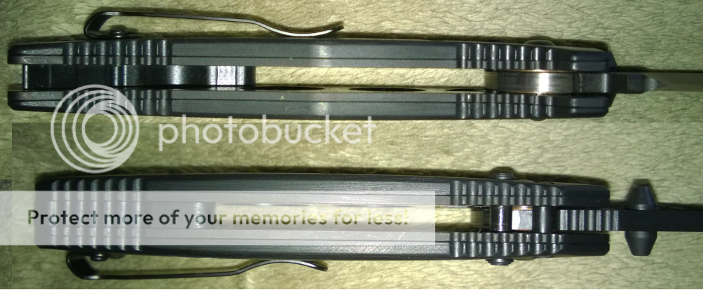

Just for comparecent, here is Adamas with Contego.
810 has longer blade, and blade thickness is comparable. So, liner is very close in thickness.
Blade thickness:
810 = .156" / 3.96mm
275 = .160" / 4.06mm
Handle thickness:
810 = .55 / 13.91mm
275 = .73 / 18.54mm
950 = .56 / 14.28mm
So, each G10 handle plates can be ground about 4mm without feeling too thin. I think sanding down would not be too bad.
