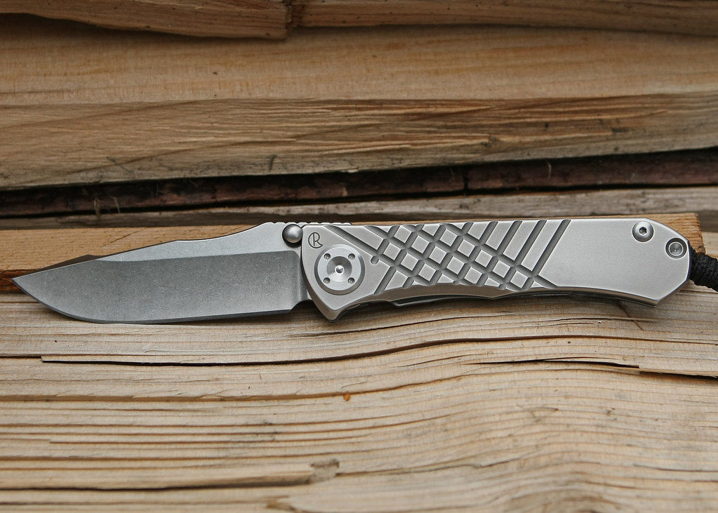

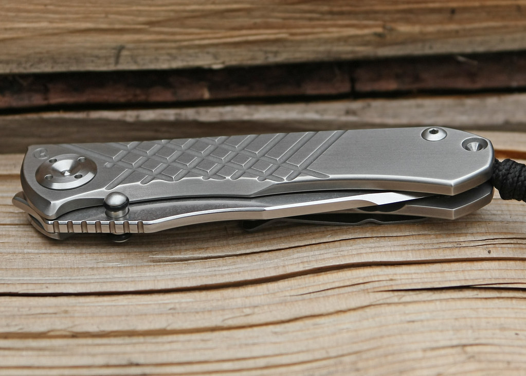

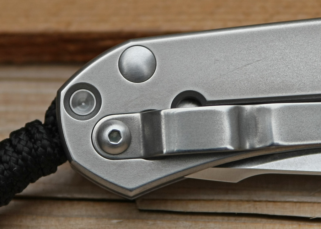

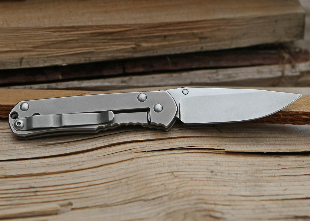

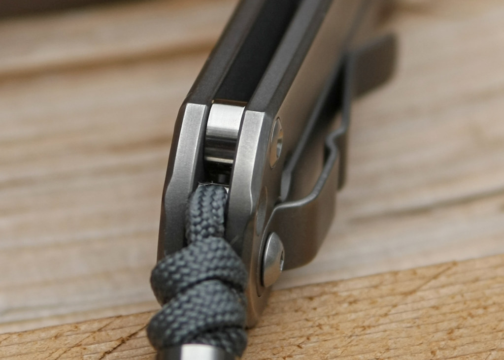

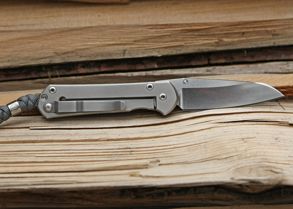

Recently I have seen bead blasted hardware and thought it looked pretty good. Since I like to sand and scotchbright my slabs I decided to try my hand at satin finishing my hardware, to give it a more toned down look and, therefore, better contrast with the slabs. I used green scotchbright and hand rubbed each piece of hardware in a circular motion till I reached my desired result.
What do you guys think?

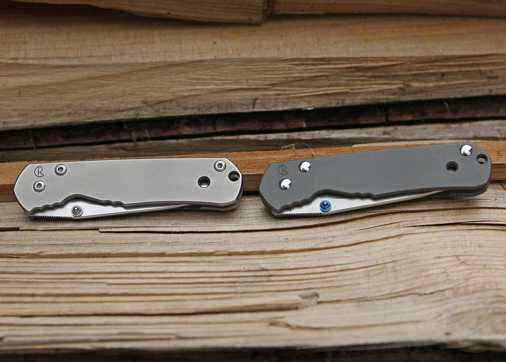

Small Regulars, for comparison, the one on the left has the satin hardware, scotchbright treatment and I polished the thumbstud and backspacer.

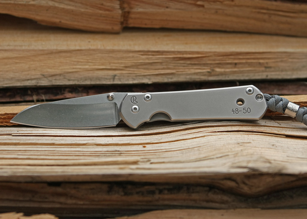

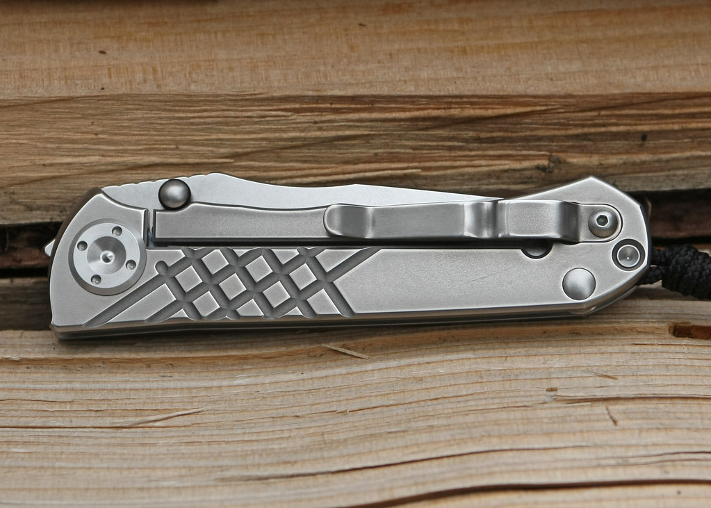

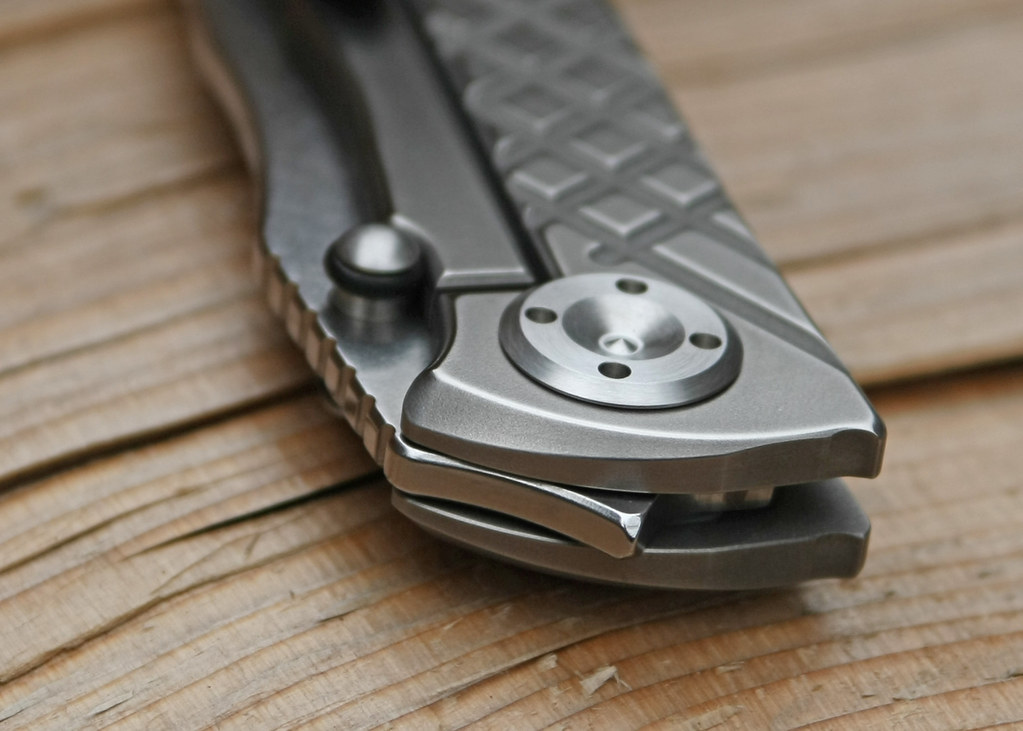

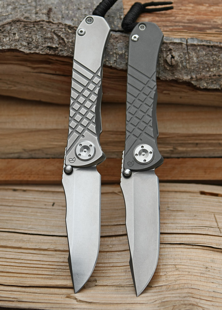

Small Insingo with same treatment:

I think that would work great, and be a lot less work. The thing I like about the uneven pattern I have created here is that it is just that, an uneven pattern, which really hides those random daily use scratches.

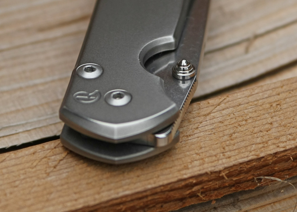

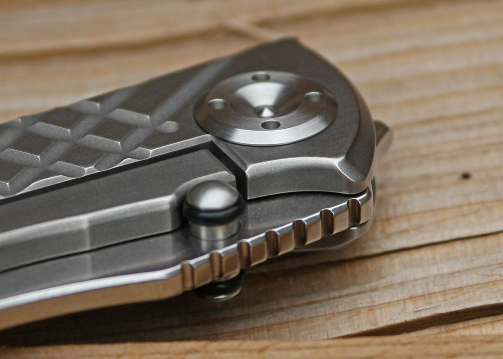

Those look Great!!! What did you polish the blue backspacer and blue thumbstud with? I was just thinking of taking the polish off those two items and the lanyard tube. Good Pics too!!!
Hey thanks guys!
TacBlade,
I polished the backspacers and studs with Flitz polish. A tiny amount on a thin rag just twisting the blade back and forth while you pinch the stud with your thumb and index finger will take care of the thumbstud. Also, use your finger nails with the rag to get into the recesses. The backspacer is easier.

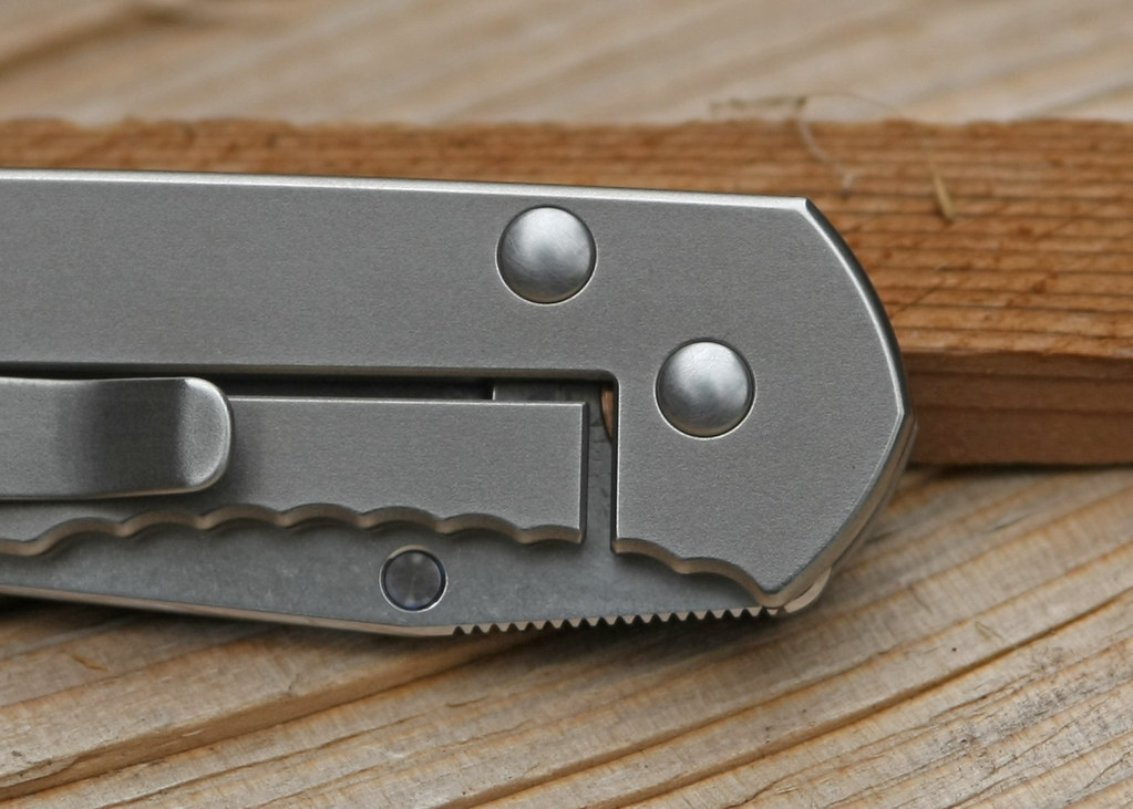

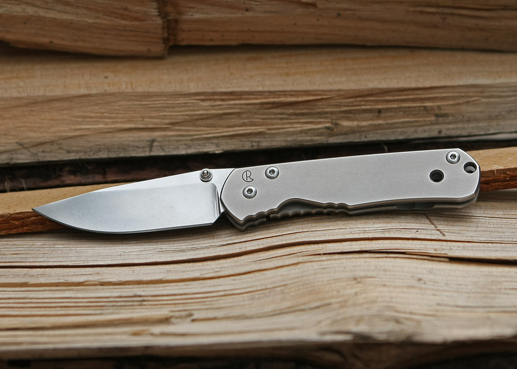

That looks awesome! I really like the idea of the satin finished screws because I really am irked by those pesky scratches on the mirror finished screws! Might have to try that out.
I am seriously considering this, how long did it take to hand rub the screws? Did you use just the green scotchbrite?
NJerzy154,
Not long at all.
I used 3M green Scotchbright, pretty aggressive. I screwed the hardware together so that I could hold onto it more readily. I worked in a circle about the size of a fifty cent piece and used progressively lighter pressure so as to get the satin I wanted. If you just go hard your finish will be rougher than what you see in my pictures.
Also, if you do this to the thumbstud on the Umnumzaan tape the whole blade, including the edge, so you don't risk hitting it with the Scotchbright.

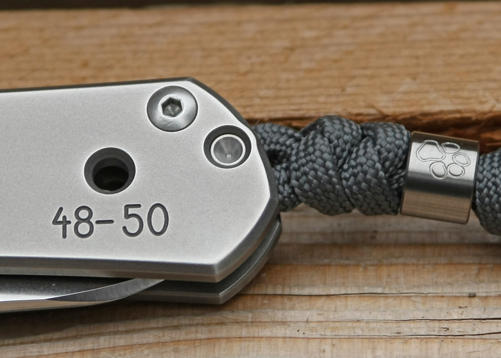

Peppercorn: Thanks for the heads-up (your PM about this thread)! That's my old buddy, Insingo #48-50 that I sold to you! It looks awesome with the scotchbrite finish! It's such a coincidence because just today I was looking at replacing the one I sold to you with an un-numbered Insingo. I really miss that beautiful blade shape! You have done a great job on this knife. I hope you are enjoying it!
