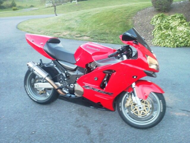

My weapon of choice for a couple of years... I've since slowed down a hair...
ZX-12R w/ Muzzy stroked and poked 1375cc setup, Muzzy Ti 4-1 custom shorty can, Dynojet FR3 Race PP, etc etc etc...
