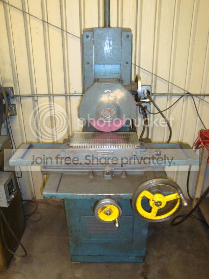

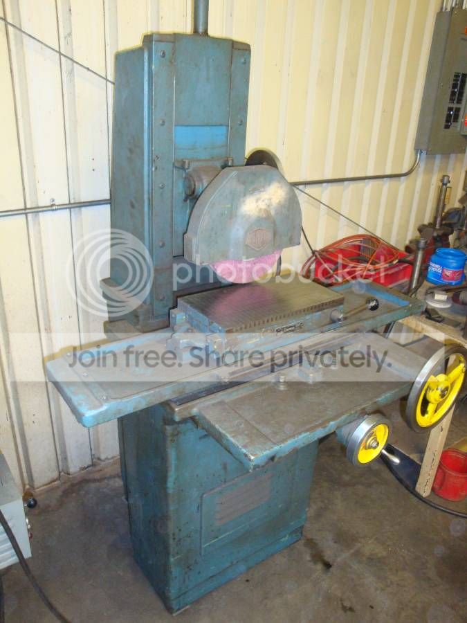

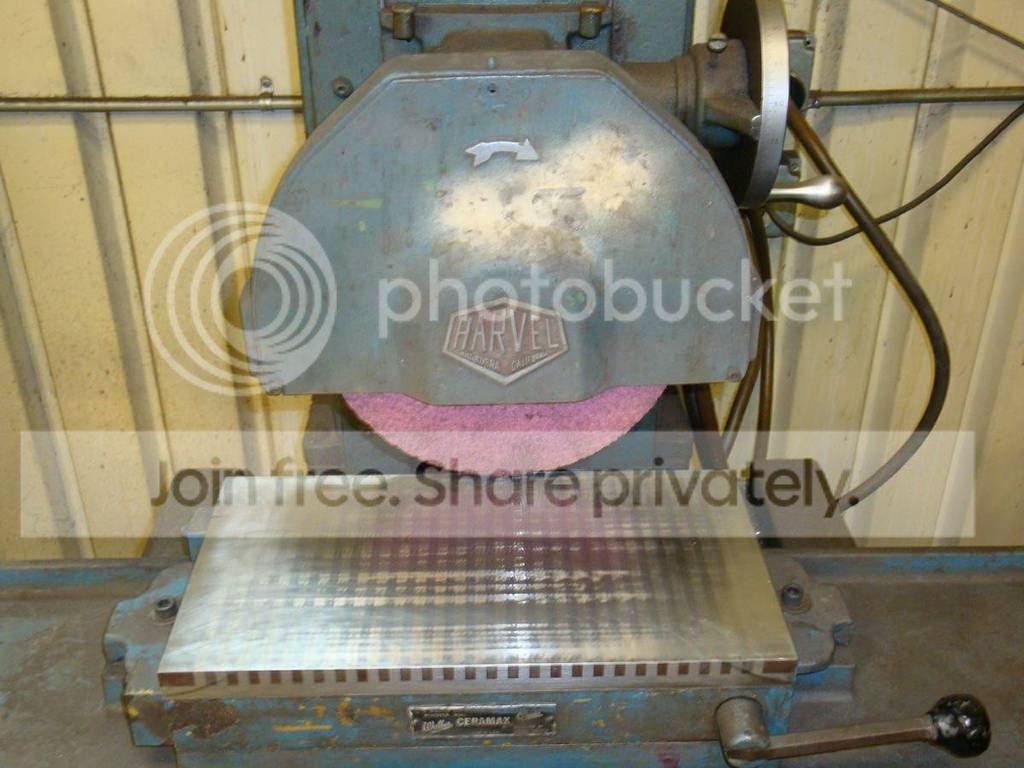

I know a guy who has a Harvel Surface grinder for sale for $700. Anyone here know anything about these machines? I think it's a manual machine. Here are some pics of it:

There ain't a whole lot that can go wrong with them. Especially for knife making. If it works and the table shuttles freely I would buy it.
You'll either have to use a phase converter or VFD for that one unless you have three phase in the shop, or change out the motor.
That's about what I paid for mine. You could check spindle runout with an indicator if you're unsure about it.
There's probably a long line of guys that would jump all over your Wertz SGA if you decide to sell it. Another thing you might check is if it has the original motor. If it does, that's a good thing.
If you get it, look into buying the wheel Don Hanson is running, I bought one on his recommendation and it works great!
That's somewhat true, but unfortunately the one or two things that CAN go wrong with them can really turn the machine into more of a headache than it is worth.
Check the spindle for runout and make sure the bearings are still in good shape. If the table runs on ways, make sure there's no excessive wear. If the guy can surface a piece or two, even better.
Grinding a plate for a function test is fine, but unless he's going to grind 5 blocks or set up the test plate on 3 points to check for flat, it's just a function test.
JG if you do grind a test plate, make sure you dress the wheel first so you don't think the choppy finish you'll get from an undressed wheel is a problem with the machine.
Examine the ways and make sure they aren't worn to hell or allow for play, but otherwise I'd snag something like that in a heartbeat.
