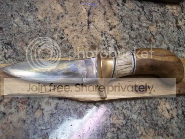

I never know whats inside till I cut it. Here is some Scrub Oak on a hunter in progress.
