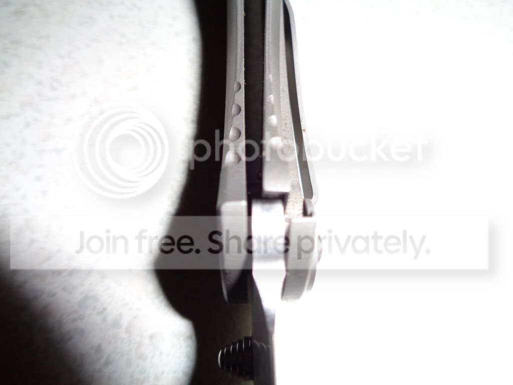

OP I've had a Subrosa for at least 3 years and my experience with it is much like yours. It's been opened many hundreds of times and I don't think the lock bar engagement has increased hardly at all. Here's a bad pic of it.
I do like having a hardened steel insert and have a few ti frame locks that do. But folders like the Subrosa and Slysz Bowie have shown me I'm lacking nothing without one. I've had no sticking issues with them at all either.
Maybe as they see a lot more use over time I may learn otherwise.
