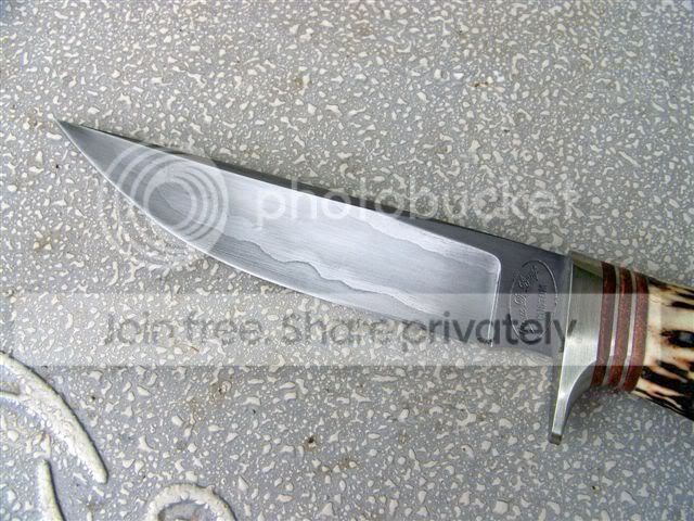

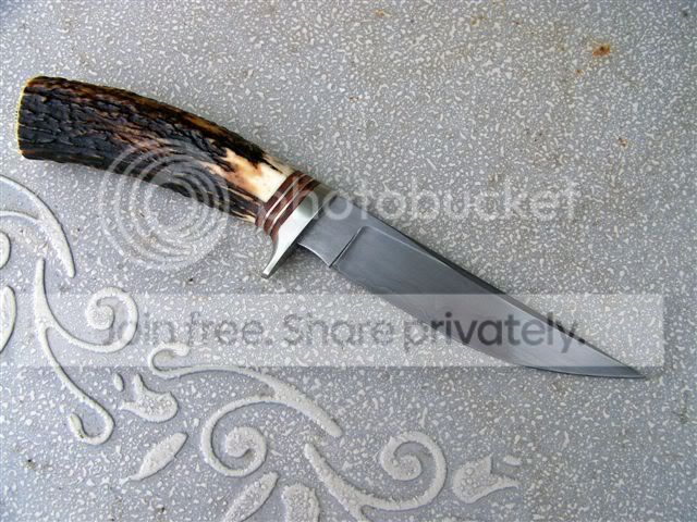

I made a hunter from a piece of the USS Parche submarine a few years ago. It was decommisioned and the crew each took home a piece of the hull. The piece my customer got had about 50% welds from an unknown (to me at least) stick welder. I ended up doing a san-mai with a thin center of 1084. Here it is:
