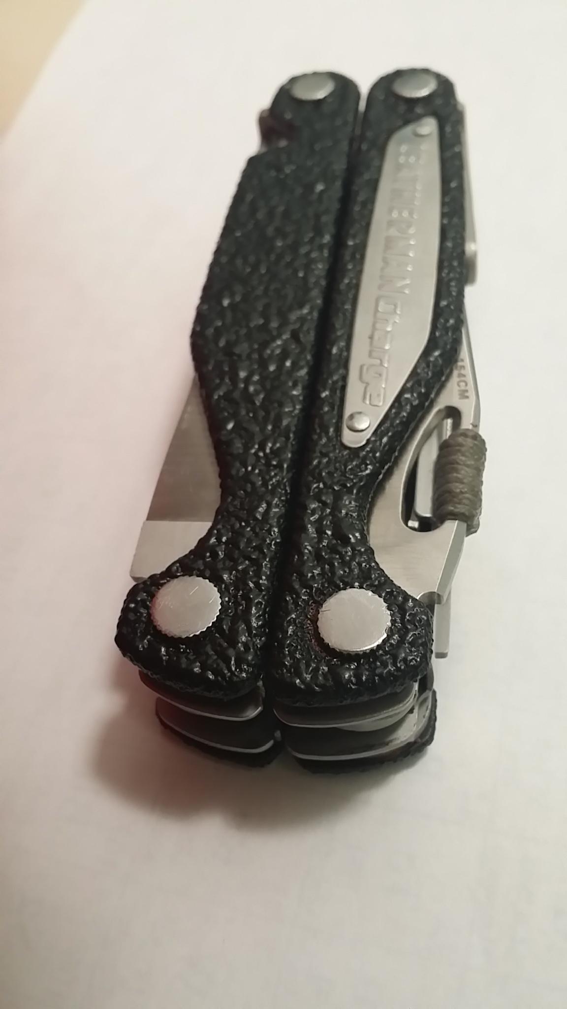

Has anyone had good luck with spray on truck bed liner material on the handles of their work knife? I was thinking it might add grip if applied to to the handle of something like a sodbuster pattern.
Anyone try it out before?
Too easy.
Raptor Liner.
Best product for DIY Spray.

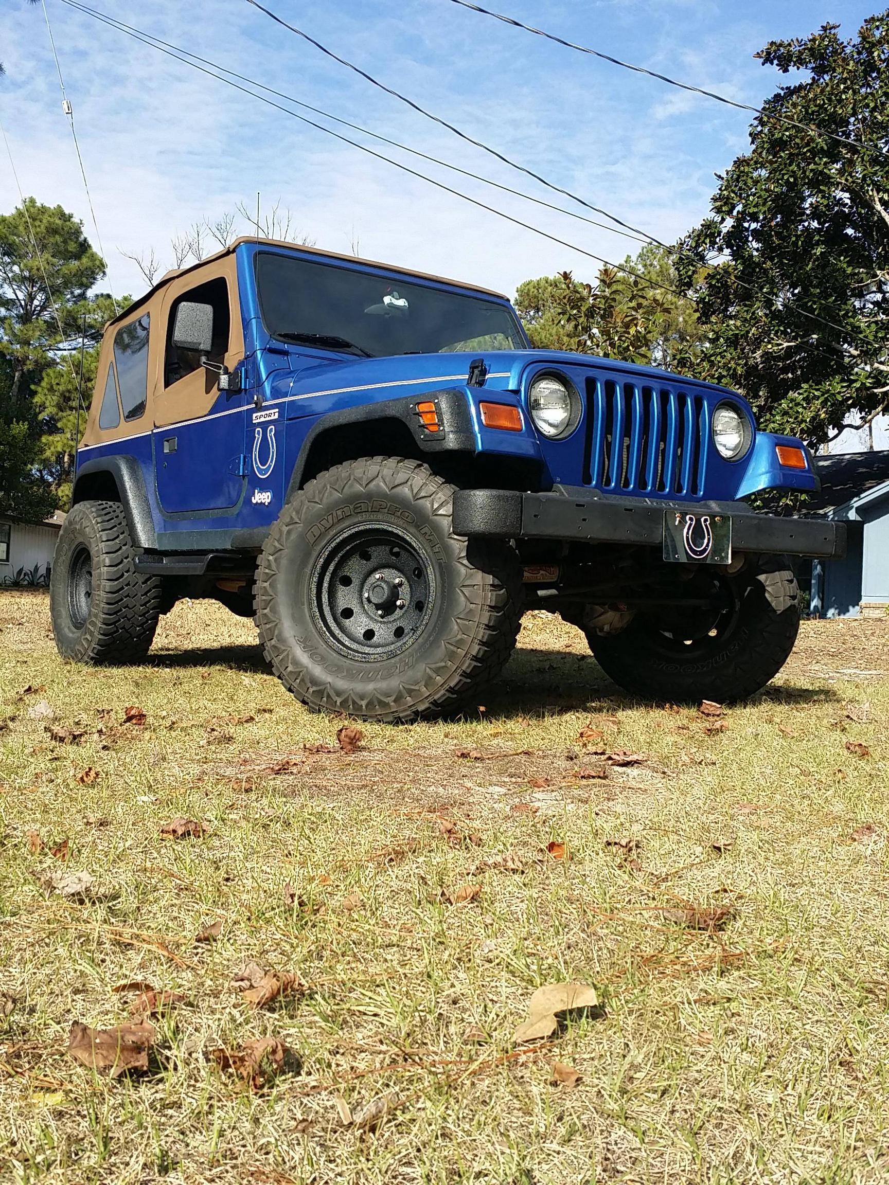

Done it on Jeeps, Rims, Bumpers, and eventually my truck.
We did a wooden hammer handle it's still holding up 100%
Comes in black, or a tint able kit.
It WILL DESTROY YOUR POCKETS. And for sake on earth DONT buy any roll on product. It ends up goopy smooth and flat.
I do plan on doing the bottom of my Nalgene Eventually. Here us a few pics of the best project I've done so far, bumper caps, rims, body and fenders were all done in 24 hrs.
That hard on pockets? Perhaps it will be good idea for a knife that I keep solely in the garage. Perhaps a fixed blade would be a better candidate. Thanks.
