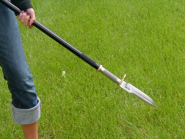

I beleive Randall made those screw on walking stafes/ spears
(looked them up, they use a knife as spear head)
