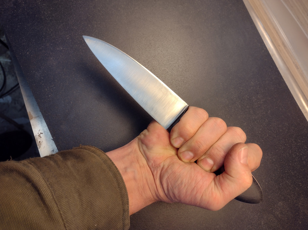

Has anyone reground a broken knife into a shorter blade/seen this done by someone?
Dec 7, 2019
3,682
Say you have a field knife with a 7” or 9” blade and it breaks roughly in half from batoning, chopping, tomfoolery, etc. You’re left with one piece of steel and a knife with 3.5” or 4.5” of blade left. I’d imagine you can still “repair” the knife and repurpose it from a big blade to a more compact belt knife. Just give it a new tip or at least grind away the jagged edges where it broke. But I don’t think I’ve seen that around here yet.
Has it been done? Is it a practical repair job?

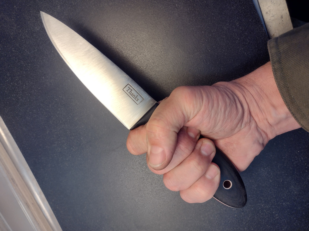

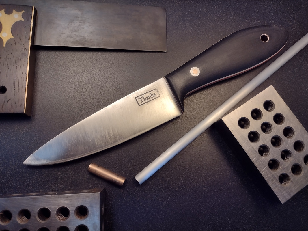

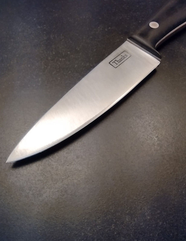

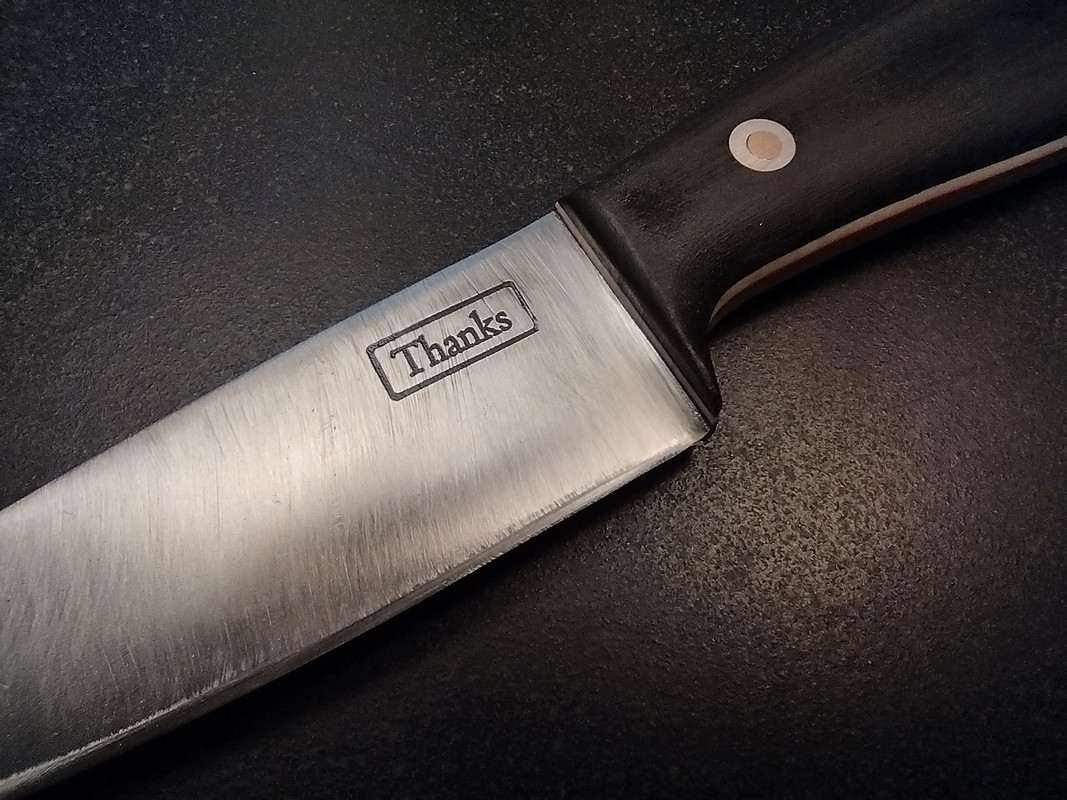

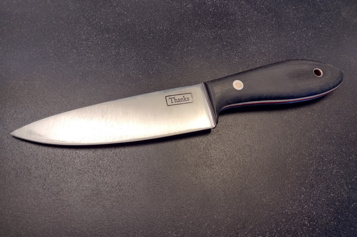

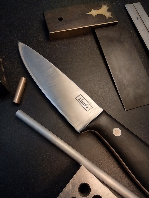

Yes, I've reground blades that I test, and have broke during testing......
My current Pass A Round knife is one of them. Not broke in half..... But I had to grind out chunks. First time using/making anything with Cruwear.
Post in thread 'Cruwear Pass A Round ......THANKS!' https://www.bladeforums.com/threads/cruwear-pass-a-round-thanks.1935722/post-22021704
I Needed to see where the angles and thin edge would take me?
I'm known for grinding shallow, acute angles. This means the knife is too sharp.
It was clearly knife abuse.
After the damage from the link I posted above, I cleaned up the profile, and put a more durable working angle. Still very acute compared to most makers. I'm less than 15 degrees.
I think it turned out Nicely.
I've done this many times. When testing knives that I made myself, I broke a lot, especially in my novice days (from bad heat treatment) and often reshaped them instead of throwing them away. What you need to pay attention to is to maintain heat treatment when regrounding. That is, to ensure that the blade does not get too hot. As an amateur I can say this, I'm sure knife makers whose job it is here can tell you important tricks.

Thanks for the nice pictures. That’s a beautiful blade.
Yep.
In my early 20s had bayonet from the 1800s that snapped in half. Put point on part attached to handle still...about 8 inches of blade. Did a Wharncliffe point if I recall correctly. Don't still have it.
This thing started as a much longer blade, a full length saber:
Ground regular point on it, then went with Wharncliffe years later when I put better handle on it. With that one the blade snapped, AND the original handle fell apart!
Sometimes the broken reshaped blade actually works out.

Every beginner maker wants to make Swords and Bowies,and most of us try early on, but fixing mistakes is why most of us start/ finish up with small knives.
