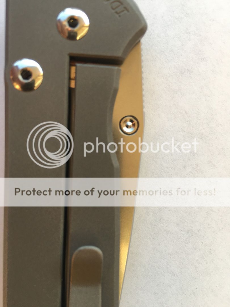

My late 2015 umnanzaan has this relief cut (dent)on one of the thumb stud.(circled in red on the picture)
According to CRK this is introduced to the umnanzaan to reduce stresses between the stud and the blade (I have not heard of a case of blade cracking due to the pressure build up between the stud and the blade) and it will be introduced to the Sebenzas as well.
I was wondering does anyone else noticed this on their umnanzaan and what their thoughts are on this. I find it a bit of an after thought and really ruined the perfect symmetry of the design.
That is horrible! Better send it to me for proper disposal :p
On a serious note, if CRK realizes that there is a problem and try to correct the problem through engineering a solution, then it is continued improvement..no?
To be sure, that is an area of stress if the blade was going to break. The solution moves the stress from the blade to the thumbstud by allowing the thumbstud to collapse a little.
Probably also reduces surface area so that they can install the studs easier.
This has been a problem in the distant past with Sebenzas. Have not seen or heard of it recently..but that doesn't mean it doesn't happen either.

I'm starting to have a bad feeling about this... Is it possible it's Some kinda of blemishes? and someone at CRK is giving me the run around so I don't go and return it... 😂
I think it is what they said it is. A small improvement, but I can see how it would bother you.
Sidenote: Makes sense that they plan to also introduce this on the sebenzas. The thumbstud is press fit and blades have cracked. This is exactly why they won't touch the thumbstuds on BG42 blades anymore. They run the risk of cracking a blade they no longer can replace with the same steel.

I really hope they don't apply it to the sebenza thumbstud, it's not a pretty sight(can you imagine a little dent on those blue finishes 😯)
I have no doubt it's what they said it is... Just curious why no one had noticed these changes on their new CRKs...

You wouldn't see it on a Sebenza as the thumbstud has a shoulder on it that sits flush with the blade.

Let me take a closer look at my Sebenza 25(which is also marked D15). But I just don't see how they can do that to the thumbstud without leaving a mark(no matter how small it might be)
Is the stjd the same length on the other side?. Maybe not pressed in all the way. Take a pic square on perhaps.
