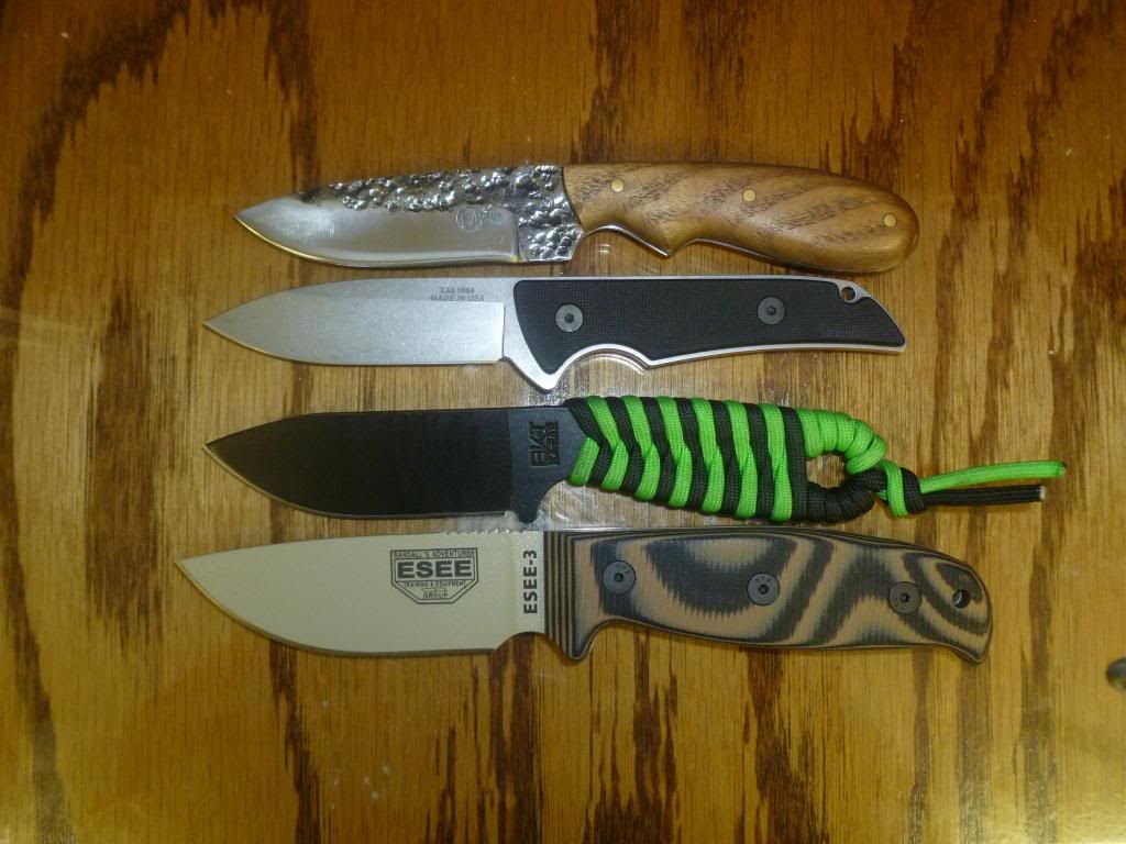

I dont have any current pics but here is one I took a while back of my ESEE 3 with scales from TKC. I prefer them over the stock scales. They are more ergonomic and with the 3 it extends the grip slightly. I have used my 3 a few times cleaning fish and the G10 while not the most textured I had no issues with them.

What are the top two knives in your pic?
