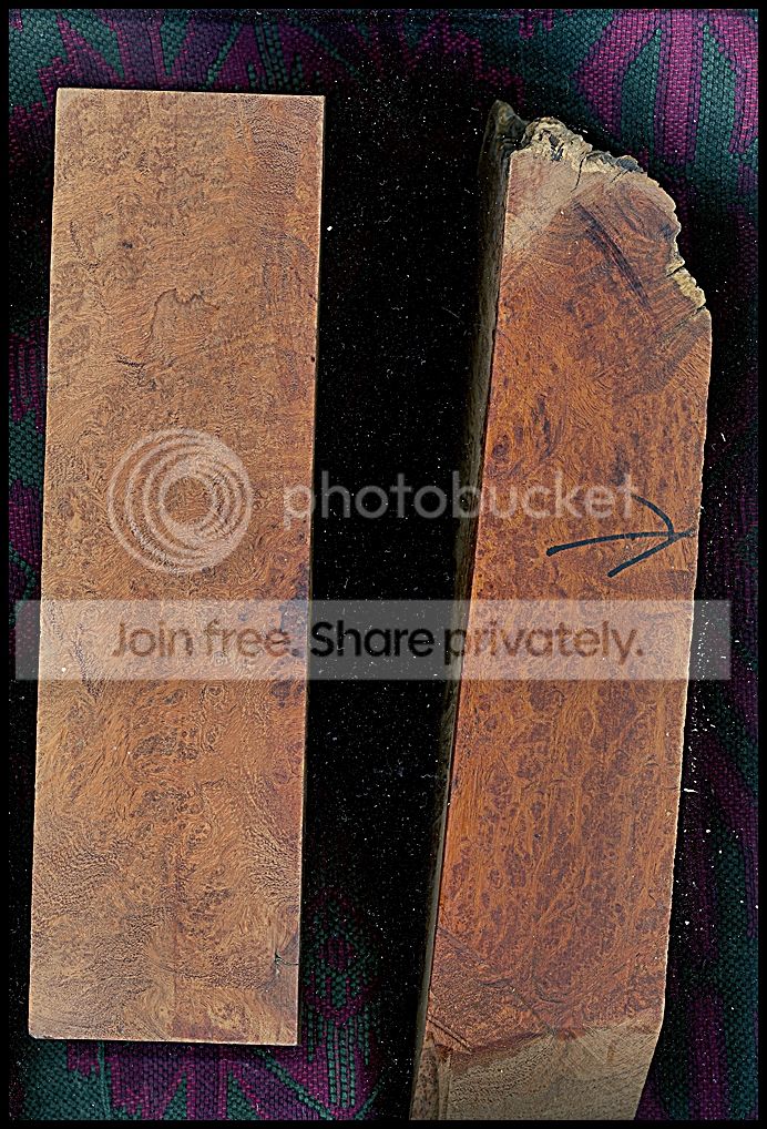

I have not seen the wood in person yet but my customer sent me a scan of a couple small pieces he got from the guy with the wood.
To me the texture looks a lot like Mesquite. I am guessing that it is a fairly dense wood from the areas where it grows.

Mark - I have a small hand turned bowl of Arizona Walnut. I purchased it in Scotsdale years ago.
My bowl is not burl, but it has a similar color to your scanned photo. In hand it is heavy, dense and has a beautiful color. slightly lighter than American Walnut. Beautiful wood.

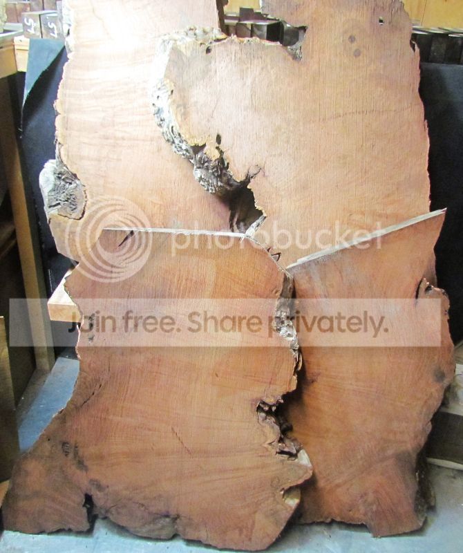

When I lifted the slabs they felt about twice as heavy as I expected. Cutting was harder than any walnut I have ever cut.
When sanded the color is similar to amber colored Koa. I have never seen Walnut this color before.
I am cutting and sanding some blocks now. Looks like it will be some pretty wood.
The lines you see going across the slabs is curly figure. There are also some small areas with some burl.
This photo shows the wood with a rough surface and a layer of dust.
This is not orchard or grafted walnut but a wild grown tree.
I think it is best to get it stabilized because of the coarse grain structure.
Too nice of wood to cut any corners in my opinion.
