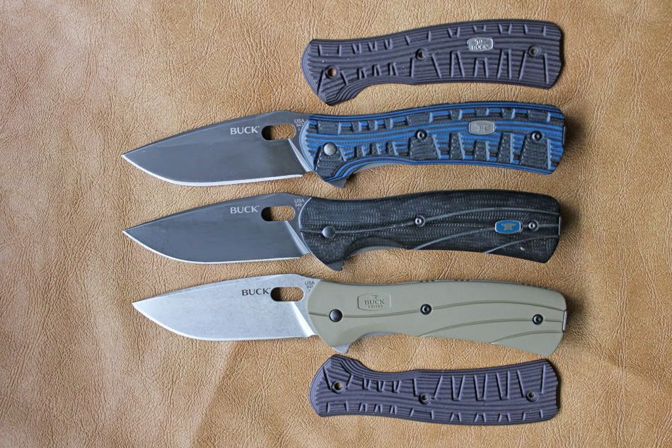

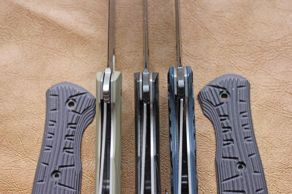

I'm not sure of the definition of late lock up. Here's a couple of pictures of my three to show how they lock up. Left to right they are the Select, Avid and Pro and all carry the 2011 date mark.

plumberdv, do the two models on the right have a radiused blade tang where the lock engages? It looks flat in the pictures.

That black/light blue handle in knife #2 is outstanding looking:thumbup:
yeah, the 847 Pro with g-10 in blue and black is a great looking knife. I like scale change on the 846 Dave, though the original scales dont seem to be as agressive as you describe them. Did you take them to the buffer?
yeah, the 847 Pro with g-10 in blue and black is a great looking knife. I like scale change on the 846 Dave, though the original scales dont seem to be as agressive as you describe them. Did you take them to the buffer?[/QUOTE]
No buffer. The edges on the grooves are sharper than they appear, you'd need to feel them to know. In the old days when my hands were used to twisting pipes and digging ditches, they would have probably been ok.
