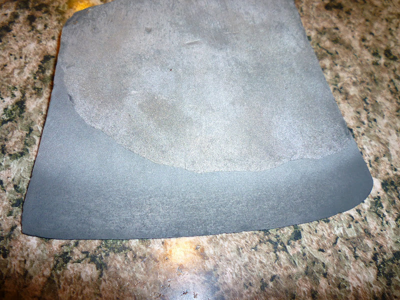

Have a question on a recent hatchet I picked up...
I don't know much when it comes to the hardening or quenching process on axes. I picked up a little hatchet recently - unknown brand but seemed good. I cleaned it up and started sharpening it. As I was filing (there were some nice nicks in the edge), I noticed that of all the axes I've done up until now, this is by far the hardest edge I have ever worked on. I spent hours on this little guy and I have still have some spots that need to be worked out. I'm not worried about that but it did get me a bit curious.
Here it is after a clean up and sharpening...besides the filing, the sharpening process (sandpaper, convex) wasn't too bad at all.
Usually after a dunk in some vinegar, the edge turns black revealing the portion of hardened metal. I understand that much. However, after submerging this one for just a couple of hours, I got this. This after a quick water rinse and scrubbing.
In my experience, some less quality axes didn't have such a nice, distinct hamon line - the metal ended up being too soft as well. It seems as if this one was hardened properly and then double hardened? After sharpening, it took a really, really nice edge. Slices paper and arm hair with ease. I would doubt it, but would sharpening it up before a vinegar bath (while somewhat pointless :o) cause that look?
I haven't been able to find an answer quite yet (I've come up with the terms "differentially hardened" and "double tempered" but I don't know if those would be correct), so any information you guys have would be appreciated!
I'm going for a central insert of harder steel. See how the etch line curves at top & bottom, this is typical of an insert. We need to see top & bottom pics.
Except that the hatchet was made in the 1970s. I don't see this as an insert. This looks like a hardening line to me.
Are you referring to the OP's hatchet? Sure seems that the concensus is that hatchet is of monosteel construction.
Sorry. No, I was talking about the Mustad.
We need to see a top view of the OP's hatchet to make a determination. It's easy to see that Matt's Mustad is an insert.
