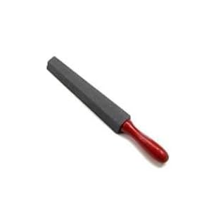

At times like these, I use this kind of coarse stone, it's 14" with the handle,
and you can bear down on it and get a good stroke:
Norton 87750
Metal must be too hard to file then. That describes it pretty well in teh above thread. A course diamond pocket hone that I have is removing more metal than the file. Guess I'll have at it with that. Thanks for the help everyone!
