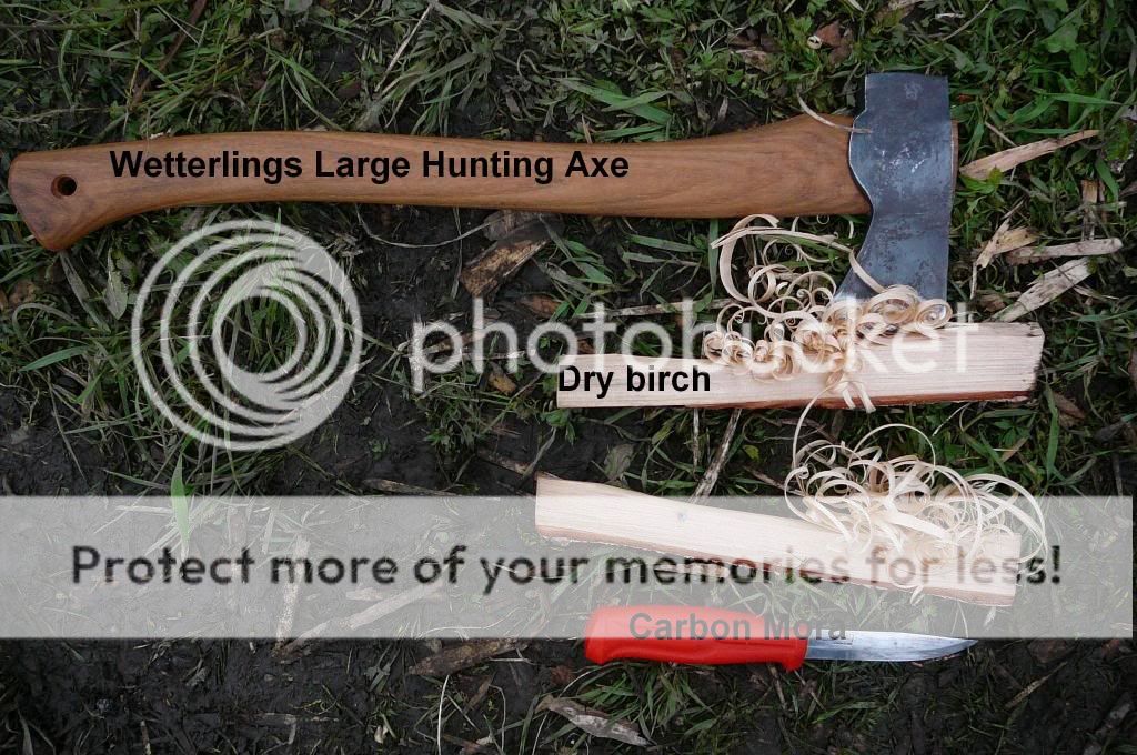

I can chop down and process a tree quite a bit faster with a 19" Wetterlings than I can with the 10" blade Ontario RTAK II and both weigh ~ 2 lbs. Using the large blade would use MORE energy in my case.
For me, it's also much more of a pain in the ass to sharpen a 10 inch blade than it is to sharpen an axe. The only advantage the large chopping knife has (FOR ME & IMO) is precise batoning for splitting wood. The axe wins everything else in my book. I have yet to encounter a situation my axe and 4'' belt knife cannot tackle.

okay i see your point but what about making fuzz sticks with a hatchet i dont know if that would be harder than a 10" blade like an rtak II.. also say for backpacking 19"s of anything fixed would be troublesome to either attach or pack inside a pack. but i do acknowledge your point with a 4" blade pocket knife and larger hatchet combo.

As for the feather sticks:
