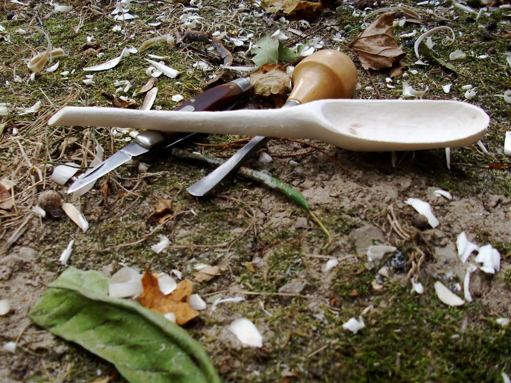

It looks like an interesting and function-oriented design. Question: Would a different grind on the tip provide more durability for spoon-making purposes? Maybe a chisel grind with a bit of a secondary edge?

Yeah in my post I did say the grind could be Scandi or Chisel. I really just posted to get thoughts on the rounded tip theory, I drew the rest of the knife on as an afterthought.

I like the concept Pit, but I think without a gouge shaped tip your wood carving efforts might be a bit difficult. A shape like this gouge would be more useful, but then might take away it's other abilities.
