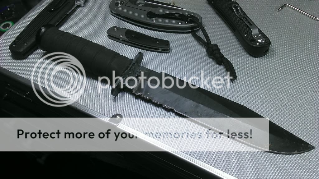

Seriously though, I've only had one knife break by accident, as in I wasn't trying to push the limits with it. It was a kabar fighter - snapped right at the guard when I hit the back of the blade on a wood packing crate. It wasn't even a hard hit as it barely dented the wood. Must've just been a fluke. :confused:

An older pic of my broken kabar fighter; reborn by welding the guard, chunk of blade that snapped and handle back together to one solid piece:
It's held up to a lot of use and abuse since the "fix"...
