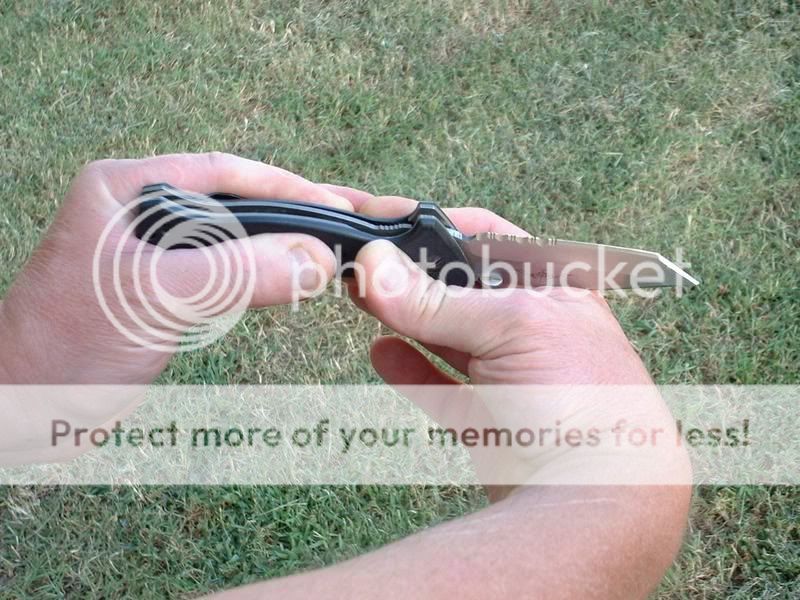

The blade still locks up solid without any play. If I use it hard it tends to move to 80% lockup operating much like my CRK framelock. I test my liner knives like STR states in an old thread regularly. By holding the knife in both hands (ie one hand holds the blade and other one the handle). Keeping your fingers out of the way apply force to the spine. If the liner slips under pressure it is becoming a danger to operate.
Found the picture!
