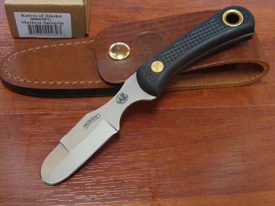

Have you guys ever sharpened one of these?
DeadboxHero
Mar 22, 2014
5,539
Knives of Alaska "muskrat"

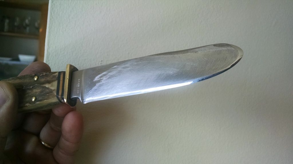

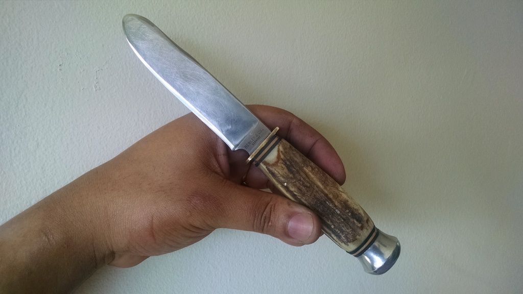

Had a friend find out I could I could sharpen knives.
I admit, I was puzzled at first.
I would flip to each side and sharpen a half cirlce.
But it was starting to form a point, d'oh!
Then I had an epiphany
Just raise and rotate the handle to follow the curvature.
He had given me an old clip point knife he had attempted to modify himself
I was able to finish his work on the waterstones with a mirror polish and a hair popping edge.
Haha what a pain to sharpen.
Anyone else have any experiences with ye 'ole Muskrat design?
I've never seen a blade shaped like that... Is it for digging? Or like a quasi oyster/shellfish knife?
I could see that.
Nah it's for skining.
It makes it easy mode when your pulling the hide off the animal.
All you have to do is move the blade up and down and the fully sharpens nose will never piece the hide and get the job down fast.
They would be more popular if they weren't so puzzling for hunters to sharpen
Ahhh, I see. Yeah that one would be a tough one... I have a hard enough time getting my tips sharpened correctly as it is.

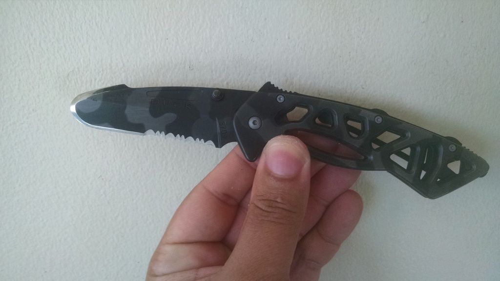

A hunting buddy had me modify his buck Tanto tip to a muskrat style Skinner.
Gotta love that 420hc from Buck.
Razor sharp.
