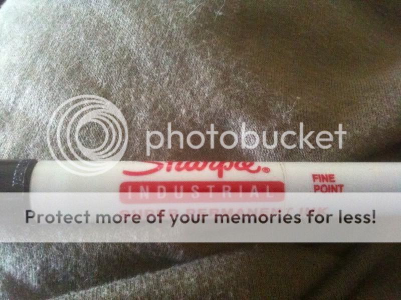

I haven't owned any lay out dye for years. I just use a black felt tip pen.
+1 Especially since they started ordering these at work;)
