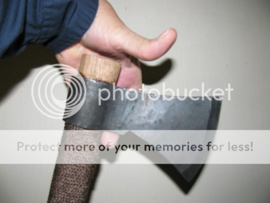

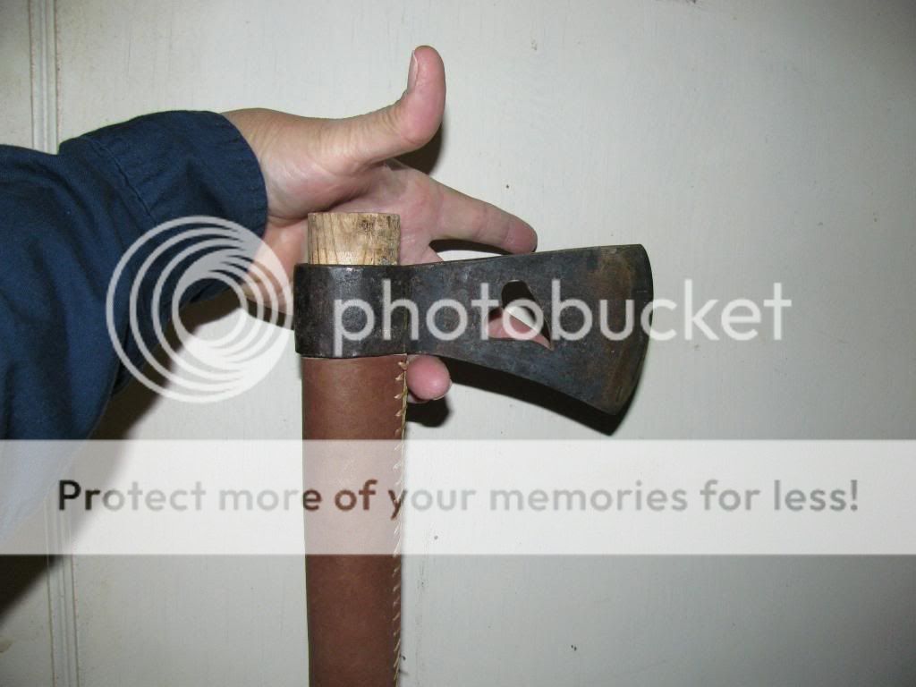

A lot like a throwing knife, balance is sort of what someone wants it to be and gets used to throwing. For me, if I hang it on my finger at the head in front of the haft, the weight of the head should roughly equal the weight of the haft so it just hangs there. Since it is what I am used to throwing, it is "well balanced" for me and prevents over or under rotation.
Everybody selling a throwing hawk says it is "well balanced." Here are three hawks we throw that are each differently balanced. I made the one with the bleeding heart and it throws the worst (it is head/handle neutral).
I prefer the head heavy hawk
while my wife loves to throw the Cold Steel axe which is haft heavy and so does my Grandson.
I think it is all what you get used to throwing. It says something about balance and stability that they sometimes throw the Cold Steel No-spin style. I have tried and can't do that at all with the head heavy ones. They want to rotate!
