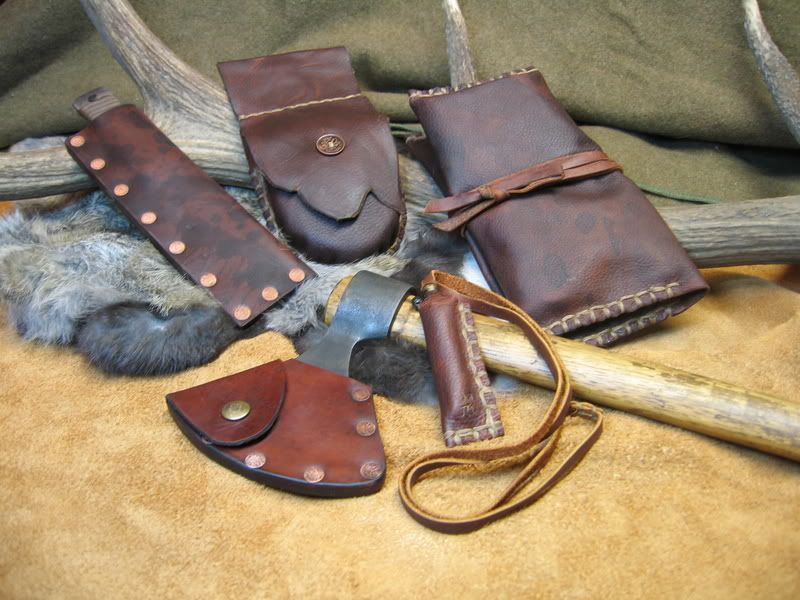

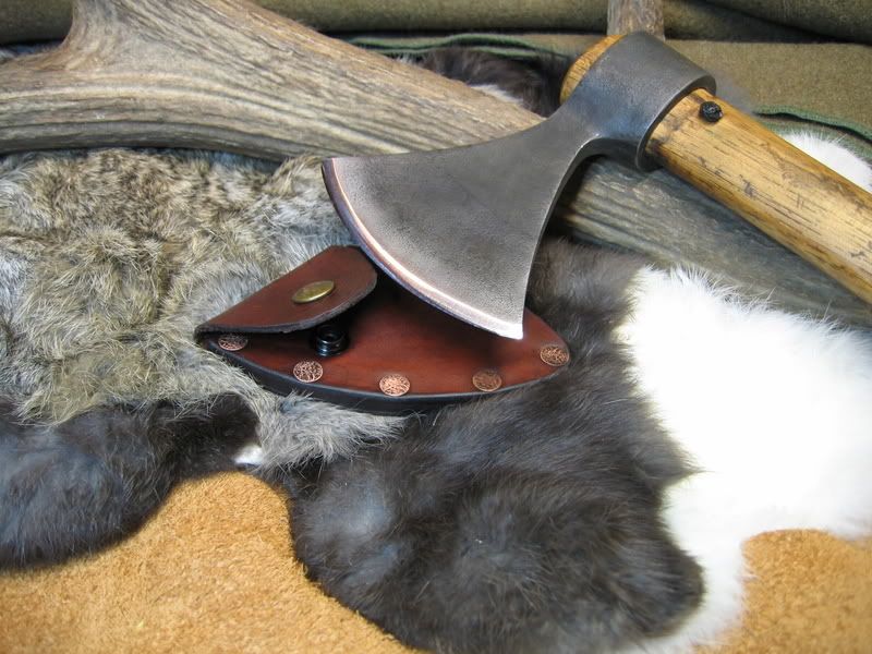

I tried out a CS Trail Hawk and liked it alot but the short cutting edge scared me a bit so I went to a Frontier Hawk and used it for about 3-4 yrs. Then I began training with a wilderness skills instructor and notice that he and his crew all had CS Norse Hawks. This was up in Northern Ontario, Canada... right in lumberjack territory... why no axes? I asked and they gave me the reason of quick handle replacement.... Why the Norse? I asked again and he went into a huge explanation of why they evolved toward the Norse shape....
As a chopper it had a long cutting edge that was very forgiving.... this long upswept edge also lends itself well to slashing at brush. The the down-drop of the edge was great for hooking limbs or reaching up to grab anchor points while climbing. The half moon shape also offers more sticking point for throwing. It is heavy enough for chopping (I've taken down 16" dia dead-standing poplar with it) and light enough to choke up and do woodcraft, comfortably. Then he told me it their preferred tool for skinning larger game animals.... ????.... he then popped it of the handle and held it like an Inuit Ulu knife. With the right edge geometry you can tackle all these tasks with ease.
I have been working with him for 2yrs now and have grown to depend on my hawk to the point where I hardly unsheathe my knife anymore.
Rick
Here is a family portrait including my hawk..... "Chuck Norse"
