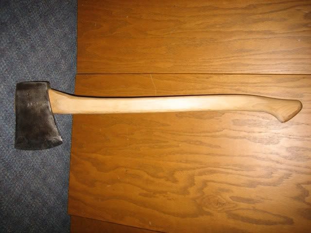

If I was using it for shelter, or anything where safety or serious discomfort was a possibility, I'd definitely take along a 'real' axe. It doesn't need to be huge, but a small increase in weight can have a HUGE effect on cutting ability. If one were to come to my house the day before going out hunting, and ask to borrow one of my axes, this is the one I'd hand you (Of course, that's a lie. If anyone asked to borrow one of my axes, I'd probably hand them my root axe and tell them they were lucky to get even that, then possibly push them down in the mud, and make fun of them for not having their own axe ;)...):
This axe has a 2 3/4 or 3 lb head. I have it hung to mimic a competition axe, so 23" from the bottom of the head to the hand swell, but would hang it a bit shorter for someone else, most likely. I *really* like this Jersey pattern. The reason I get such a large cutting edge for the low weight it the thin profile:
By the way, for anyone who cares, this is a Collins Legitimus head. Really nice steel. Paid $15:D

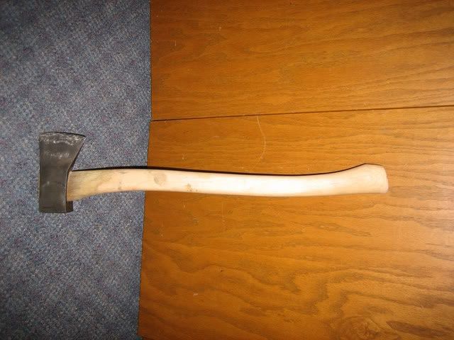

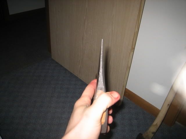

If, after getting up out of the mud, you said you were dedicated to carrying a hawk-type tool, I'd suggest one like this:
1 3/4 lb Snow and Nealley ANTIQUE (not! the new manufacture) two-piece hudson bay pattern, with a thin profile, on a longish handle. This particular handle is the "boys axe" style manufactured by Peavey. Most 'boys axe' handles are similar, about 20-24 inches long, and would work well for the application. A huge pile of metal at the poll makes it OK to hammer with for shelter making.
-My 1/50th of a highly opinionated dollar. Please feel free to ask questions or disagree. I like to hear other people's opinions on things like this. Especially when they say WHY the think that way...
